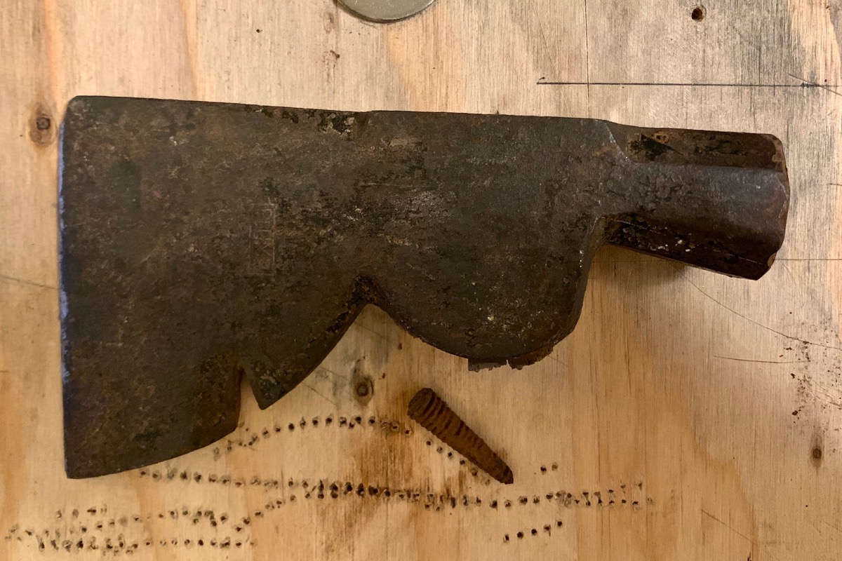

This one was less a matter of "it followed me home" and more a matter of "it was waiting for me when I got home". This past weekend while I was out with Washington Trails Association I mentioned to one of the other guys that I was looking for a carpenters' hatchet to restore as a gift for a friend who's into [modern] woodworking. He said that I thought he might have an old, rusty one that had come from his dad's basement a while back, and that if he could find it it was mine. Well it showed up in the mail today!

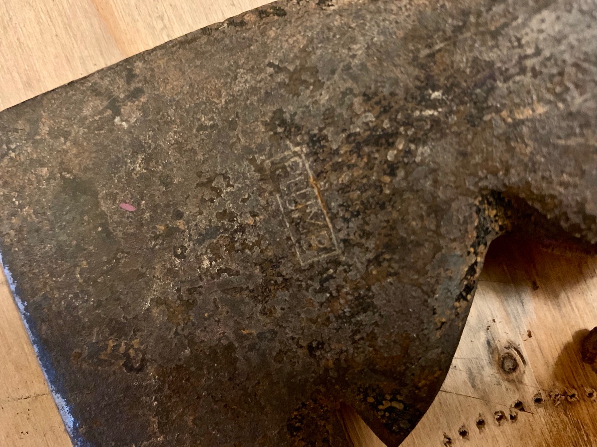

Plenty of rust and it will need a good grind, but that sure looks like a Plumb logo on there, which makes me pretty happy!

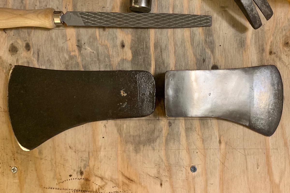

I had another axe show up in the mail today, this one from eBay, but also getting restored as a gift. The pictures on the auction didn't quite communicate the odd shape of this axe, but having it in hand does make it a look a little odd to me. Take a look.
The poll of this 3.5 pound, Collins axe head, is no larger than that of the Vaughn boys axe next to it, though the latter only weighs 2.25 pounds. Is this just a somewhat extreme Michigan, or is it something else that I'm not familiar with?
It's a late production Collins / Mann " Michigan " or at least morphed and abominated from the once great Michigan pattern.

Save that take-up wedge!
Hi AaronGP AaronGP
Sadly off the top of my head i cant tell you the years that take up screw was used nor on what or if all hatchets and or other edge tools, axes and such, but it was a limited run by Plumb.
Meant to help the user keep the hang tight and solid. Could be tightened and loosened to snug it up or removed to make the haft more easily workable to slide up, drop the head down rehanging and making all tight and solid again.
There may be many more details and fun facts that i am missing, but i think thats the skin of it.
:thumbsup:
Ok, I don’t know the significance of this piece. What’s so special about it?

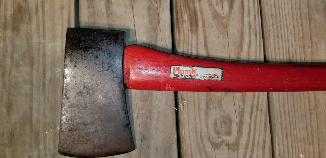

I saw Plumb so I grabbed. Don't think it is very old. But it was red and shiny!
Definitely not because it's Cooper era, but it looks like a decent tool.
I like the head shape, it certainly doesn't look like anything else from the late 70's+ with their heads that are distorted from what the patterns once were and their rough finish.
If I just saw the side profile of this head by itself I might think it was some kind of Maine head.

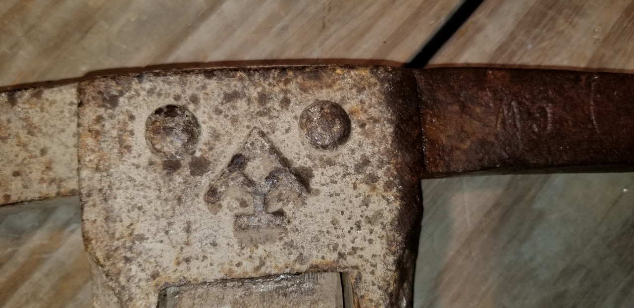

I need some help with this one. I have not seen anything like it. But I was pretty sure it was stinking old.
I can make out an A then T & S FRY. then there is a C.W. stamped upside down to the left of that.
Woodings-Verona
Can you maybe see A after CW ? Civil Works Administration
Atchison, Topeka and Santa Fe Railway
