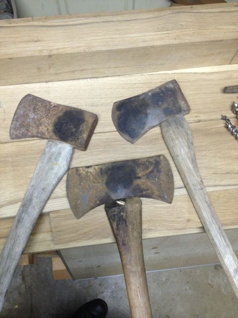

The haft may have to go. It loosely fits, and has a...quality wedge.
I would surely leave that haft alone. It's vintage.

Found these at an estate sale. $6 for the pair.
