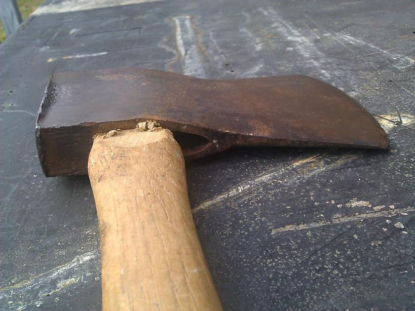

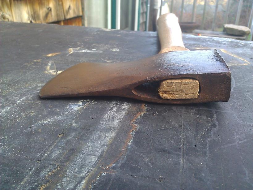

picked this up off the 'bay. So little info available online, but I gave the low bid and apparently there was no competition.
It's marked "GROVE Tool Works New York City" which has got to make it unusual. Can't imagine how long it's been since someone was making real tools in NYC. I'll put a file to the edge and see if it's a tool.
The cheeks are post-forging convexed and the poll is only slightly mushroomed. Someone went to a lot of trouble to get that hammer handle in there - I managed to wiggle it out by hand and now it's in the firewood pile.
The head weighs 1lb-14oz on the trigger pull gauge. It'll get a 20-28" haft of some kind.
That should do it for most axes for me. Except for the bearded one I'd like to have made when I'm flush, now I'm only interested in Connecticuts. If this can stop before I hit double-digits it will be a very good thing...

I like the fit. It suits the axe.

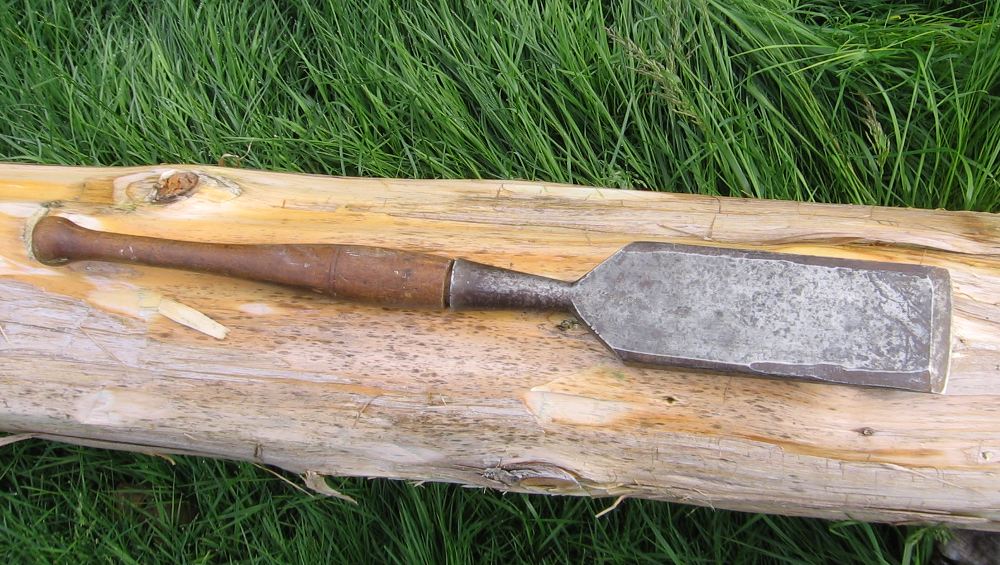

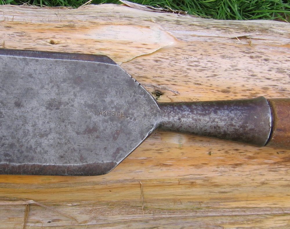

I picked up this Lakeside timber framing slick at a local antique store. Overall length is 25-5/8". Blade is 3-3/8" wide. Overall weight with handle is a little over 5 pounds. The steel itself must be over 4 pounds. It has the heft of a full size axe.
Wow, that is a beast! Ya know....I have a Lakeside cruiser...that would sure go well with it....;)

I love the weight of this thing. Once I get it sharpened up I think it will shave wood very nicely just with the momentum of the 4+ pounds of steel. Shouldn't even need a mallet.

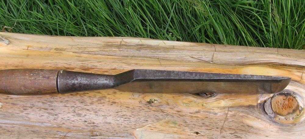

Interesting how the entire length of the left side is beveled, for right-handers to use "sideways", I guess.
The side bevels don't reach the edge. And they're obviously rather crude. I'll get them cleaned up. It'll be interesting to see how hard this is compared to a good vintage axe. I expect it will be impossible or nearly impossible to file.

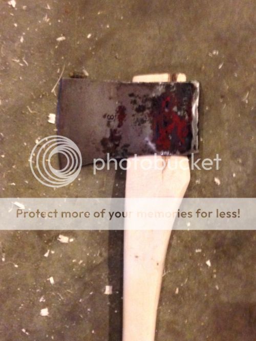

The axe head from my previous post cleaned up decently. I didn't find any other stamps or marks though, unfortunately. It still only has a big "H" at the poll, and little "40" (maybe the year?) under the poll, and a "3" in the middle of the blade. It certainly has a tempered bit though!
I did find an odd shape inside the head at the back of the eye...it like a small thumb sized depression bisected by a thin groove, which you can sort of see here:
Interestingly, it looks like the hardened bit was added on, as you can see the tempered "V" here:
Without and other markings, I plan to clean it up and hang it (it should stick well, I slid it on a handle I had and the thing almost didn't want to come back off!).
Any suggestions for getting rid of the mushrooming that doesn't involve 6 hours of hard filing? I have a grinder, but would it overheat the poll? Would that matter since it's not tempered anyway?
You can beat some of the mushrooming back into the poll at low heat. I heat them with the torch until they're just too hot to touch. Then hammer on the anvil. Recall that the steel deformed cold. Some of it will go back at only warm heat. This steel will be somewhat weakened but since it's really only there to balance the axe it doesn't matter.
After you've hammered it then clean it up with the grinder. Just make sure to quench it frequently so you don't over heat it. And after you've ground it to the shape you can go back to the anvil and hammer on the grind marks to conceal them.
