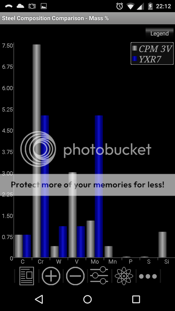

I had a chance to use some 3V this year. I really enjoyed the steel and would love to see Spyderco use it in a folder (as well as a fixed blade). Is there a Japanese equivalent?
