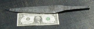

Finally got to forge some last night. It was a little harder then the coil springs but that might have been because it was a lot thicker. I preheated it just because. This is rough forged. I need to draw the tang some and straiten. I'll do an edge quench and draw 3 times. I usually draw 5160 at 390 for 1 hour...is that right for this stuff? Should I put it in the freezer between quenches?
