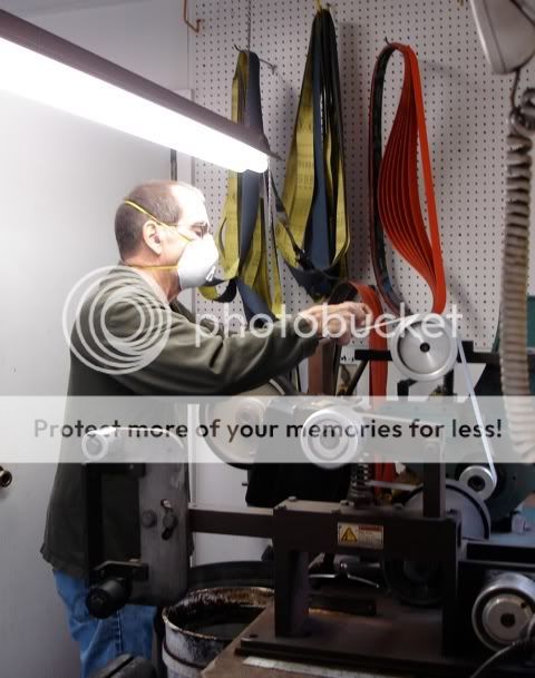

I'll sharpen on the slack belt jig on my Bader, starting with a 60 Micron belt,
then 30, and 15, finishing with a buff on a cloth belt with pink "no scratch"
compound.

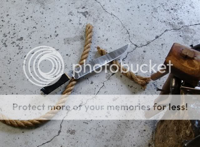

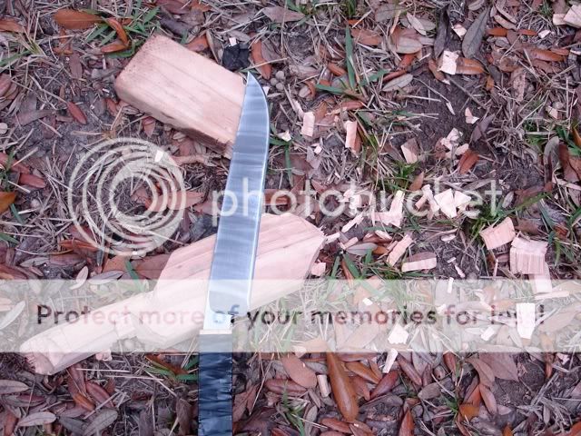

Chop a hard pine 2x4 a couple times. You can see the buff marks on the blade
from laying it down on the higher grit belts for the "Moran" edge.
Cut a 1 inch, free-hanging rope.

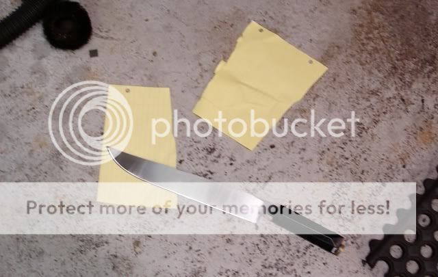

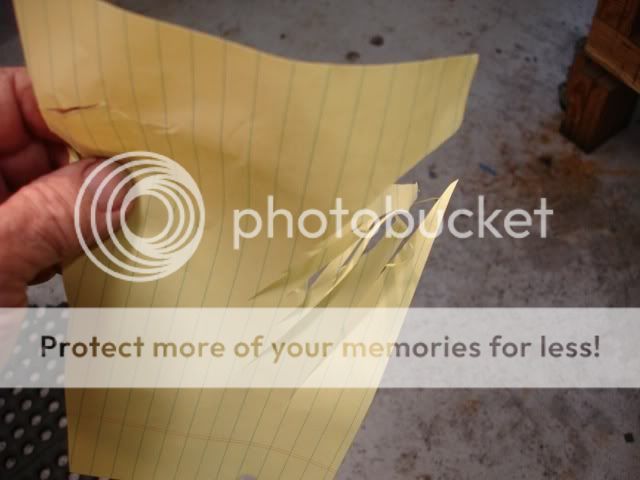

Then, after the 2x4 and rope cuts, try the edge on a sheet of paper dropped in
the air, and free-floating.
Finally, check the area where all the chopping occurred.
We hear a lot about "super-steels," and even my favorite W-2 , strictly
speaking, should "Out-Perform" plain old 1084, but this 1084 &15n20 damascus,
(after all the welding probably closer to 1075 than 1084) ain't too shabby.

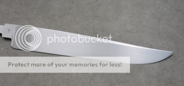

After testing the edge geometry, I'll finish sand the blade through
1000 grit, wet-sanding alternate grits vertically, and at an angle
so I can see that all lower grit scratches are gone, with each
successive higher grit.

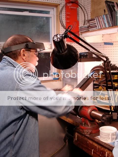

I use a simple leather covered wood support, and a c-clamp for
the tang. It's fast to clamp up, and with the tip resting on an 1/8 inch
raised end, protects me from stabbing myself, and supports the
entire blade.
With the vertically swiveling vise, I can angle the work so as to
put my back into it.

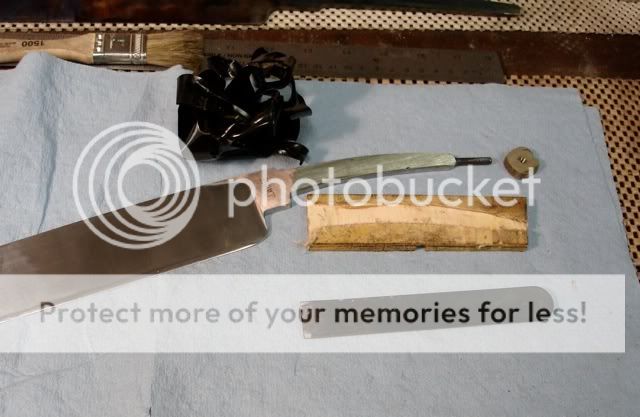

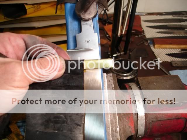

I work the flats with a piece of 3/8ths x 1 1/14x 8 inch Micarta,
cutting strips of sandpaper to fit.
And work the plunge line with a brass strip and the next higher
grit paper at each stage, so that by the time I've sanded the
flats with 1000G, the plunge lines are at 1200.
Finally, I'll "pull" the flats with sandpaper wrapped around a
rubber-backed brass strip, using Windex as a lubricant.

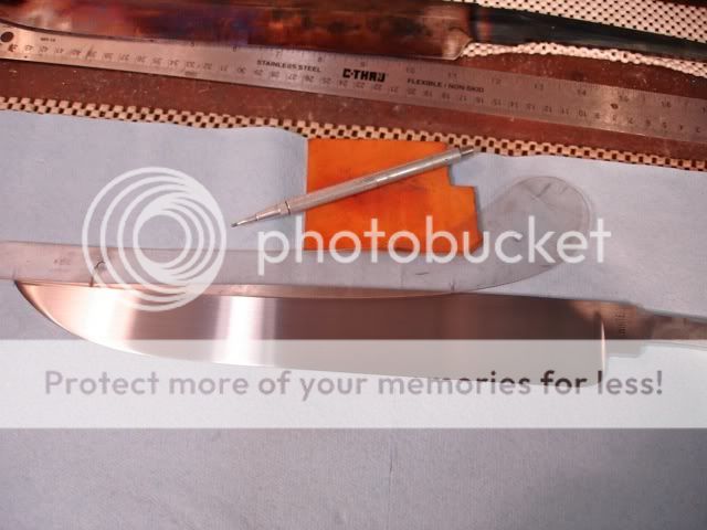

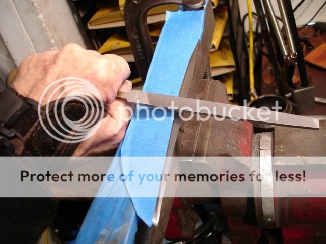

When the blades sanded, I'll mark out the clip with a long
French curve, and the carbide scribe,
Cover the rest of the blade with blue tape to protect the surface,
rough out the clip on the grinder, and start the draw-filing.
It's gotten dark and stormy outside, and I'll quit til tomorrow,
but here's the sanded blade with cilp in place.

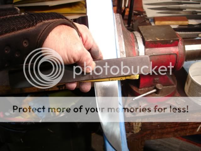

Aww, come on, you wimps. It's a easier to shape the clip before hardening,and I often do, but I still like to leave it a bit thick, and draw-file off any de-carb. I can grind about to the same shape after hardening and tempering, and draw off the same amount pretty quickly.
It's true that it used up a six inch mill file on this clip....
Peter, there's no valid reason. I got a little obsessive about this particular blade, and couldn't bear thinking of a long tapered tip going in the quench...
Joe, draw-filing ought not leave deep marks. Talk nicer to the file.

Peter and Joe,
Just sanding out the clip and realized i should have given a better answer about draw-filing in a WIP.
The most common mistake in filing with a mill file, especially on hardened steel, is to put too much pressure on the file, (and not clean the file constantly with a file brush.) Whether straight or draw-filing, lighten up on the pressure, and keep the file flat on the metal. You'll be astonished at how fast and smoothly the file cuts, and how fine a finish is left. You should be able to go directly to 220 grit on hardened steel. If there are deep grooves in the filed finish, either you're not keeping the file clean, and/or you're using too much pressure. Again, try really lightening up on the pressure, and letting the teeth pull the file into the metal.
It's almost easier to file hardened steel SMOOTHLY than annealed.
Sometimes I think too much about the fancy stuff, and forget the grunt techniques.
