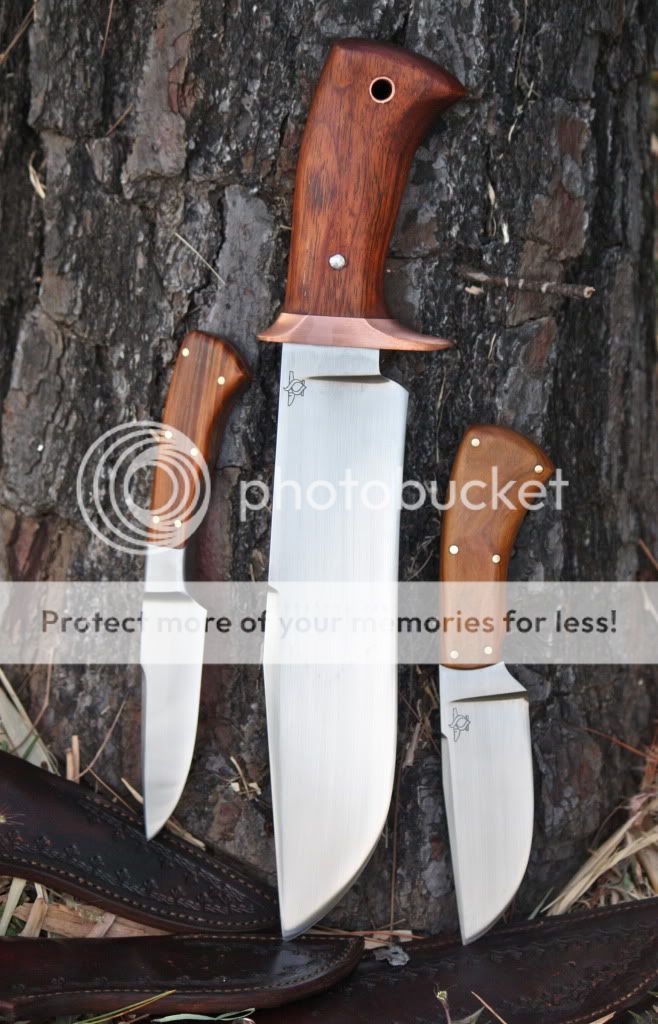

I'd be happy to share the first three knives and their critiques. The pictures are not the best and will not reveal all the trouble areas but I'll try to write as best i can to describe what Jason and Burt suggested that I change.
This pic is of the three knives together just to show proportion.

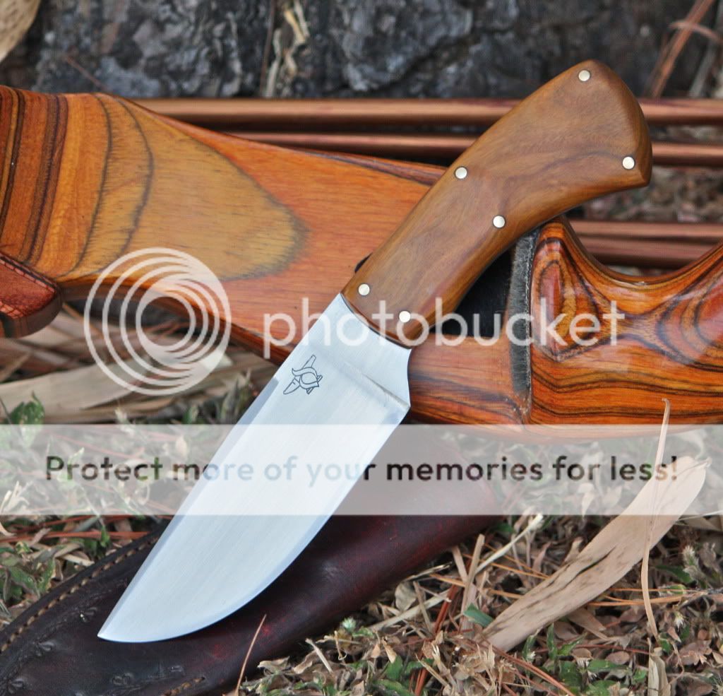

Full-tang Hunter
By the time this blade made it to Jason and Burt the wood (unstabilized Guayacan) had dried, and shrunk to reveal the full tang all the way around the handle. The blade had too much of a belly and needed more of a point. The hand-rubbed finish had some problem areas as well.
Lesson Learned: more point to the blade, more time on hand finishing, buy stabilized wood to avoid shrinkage.

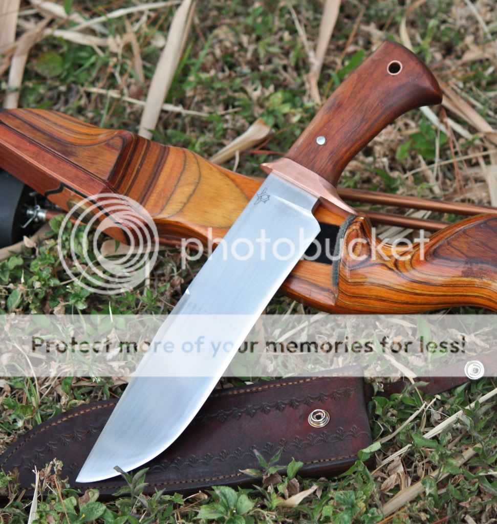

Large Chopper
This knife had lots of little things that needed attention. As in the full-tang knife, this blade had a large belly and not enough of a point. You may notice some tiny dark dots on the blade. This is due to the wax in the sheath stitching that stained the blade. The ricasso area is too wide. I believe it measures a little over 1 1/2 inches. Burt suggested this area be no more than 1 1/4 inches. I used copper for the guard, which I love (even when it gets a nice patina) but it is suggested that I don't use it for the test. Since it does oxidize unevenly sometime I can see how this may appear sloppy. Guard to handle transition needs to be a smaller radius and move more into the guard and less into the wood. My handle pin was domed and peened. I didn't pull it off very well for a test of this caliber. Thong tube was not neat and clean where it met with the wood. The wood I chose for this was not a good choice for this test.
Lesson Learned: again, less belly in the edge area, more narrow ricasso area, no copper in the guard, cleaner pin/thong tube, better choice of wood.

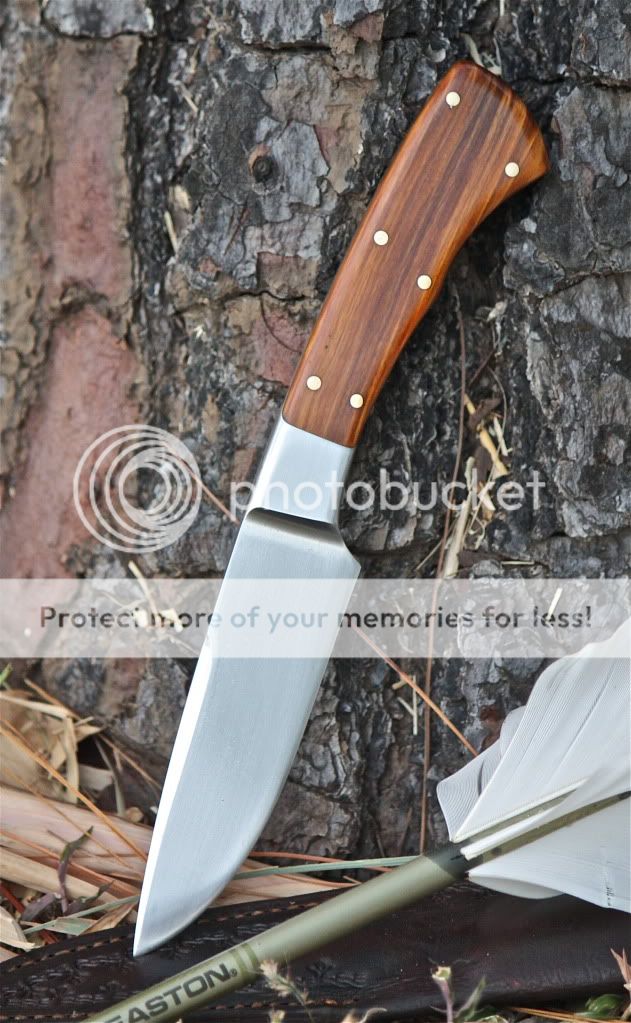

This integral was probably the most liked of the three. The only concerns for this piece were a small divot in the handle wood and the spine was rather thick making this one look and feel a little "chunky" in the hand. Burt thought this piece was the better of the three and may pass with a little more attention payed to those two areas. If it gets down to the wire and I still need a back-up I may try to fix this one.
Lesson learned: less chunk in the blade thickness to give a more elegant look, check for details in the wood finish.
