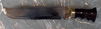

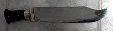

I have a proto type from Yangdu. It had rust, (you dont think she'd send me a good one, do you???!!!) a slightly uneven finish, and the worst handle I've ever seen on a HI product.
Still, I like it. I spent some of yesterday afternoon trying to modify the handle enough so I could chop with it and not tear up the skin on my fingers.
This one is by Murali, the first I've ever seen by him. The edge appears to be solid, and is sharp. But the finger grooves he put in the handle were deep and not ergonomic to any known humanoid I know of. Even Carter did not like it.
Now, when you really want to fix something, popping the pins off the chiruwa handle, removing the halves, and then reforming the metal handle would be best. But I have no pins handy, and I wanted to chop as soon as possible.
So I painstakingly attempted to remove both metal and wood with a belt sander, a rotary drill bit, and a file. This is a very silly thing to do. It will take me a long time to remove the marrs in the metal. The good thing about this system is you can keep removing material until the handle feels right. Course, you could do that with the handle off if you had a temporary screw to hold them on. Which intrigued me: would a screw handle hold on a high tension tool like this?
More in a few minutes.
The problem with the handle is it is FAT on the bottom, tapers in the middle, and only swells out slightly towards the bolster. If you don't know why this would be a problem, imagine your pinkie having to cover more material in the grip than your middle or index fingers: the exact opposite of the natural grip. I kept looking at it and wonder what I should do. Rather than just grind the thing to suit, I wanted to leave as much of this design intact as possible because I thought the maker might have a reason for it, that might be revealed while chopping. In the light chopping Carter and I tried yesterday, we both agreed it was a no go. Today I have the handle reduced enough to try again.

We see some of the rust, and the most God Awful cho I've seen....
But you see what I mean about likability? This is a massive, vegitation attacking tool. Yangdu mentioned the cho had to go, and we will hopefully together decide what we would like to see in future handles.
The second series of photos shows my progress in reducing the handle finger grooves. I was not satisfied with that progress, and did some more late last night. I do my worst work late at night with poor lighting, the family in bed, and me trying to hide the sounds of the rotary bit.
We also see some thick laha or fill. I suspect the metal handle was not flush and the wood handle halfs did not meet square. That's the grey stuff you see.
I need to get one of those small rotary tools, instead of my big half inch Hole Hawg. It would be a lot easier to clean up the metal if I could get in there. All of this goes to show that removing the halves might have been best. But, at least today I'll be able to chop and post those photos soon.

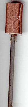

Munk,
I've made rotary sanders by taking a round metal piece, maybe a long 3/8" bolt with the head cut off, and cutting a slot with a hacksaw in it. Start at the end and cut a slot about 2" long. Then insert a strip of sandpaper or emery cloth into the slot and wind it off. As the paper gets worn, tear off a little bit to expose fresh paper.

That's a good idea, Steve. I tried some more work this am, and was smart enough to use 220 grit instead of 330, but it is still a long process by hand.
