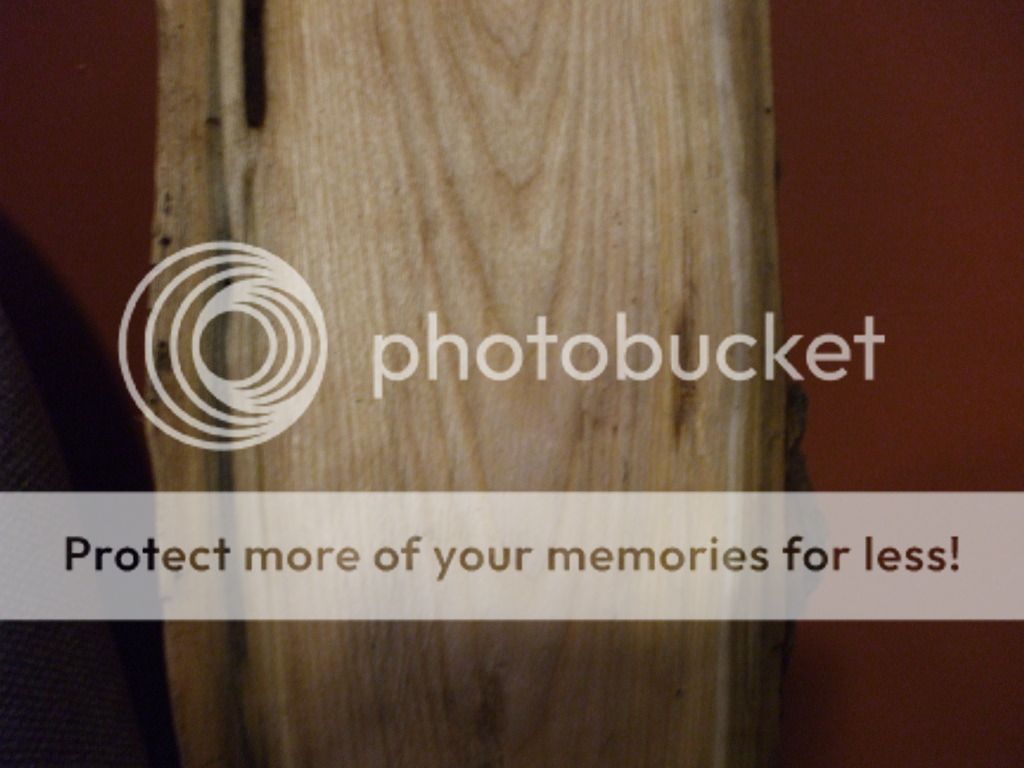

trying to work out some black cherry scales for my 16, (I have a large slab off a downed tree that I need to cut blocks out of) Any tips guys? (I know I need to stabilize it but not quite sure how to do that).
here's some pics of the grain and size
There are ways to home-stabilize, but most folks send fancy wood bits to a pro.
Our local Woodcraft store had some stabilizing fluids at the store-closing sale.
However you'll have to dry it first, I believe. That can take a year.
Once it's dry, you choose to stabilize or not. If you're doing bolt-on scales... I'm not sure what kind of difference that makes. Bolts are more likely to be over-tightened than pins, which suggests stabilization. On the other hand, since the handles would be removable, that suggests that they can suffer a little seasonal swelling and shrinkage without threatening the epoxy, since there'd be none.
The grain on that probably won't be very spectacular as a knife handle, but if it has sentimental value that matters more. I've worked with cherry a little bit and it has a nice tight grain and works easily with minimal tear-out (the variety I had, anyway).
Yeesh I may be in over my head. Well the tree has been down for at least a year or two (don't know if that factors into the drying or not but it was far from green), and I've always like black cherry as a tree and I was probably only going to use them part time till I can get some Micarta scales. Thanks man, good to get some advice from a pro :) .

Go for it. Always give it heck.its all just about learning, anyhow.
