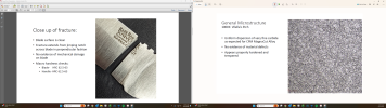

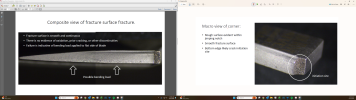

There was a dbk video that tested a brk knife in magnacut shortly after the steel released and the knife (im trying to recall) either chipped or broke in half during batoning wood. They told brk and they replaced it saying there must have been an issue during HT or the steel when the knife was made. Again im working from memory but I do remember the highlights of that video. Im starting to wonder if that was even magnacut at this point
Yeah I remember that one too, seemed a bit odd then but the inclusion excuse seemed plausible at the time, now, not so sure.....

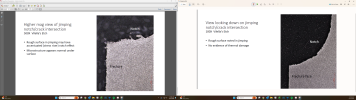

Yes, and if I recall correctly the knife in question had some large, deep jimping along the spine - right where it met the handle. BRK basically put a row of serious stress risers in the worst possible spot. Even if it was the correct steel, it's almost like they didn't consider the possibility they were intentionally weakening their blade.

Thank you for sharing detailed test. Do you also have OES or XRF analysis result?
We don’t have documented XRF or chemistry on file for this specific batch. We did verify it with our XRF gun prior to sending it to the lab to confirm the grade, but that step wasn’t formally recorded.
The lab had already worked on MagnaCut samples during the Survive! Knives situation and noted that this material showed a fine microstructure consistent with MagnaCut. If anything looked off, they would have flagged it.
