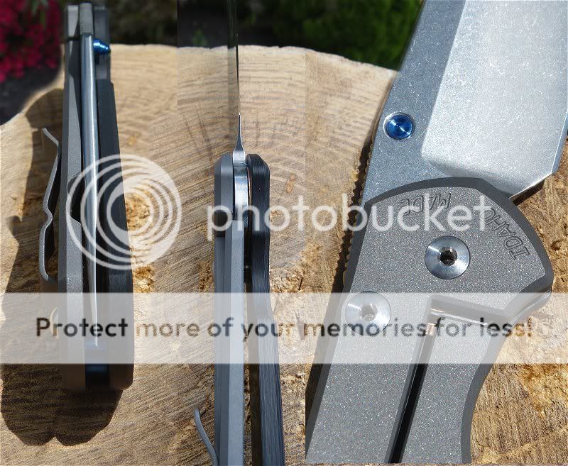

Its a small world. I am also very disapointed in my CRK.
I just received a large new CF Sebenza yesterday and the action was ridiculously stiff and almost gritty like. The detent was also way too strong. Lets put it this way, out off all my Striders and customs like Lambert,Mosier,Doucette The CRK was easily the worst action. I know what a smooth knife feels like and should expect. I adjusted the pivot and its action was average to poor for a production knife. It was sent back today. I am jaded because I own a little bit of every brand but the CRK was unacceptable and I want to own at least one of every brand. Over all the fit and finish was excellent and the weight and size of blade was great....BUT the action and horrific thumb studs are a deal breaker for me. The thumb studs would be a disaster in the cold wet snow to open.
I took a couple of picks before I boxed it back up. Does this lock-up look a bit advanced for a new knife????
Every new Sebenza I get the first thing I do is take it apart and re lube it. Sometimes the grease will dry out especially if its been sitting in a box for a little while. The action will seem
dry and you wont feel that hydraulic action when opening the knife. As far as the thumb studs go it takes a little getting used to and a slightly different technique to open. But once you get used to it
its simple as pie.
I think you gave up on the knife way too soon. :) I have 10 Sebenzas (all purchased NIB) and they all required a short break-in period. They were not buttery smooth right out of the box.
Plus, those Carbon Fiber Sebs from KnifeArt have been in stock for months. By the time you got yours, the lube that CRK applied from the factory was probably completely dried up. Anytime I receive a Sebenza, the first thing I do is take it apart, clean it, and then reapply the CRK fluorinated grease. After about a week or so of continuously opening and closing the knife, the action will be buttery smooth.
