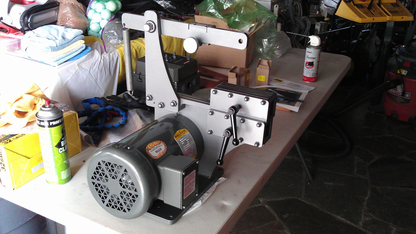

Thanks for the explanation and photo. Good point about the hp rating on the switch. I'll have to double check this info.
Getting there! I still need to make the 6" drive wheel and idler pulley. The arm has custom made shaft and delrin bushings and the tracking unit has a custom shaft.
Very nice. What model baldor did you go with?
