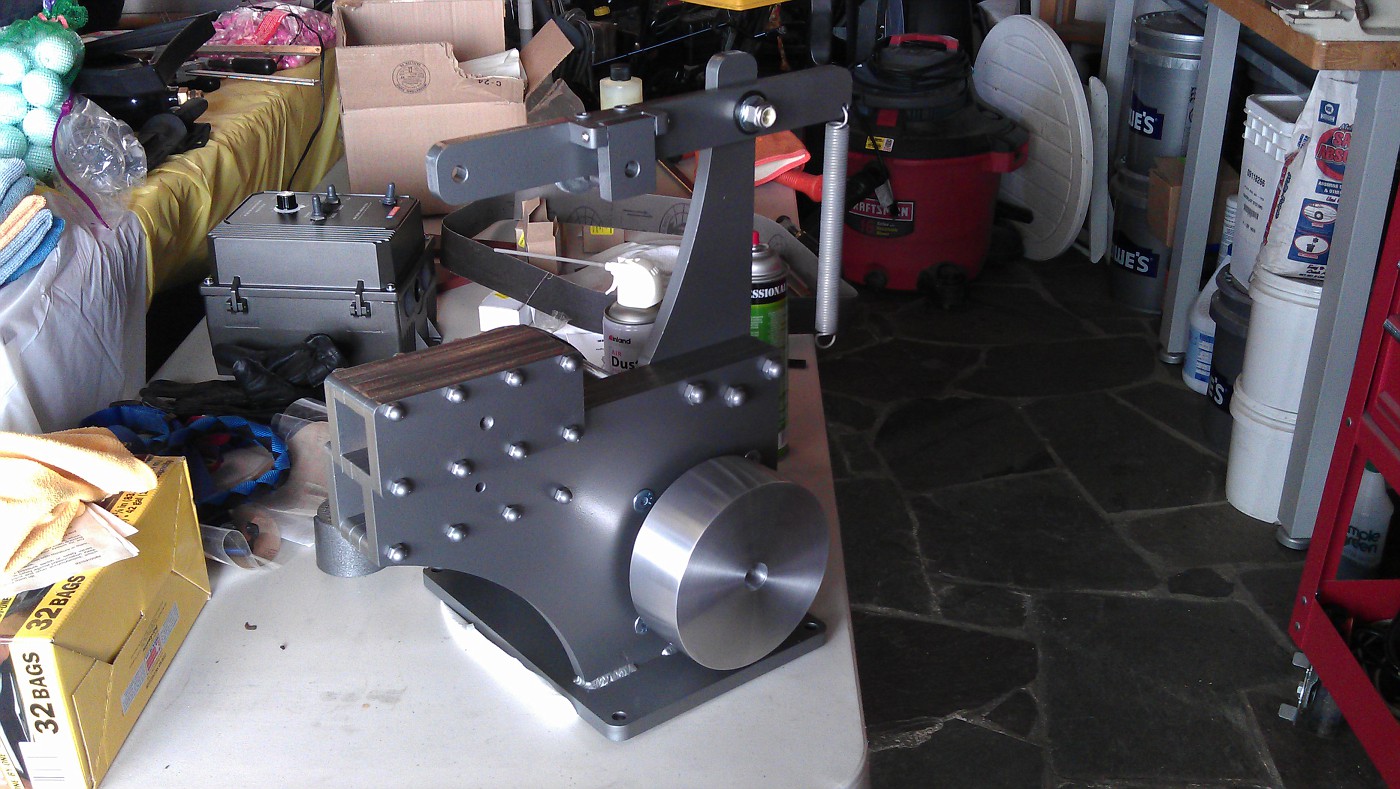

I went with the Baldor VM3609 as it was $70 brand new surplus locally. It has a 7/8 shaft which is why I need to make my own pulley.
Mac
Pulley Made :)
