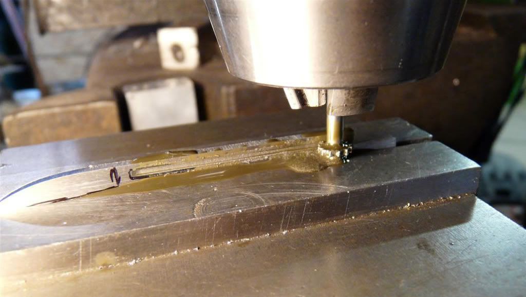

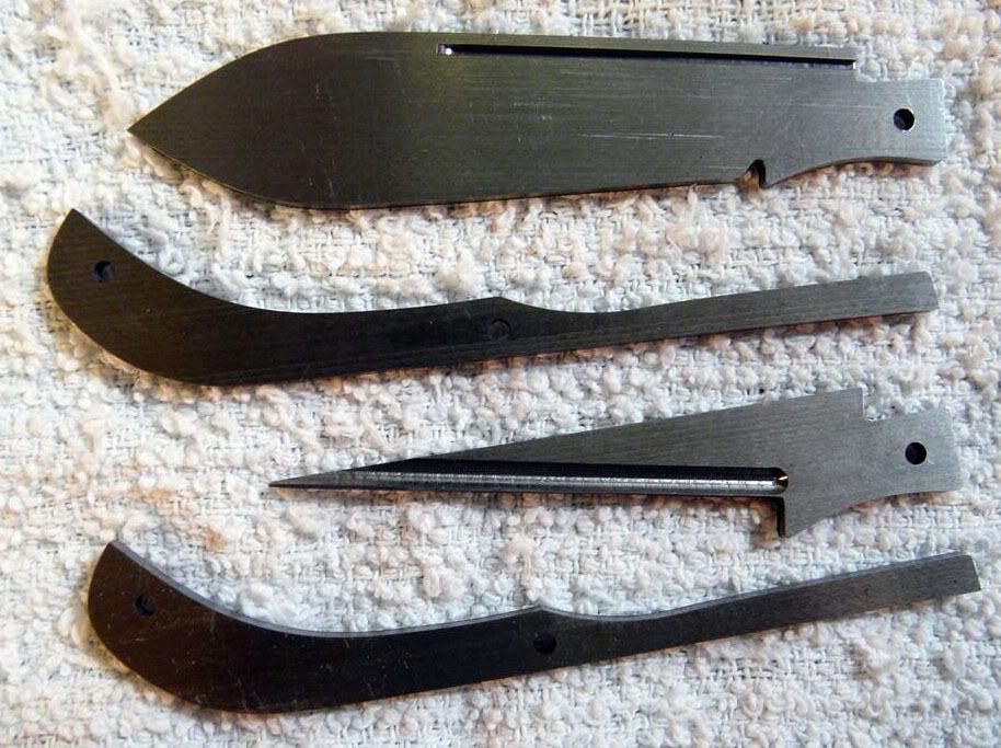

First I drew paper patterns and glued then to sheet steel to make some permanent patterns. I made a punch blade first and used a 1/8" ball end mill to make the groove.

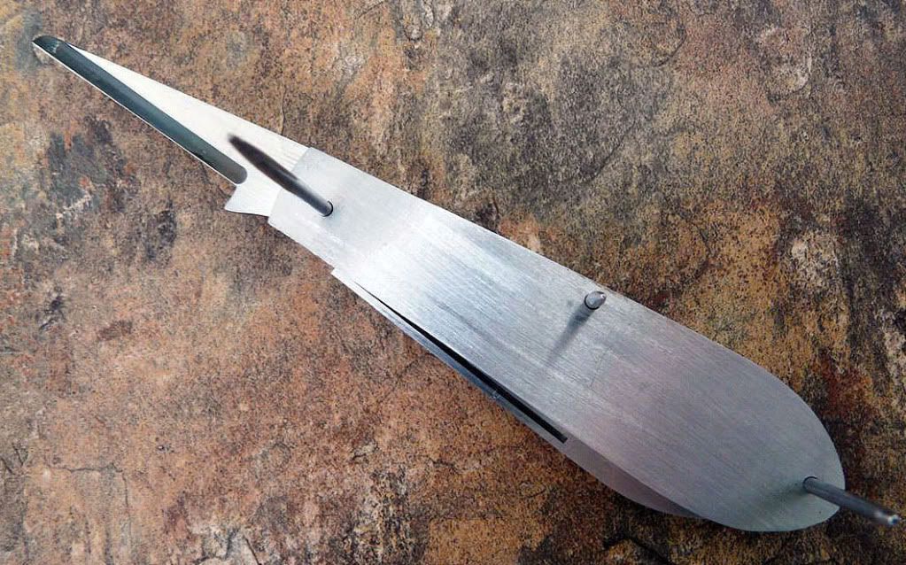

Surface grinding the blades and springs

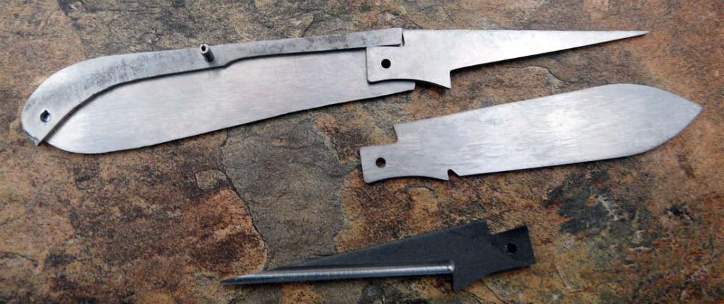

Cutting the long nail pull

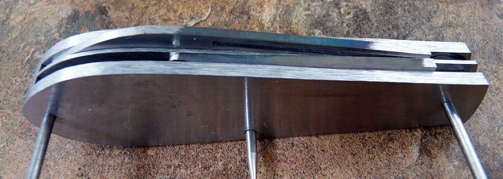

Blades and springs surface ground and heat treated

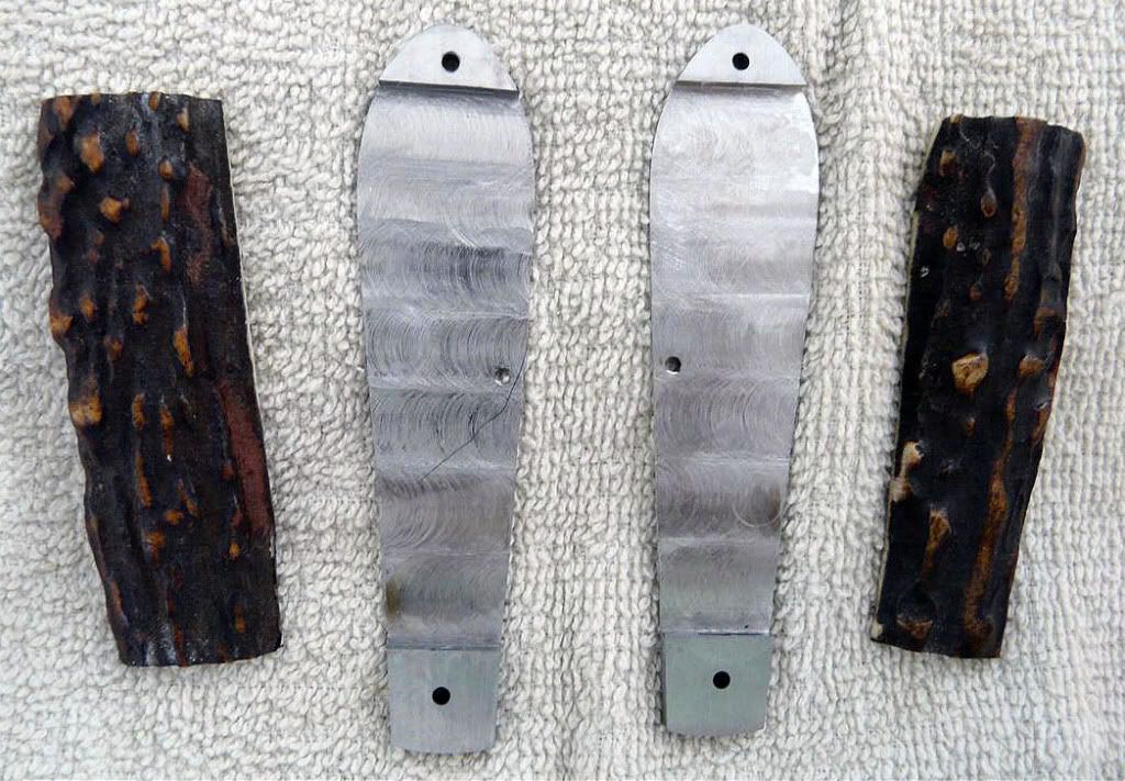

The liners after milling, and the stag I plan to use for scales.

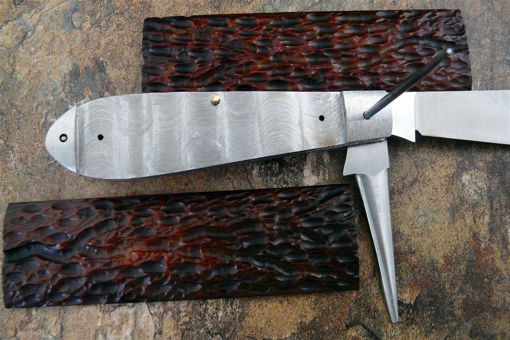

Two steps forward and one back today. After spending some time fitting the stag I decided it was too thick so I can't use it. I 'm going to use some bone jigged as close as I can get them to the scales on an old Union Cutlery hunter I have.
I ground the master blade bevels, the pile side of the punch and ground the nail nick on the mark side of the punch.

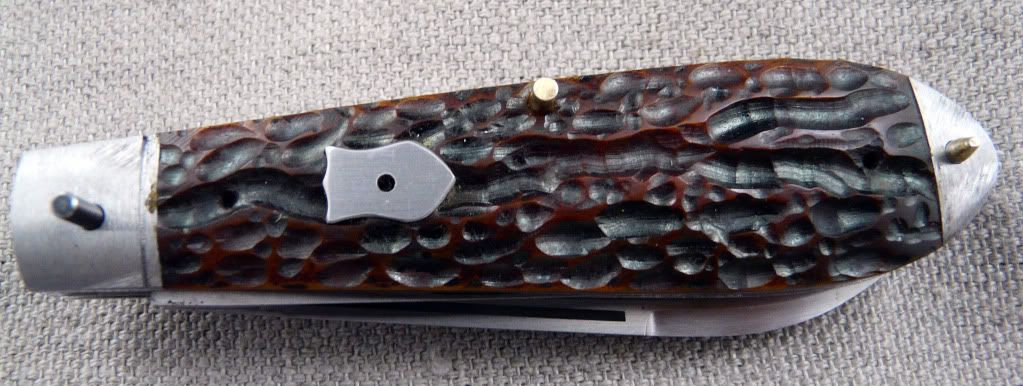

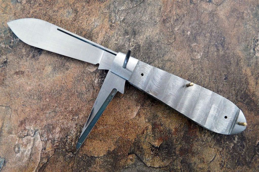

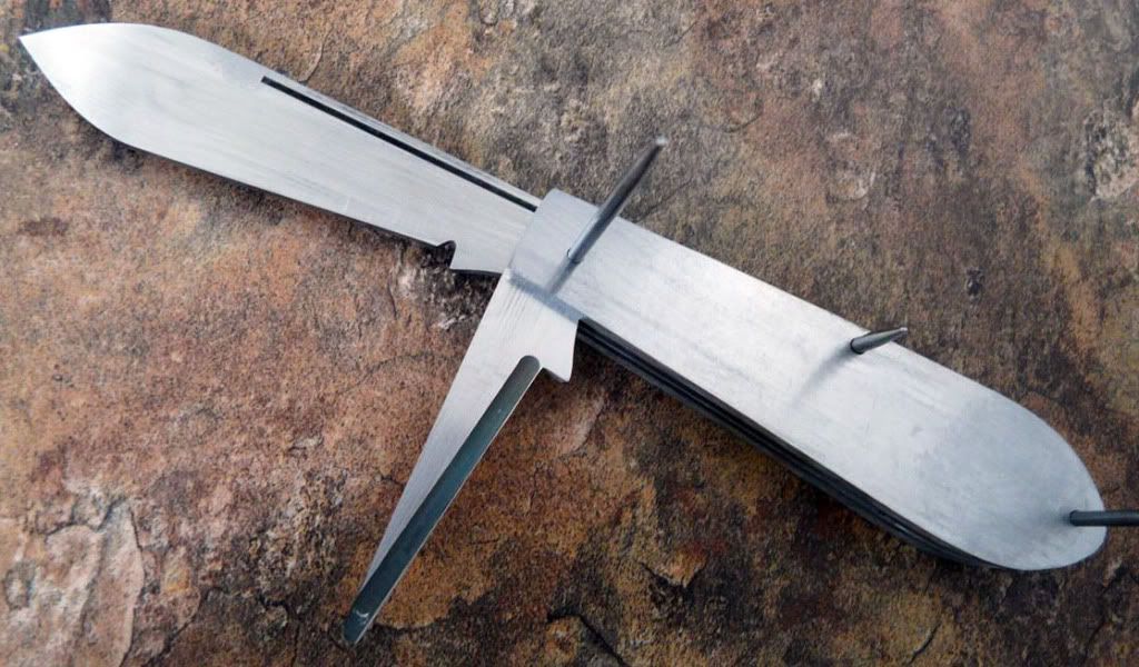

Made some good progress today. I got the scales installed, swedged the master blade, threaded the bolster and inlet the shield. If all goes well I should be able to finish it up tomorrow.

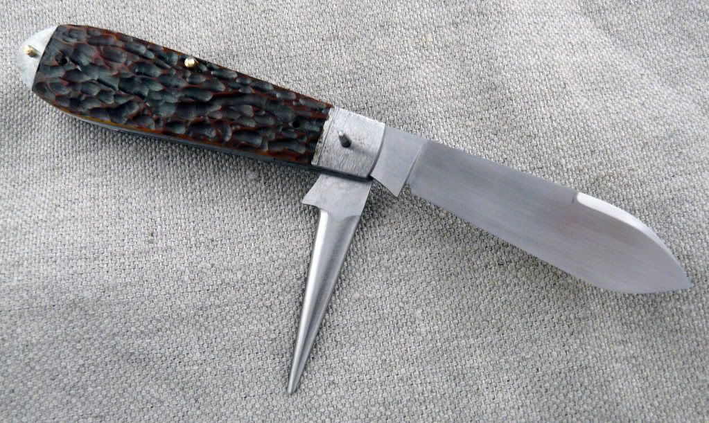

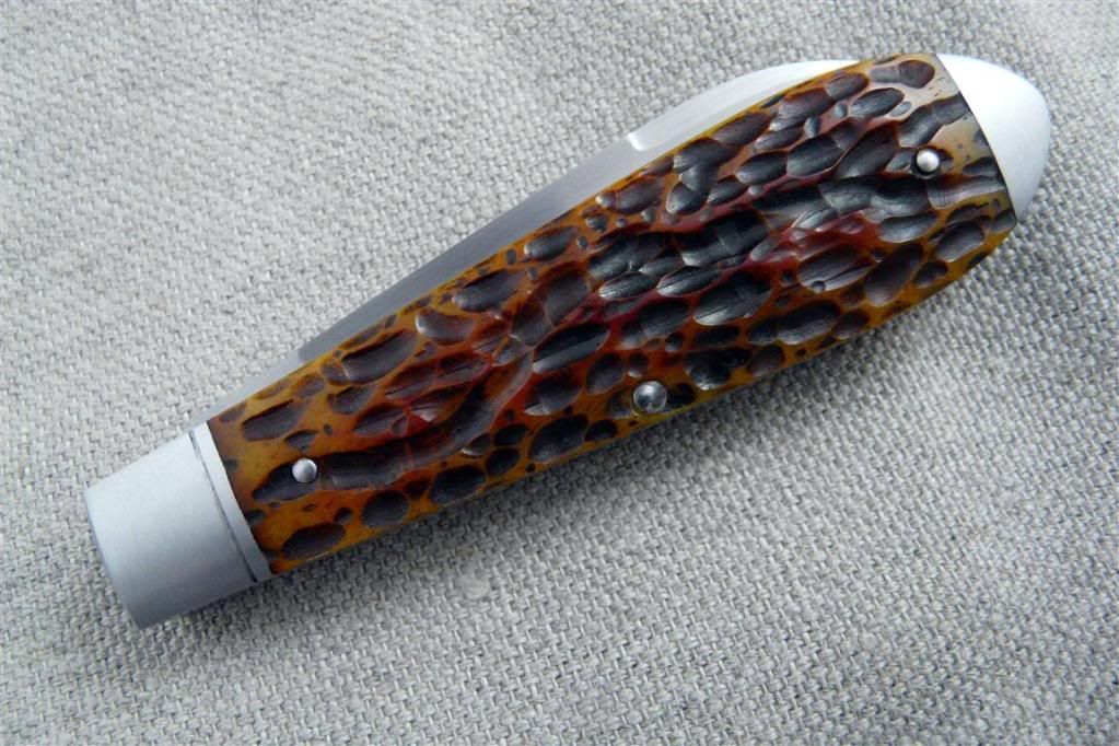

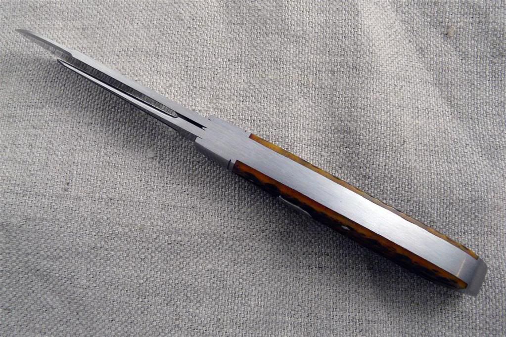

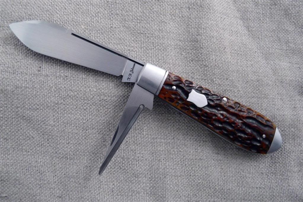

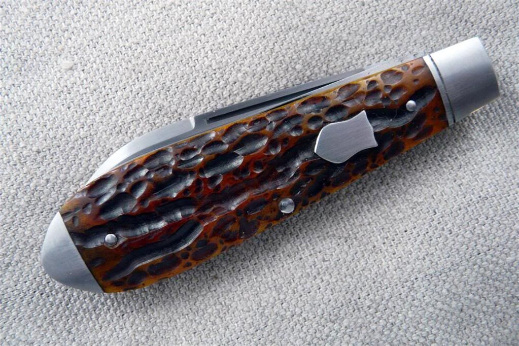

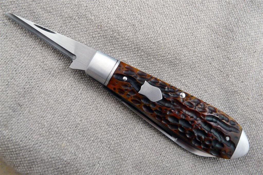

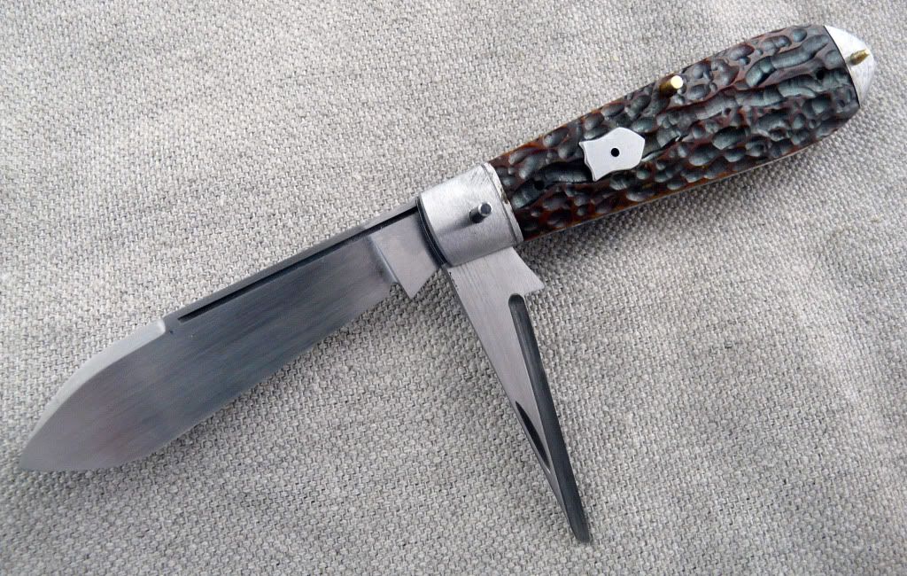

I finished the harness jack today.
Thanks for watching, thanks for the comments, enjoy the photos.
As always, comments are welcome. Keith
