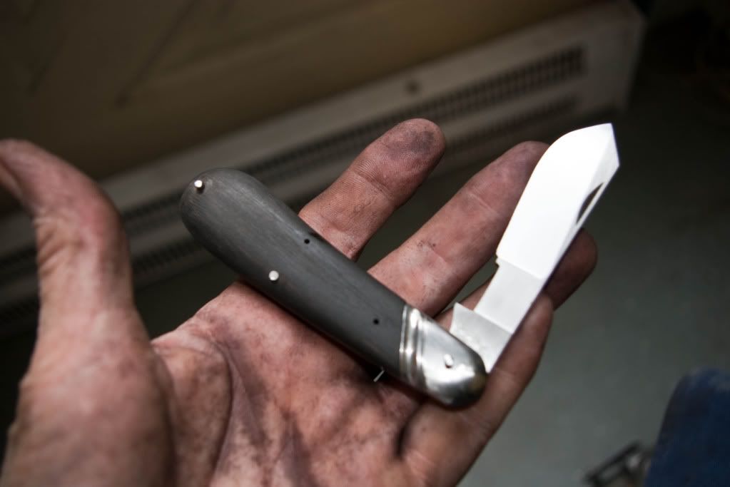

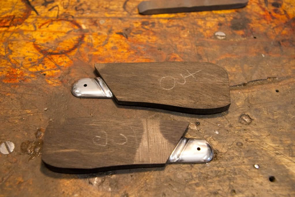

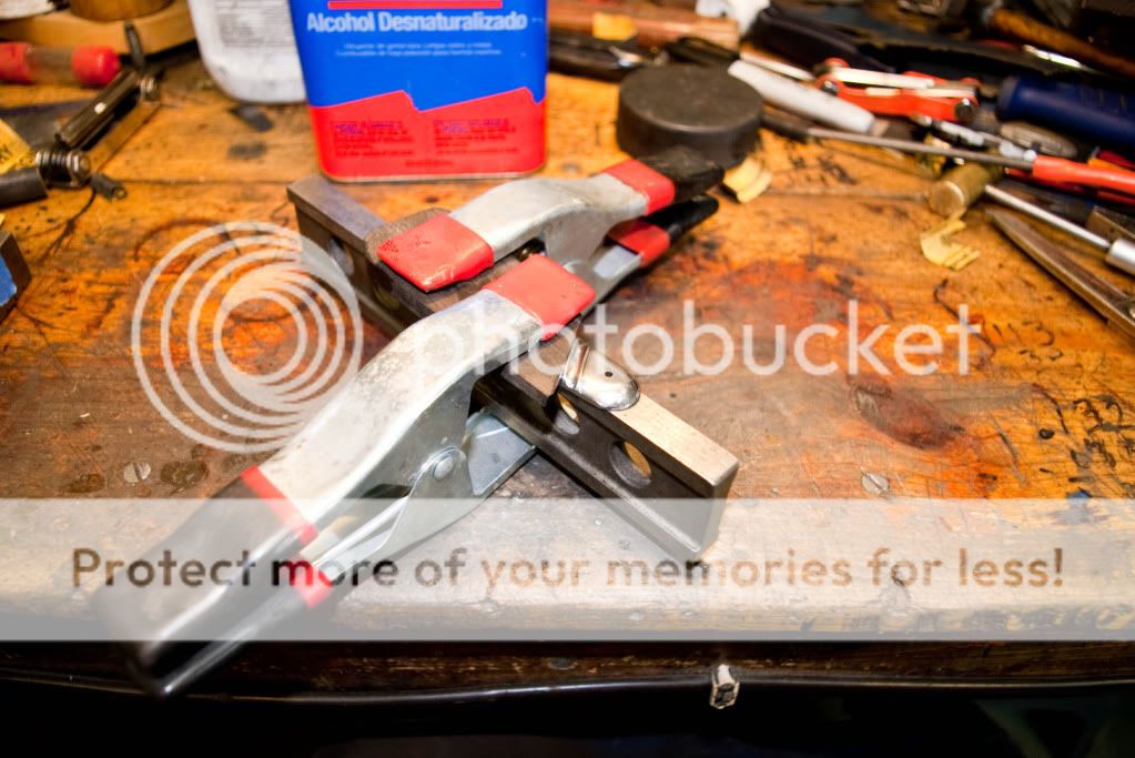

I have the Ebony rough profiled and ready to attach to the frames.

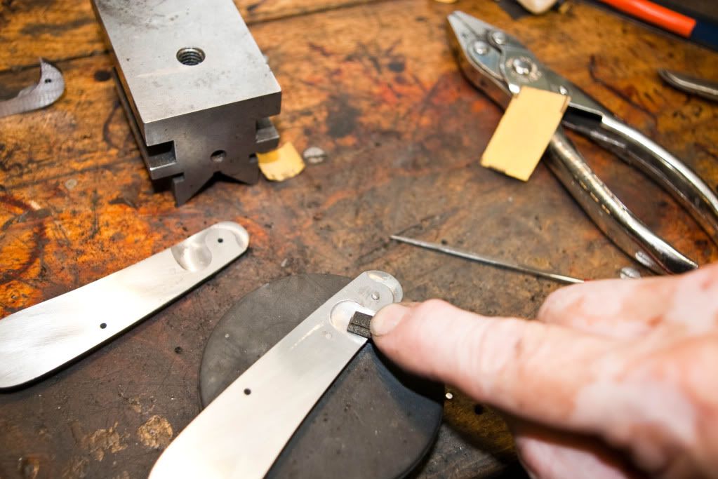

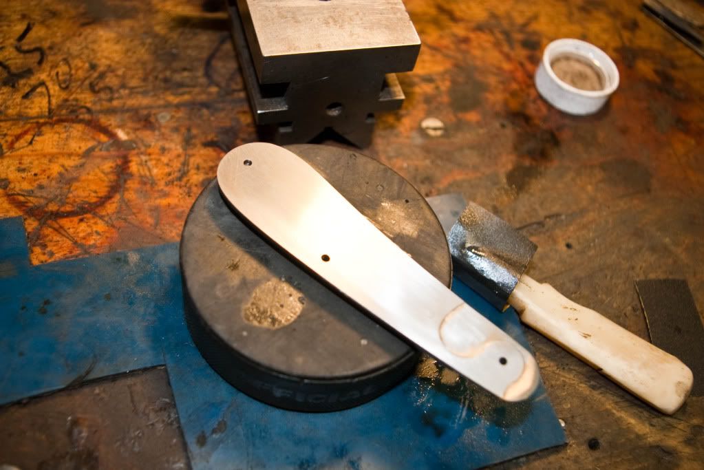

I use Gorilla glue and spring clamps. I clamp to frame and scale onto a hardened straight parallel. I use the glue more as a
aid in building the knife, rather than a means to attach the scale. The scale pins and spring pins will hold the material.

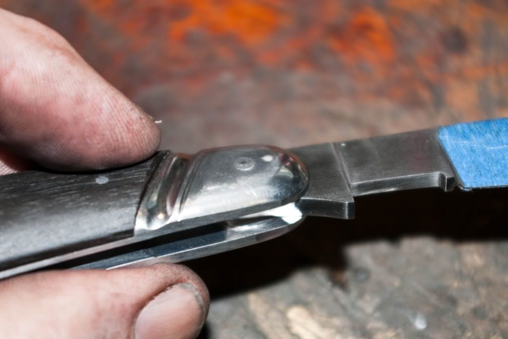

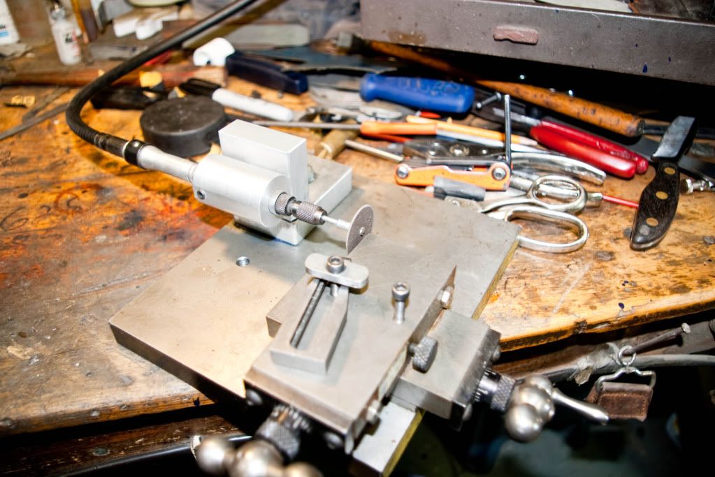

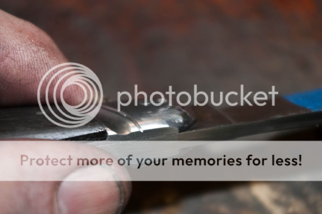

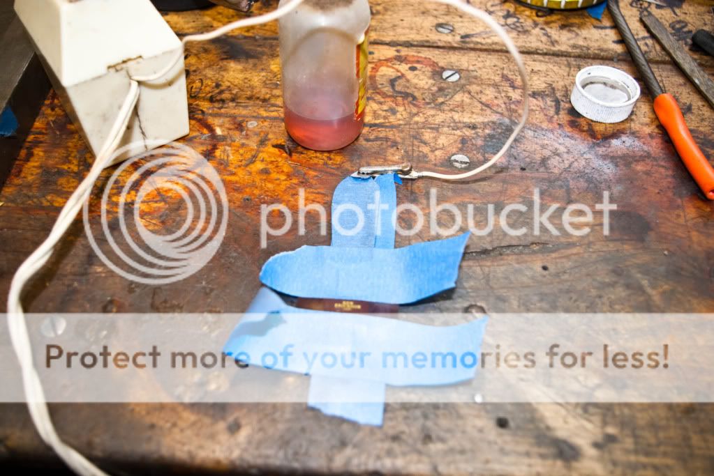

While the glue is setting up I use this fixture to refine,cut my choils.

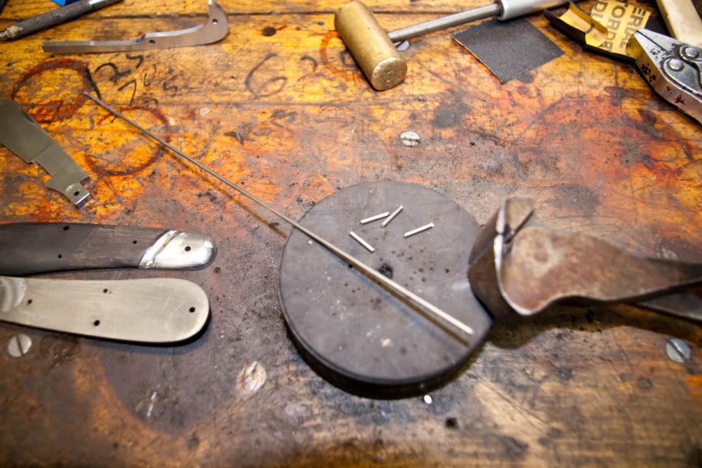

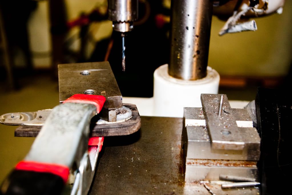

The scales on this knife are tapered so the holes must be drilled from the inside out. This is my simple set-up for getting this job done.

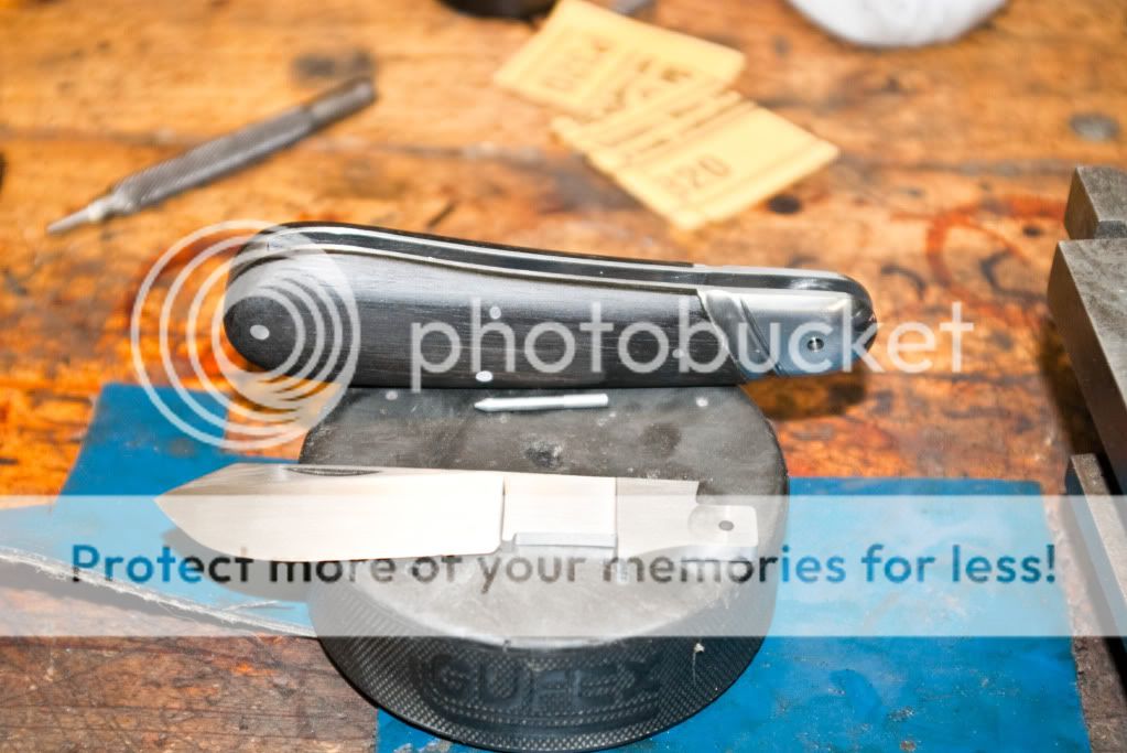

I use this hand held tapered reamer to taper the hole in the scale material. This prevents splitting of the material at a later date(hopefully!

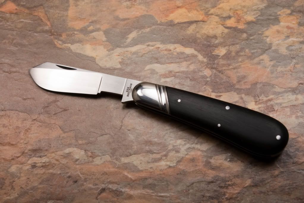

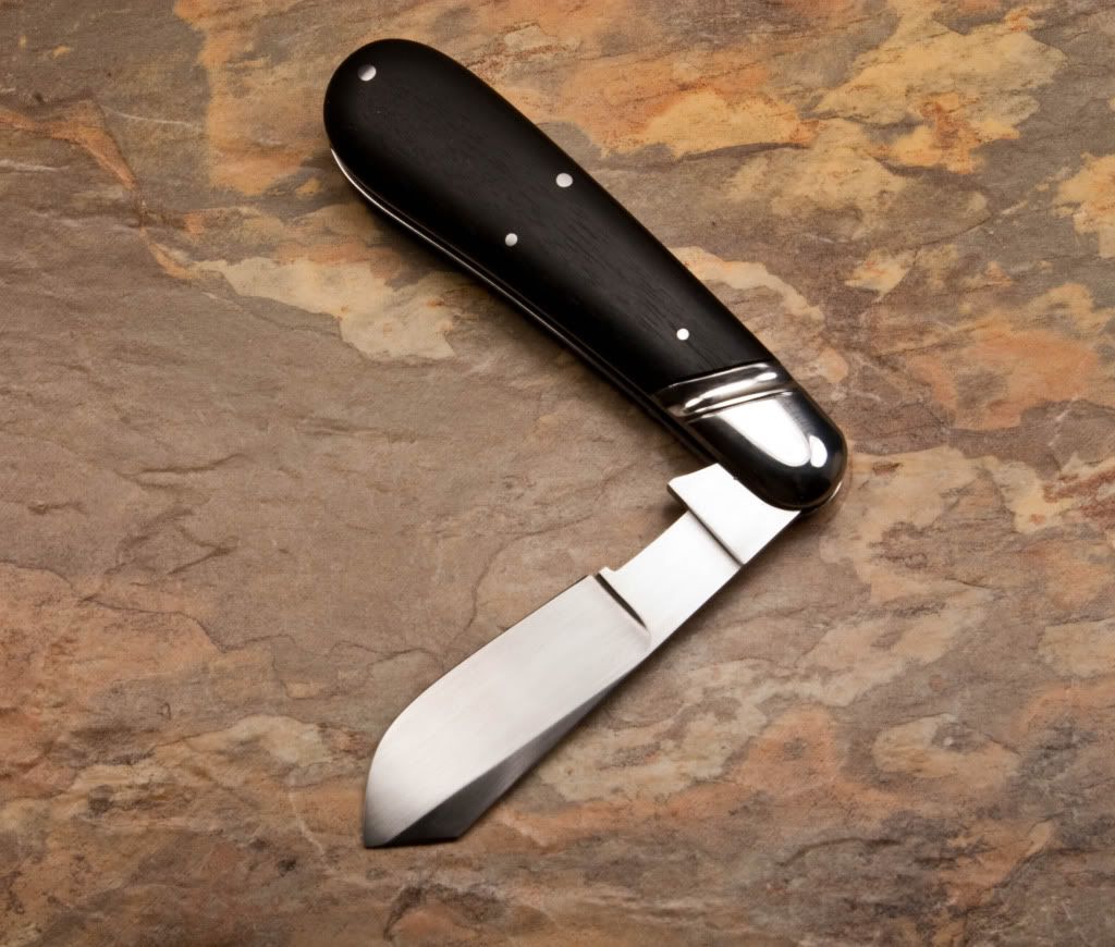

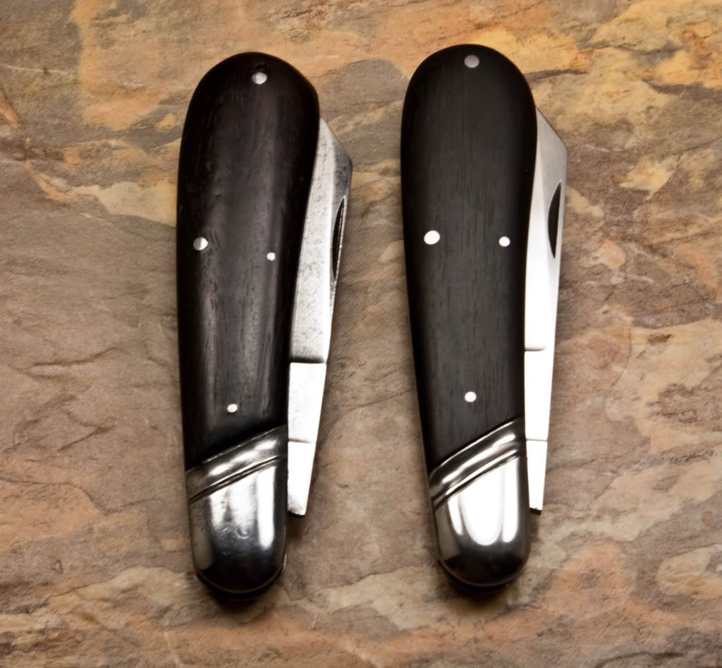

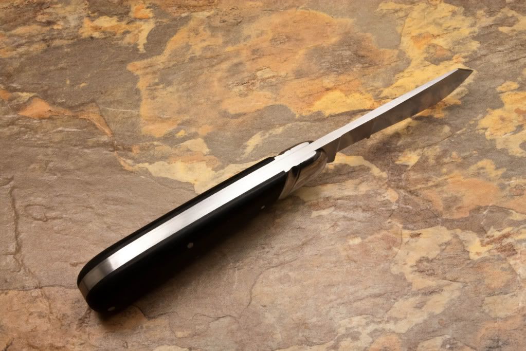

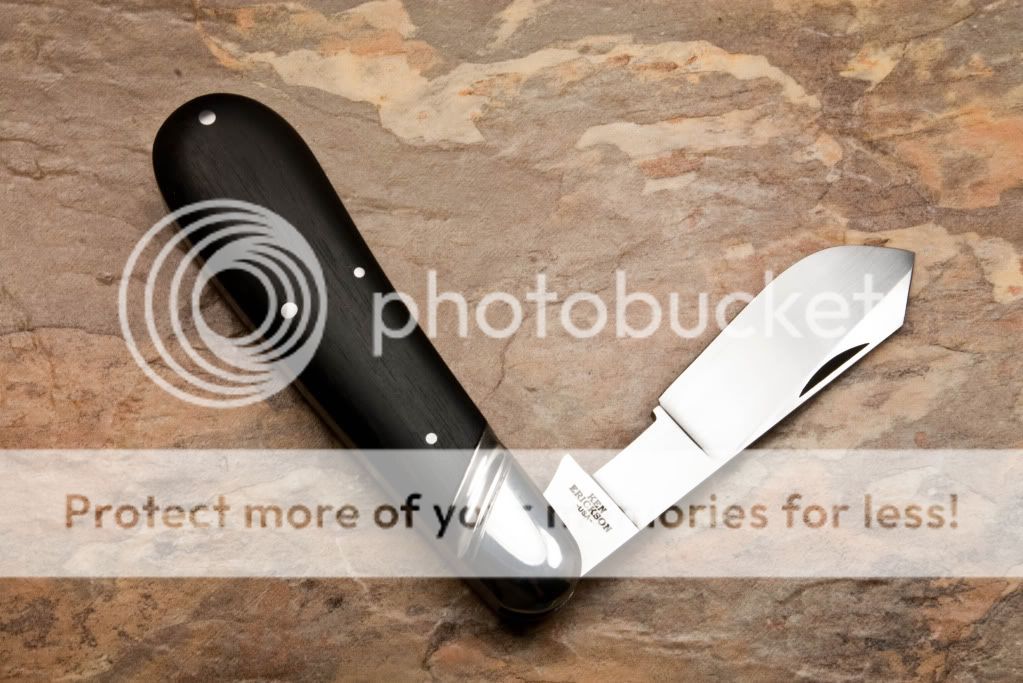

Really starting to shape up now!
