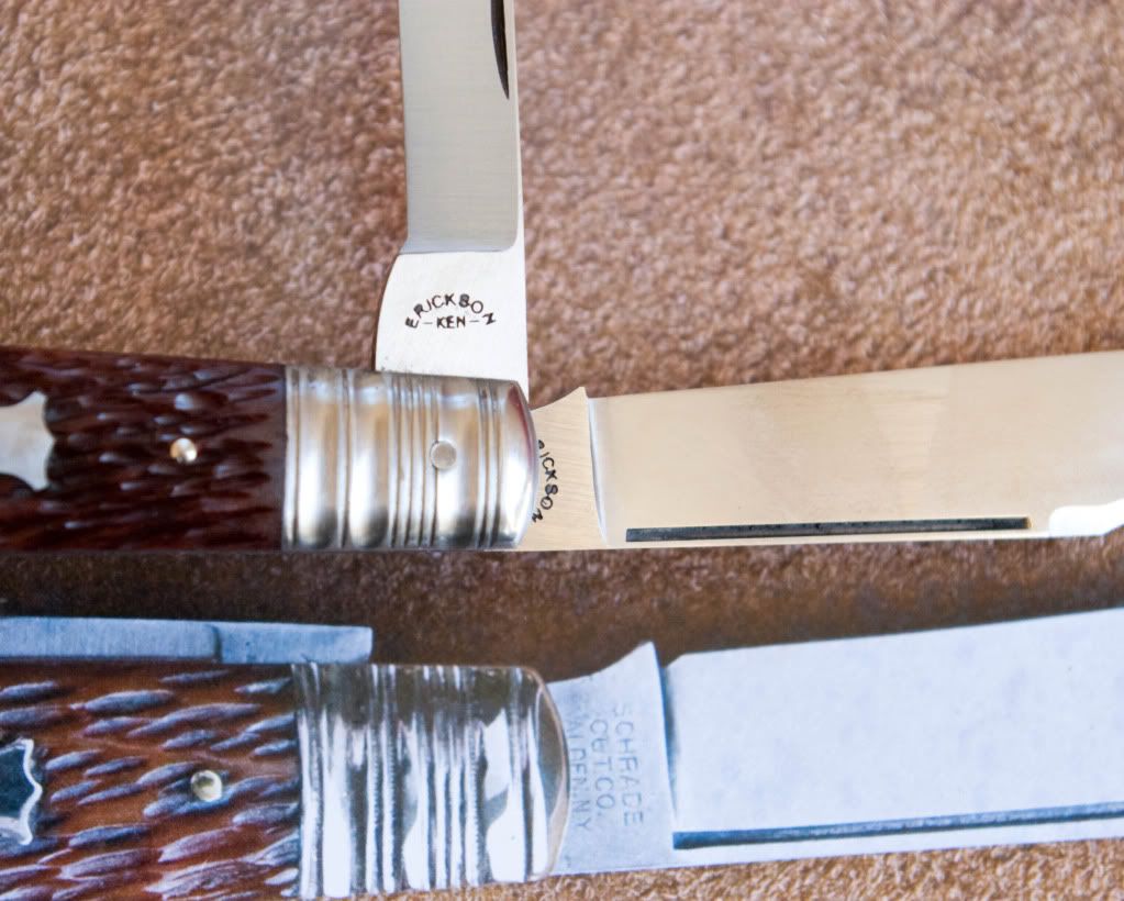

Thanks Elliott,
I had given thought to actual stamp or etch with blade steel but thought this was in keeping more with vintage ways of doing things. Kind of like Case with the "dot" system. They could have very easy just had a stamp made with the year of manufacture. Plus years down the road, collectors may have fun doing research on the meaning of the small stamp on pile side! :o;)
Thanks Elliott,
Or you may end up with the same situation our mutual friend Jerry Halfrich encounters with everyone thinking that he owns the 5th knife of a given pattern. :p
(Of course your numbering system will provide for even more "fun". ;))

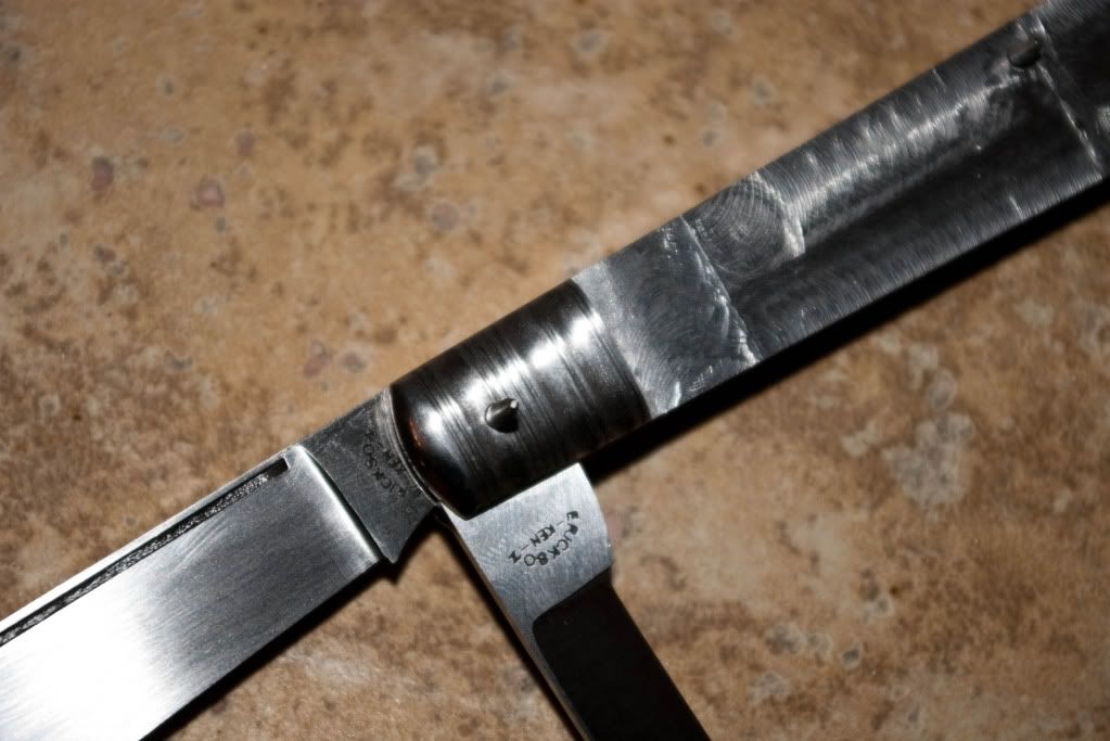

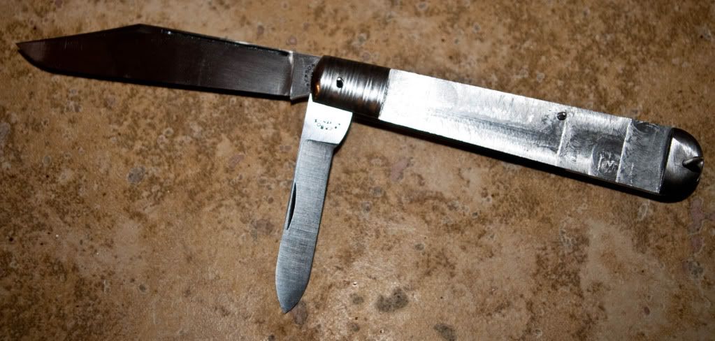

I have made significant progress on the EJ . The bolster treatment was a chore, getting everything spaced right. Of course still in the rough state. I have the scales in the dye now. This knife is going to have something different as far as blade finish compared to any other knife I have made to date. Charlie has asked that I put a crocus finish on the mark side master and glazed finish on pile side and both sides of the secondary. Of course this finish will only be an approximation of the finishes that the old cutlery companies were able to produce. Without getting into a lot of details, both the methods, machines, and materials are long gone, along with the knowledge base to replicate these old finishes. This knife will also deviate from the Schrade version in that the secondary blade spring will be an extension spring, filling the otherwise open gap.
Wow! It is amazing to watch that knife emerge from the raw materials! The patience and talent it takes to revive an old design are awesome. I believe it is much tougher than an original design, because there is no room for error or compromise!
Of course it's hard to see that bolster now, but it is going to be amazing, as is the whole knife!

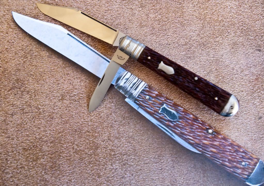

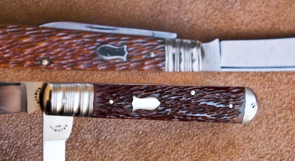

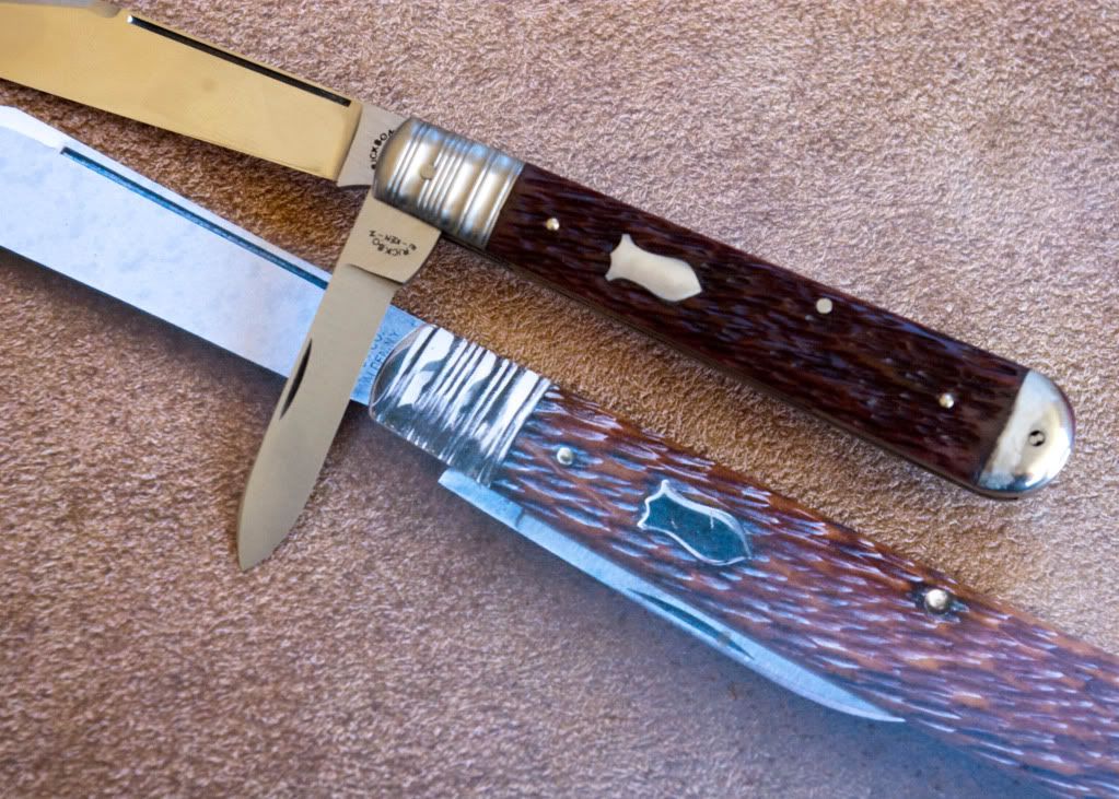

Had a chance to get a bit of work done on the EJ. Charlie had sent me a 2010 Schrade calender that features a Schrade EJ for the month of May. I believe that Mark Nagle took this photograph alone with all or most of the others. I placed my knife on May's photo hoping to capture the inspiration for this knife. A full day of hand finishing before this one is done:eek:.
