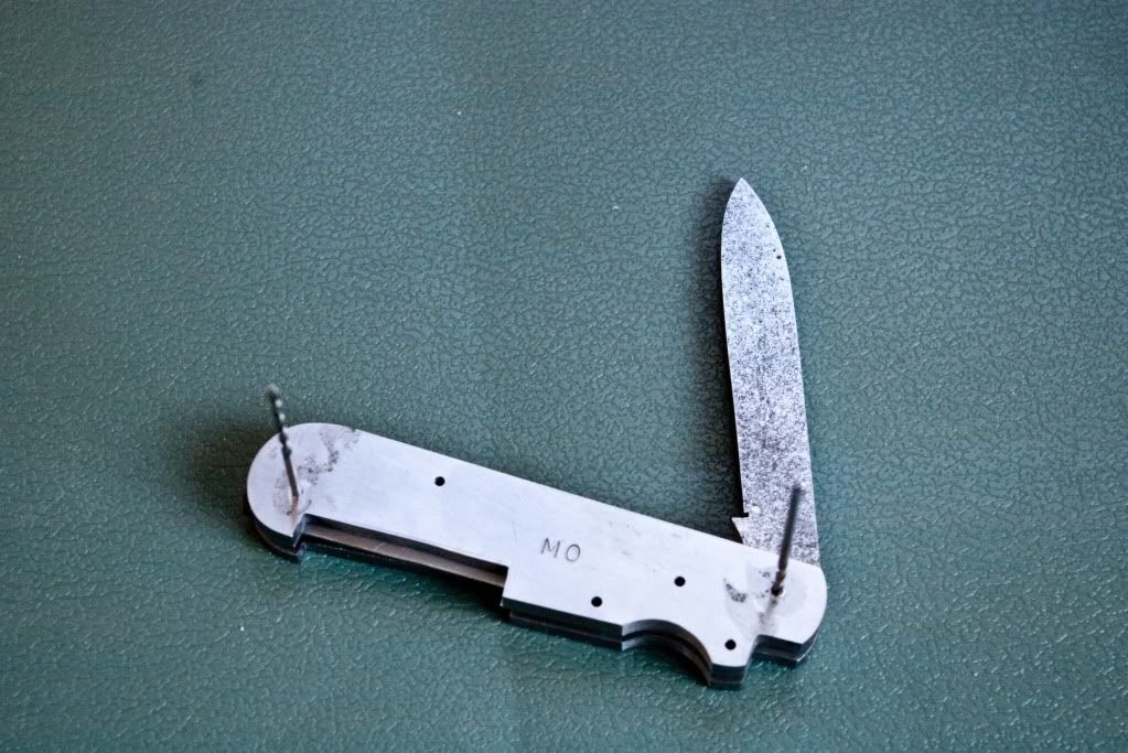

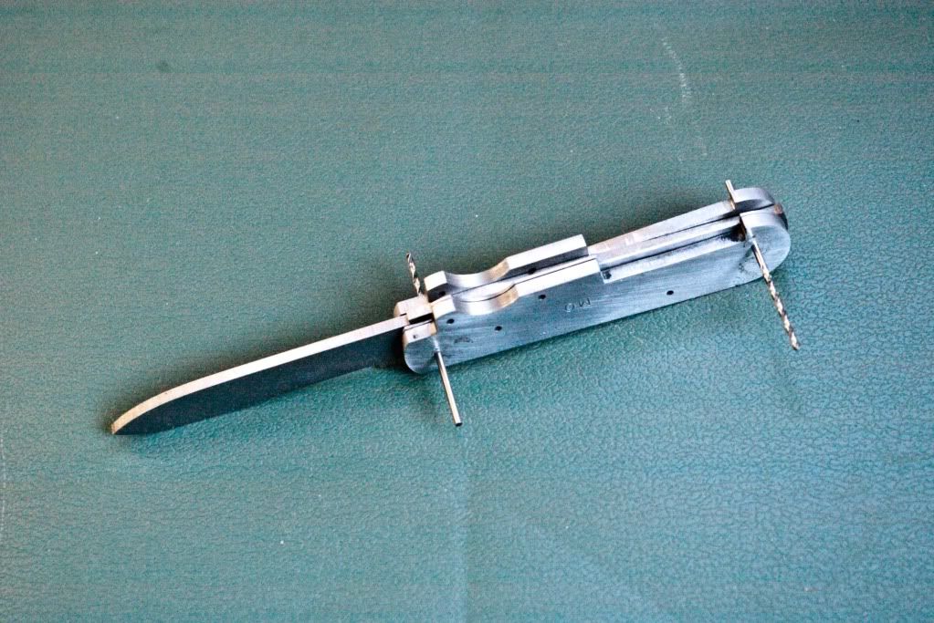

Here are two teaser pictures for a knife I am taking to Blade Show 2012 this june. I had debated about posting any early pictures of this knife. I decided to go ahead for this reason. I think this one is going to be a milestone knife for me. I am sure many folks know what this knife is. More details on that a bit later. It might be fun to guess the maker and pattern number. Keep in mind, this is VERY early on in the build process.

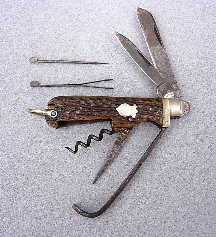

I'm going to guess this new one is modeled after a Joseph Rodger's Sportsman's knife. Seems to have a similarly patterned handle to one of theirs..
Ken, both "Horseman's" knife and "Sportsman's" knife have been mentioned. For the sake of clarity, it's only a "Horseman's" knife if it has a hoof pick (aka "stone hook").
Perhaps this Sportsman knife will look something like this ? (but 2 thick instead of 3)
roland
Similar multi-tool knives with and without hoof picks were all called Sportsman's knives. With the notch in the handle, I supsect that Ken's knife will have a hoof pick. The inside of the pick attachment was flat and had ridges, like pliers. This, along with the notch in the handle, combined to form a nutcracker.
p.s., that is a fantastic Rodgers Sportsman Knife rprocter.

Here is a picture of the Geo. Wostenholm and Son knife I am using as my pattern, along with a picture of my knife along side the knife in the catalog reprint. I just recently purchased the G.W. IXl on the bay, featuring two broken blades, LOL.
This knife features a hoof pick/nut cracker, master spear blade, pen blade, fleam,awl, and cork screw. The catalog reprint is from a 1885 catalog.

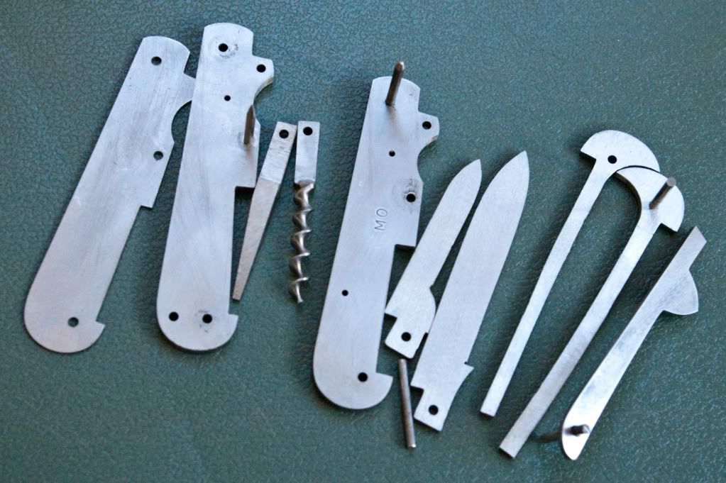

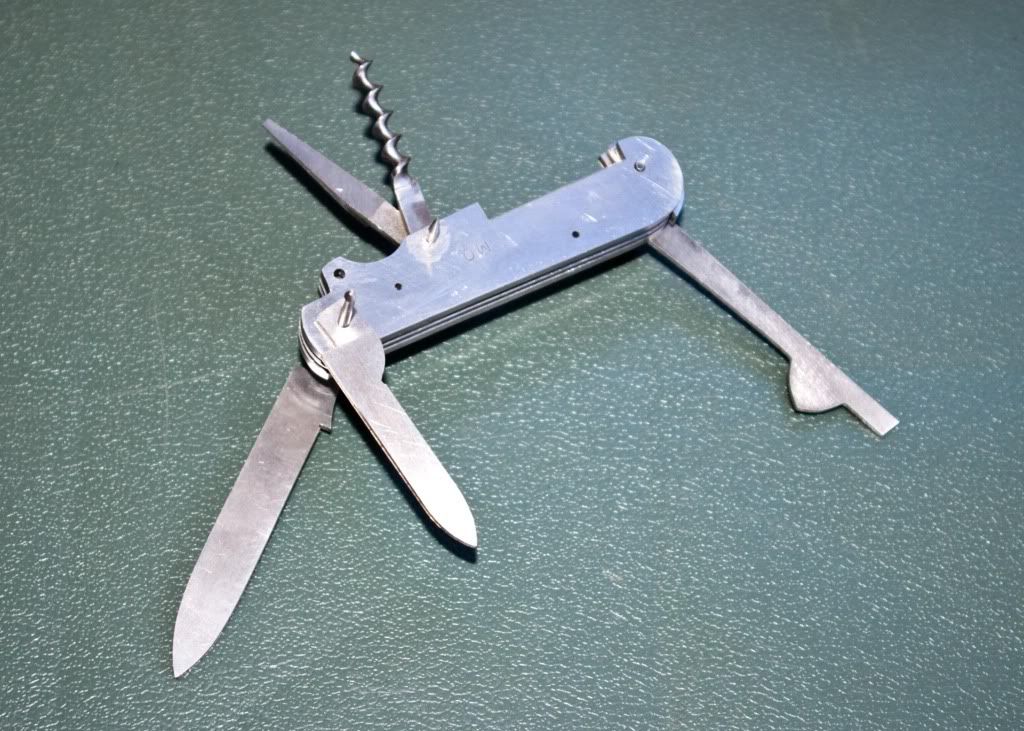

I had a chance to work on the horseman's knife and have made pretty good progress. Pretty happy with my first attempt at a corkscrew. Keep in mind these parts are pretty rough yet , pre-heattreat. All parts are now here except the hoof pick. I ended up not having the right piece of 154cm in stock and had to order it. Should be here middle of next week at the latest.
Everything is going pretty much as expected on this build so far. (keeping fingers crossed). I am not much of a drinker, but I think when this one is done, I am going to have to try the corkscrew out on a bottle of the bubbly;)
Ken, make sure when the corkscrew is closed, the pointy tip points downward. I have a very nice HSB OVB Bottle Opener Jack(likely made by New York Knife Co) in which the corkscrew tip is exposed when closed and it snags on everything.
But, who am i to give you advice ? Almost certainly you have already considered this.
respectfully, roland
