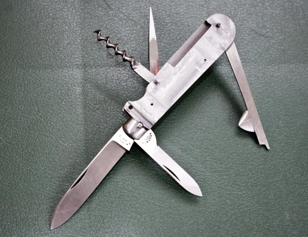

Ken, Wow! Can you share a little about how you shaped that corkscrew?
Jake,
I roughed this out on my belt grinder then used a rat-tail file. I am between lathes right now in my shop. I sold a lathe I was not happy with, own one in storage down in Quincy, but looking for a micro lathe.

Funny you ask Elliott. As I am working on this knife I think of it as one of the original multi-tools/Swiss Army knives! It always amazes me , how we view these objects today as more art than tools, which was what they were,are.
Ken, I was thinking that you must have used a lathe. It's hard to imagine how someone could make something like that by hand! :eek:
Elliot, I think it would look better with my initials on the shield. :p
Jake, I did make this one by hand but in the future I would want to use a lathe to rough out the round sections first.

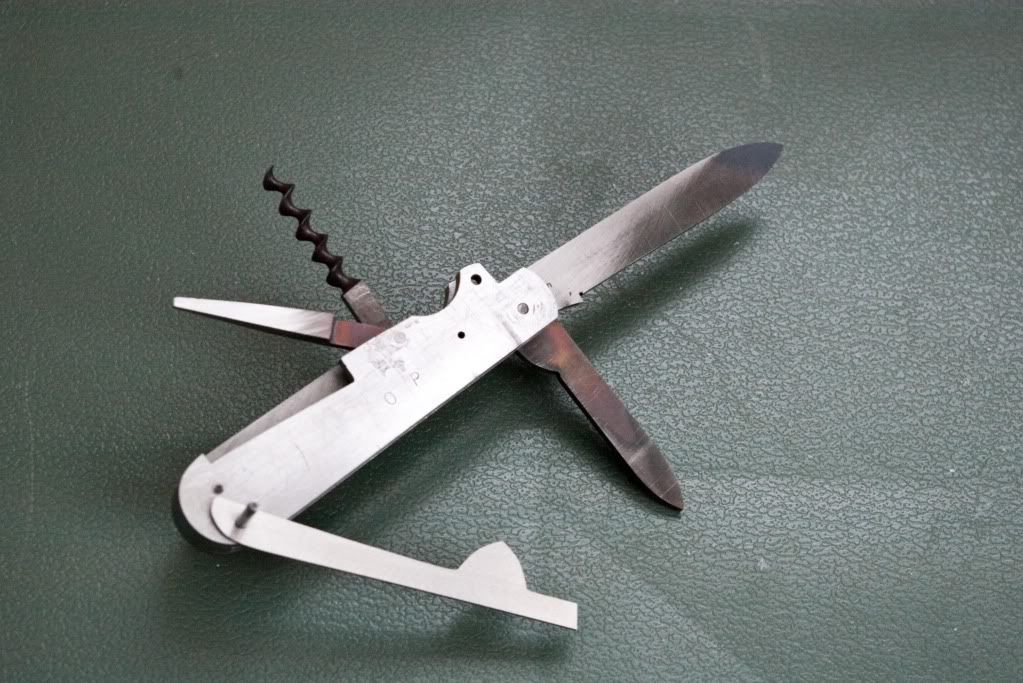

I did manage to get my heat treat done on the blades, fleam, corkscrew and awl. I also fit up the implements with the springs and real happy so far. I still do not have the steel for the hoof pick yet. That is ok though as the hoof pick would be fit last as it is dependent on the cap end of the knife to be finished for proper fit and function.
This picture shows the springs installed and everything under tension.
Lookin' good Ken! As someone who barely has enough patience to sharpen my lawn mower blade, I can't imagine the patience it took to do file that corkscrew.
Did you decide on including some slide out tools?
Mike,
On this one, I am going to keep it pretty much true to the Geo. W pattern I used. I will say this, there will be more horseman knives down the road. I really enjoy this type of build as a change of pace from less complex patterns.

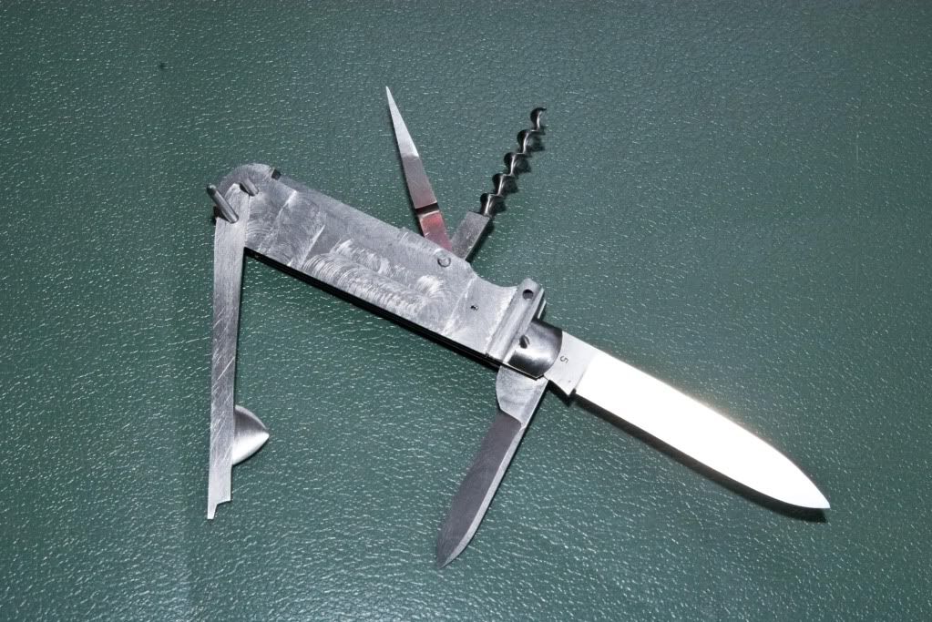

Looking good Ken. Have fun grinding the bevels on the fleam. Nothing says fun like a tapering double grind to a zero edge on a .050" piece of steel. :)
You guys must have enormous patience! I can see me turning that fleam into a glowing puddle in no time!!
I can only imagine how much time you spent doing that corkscrew with no machine tooling, its really coming along! thanks for posting these WIP images.
Every step I take now, gets me closer to seeing a horseman's knife! I have the grinds done, milled the frames/bolsters. Time to start refining things, still waiting on my steel so I can complete the hoof pick.
