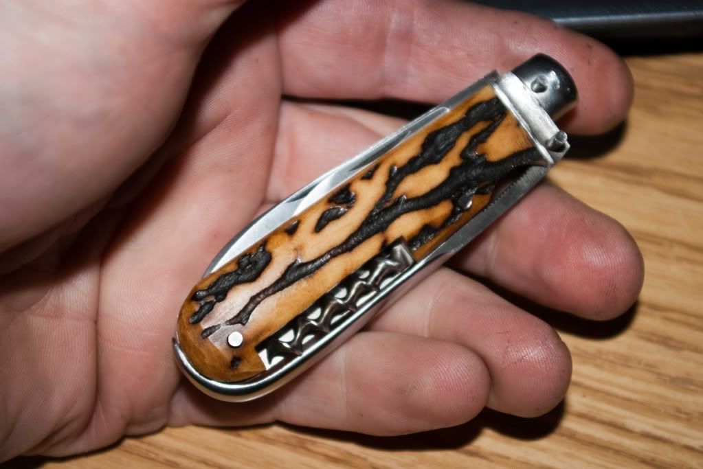

Here is a picture of the stag after a bit of darkening with PP. While confident it would continue to darken, I just really do not like the texture ,openness on this knife. I also ended up grinding too much off the top.
Ken,
I am with you on this one, the pattern on the stag seems somewhat inappropriate on this particular knife.
I find you should always follow your first impulse, it's usually the choice that will work out the best in the long run.
Great knife to be made better by using darker stag with less figure removed from the surface, my opinion of course.
Take care, Jeff

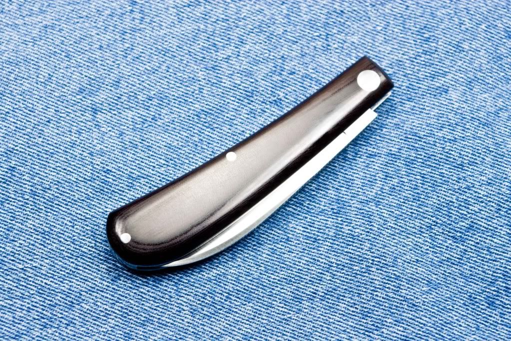

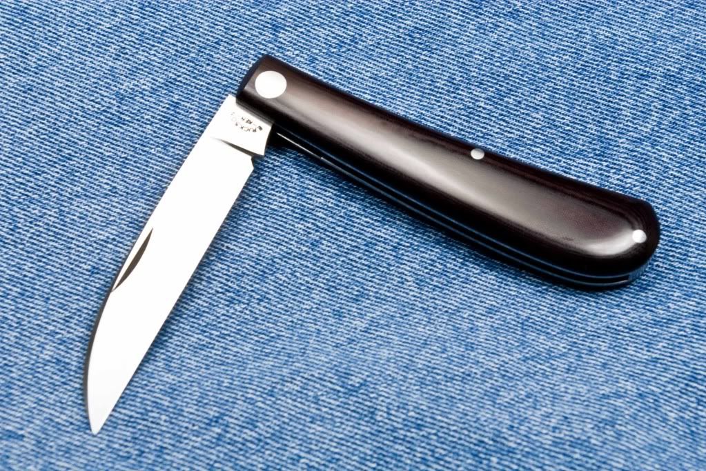

While waiting on stag for the horseman's knife I had a chance to work on knives for Blade Show in June. Here is the first of these, a 3 5/8 shadow swayback in 154cm, burgandy G10.

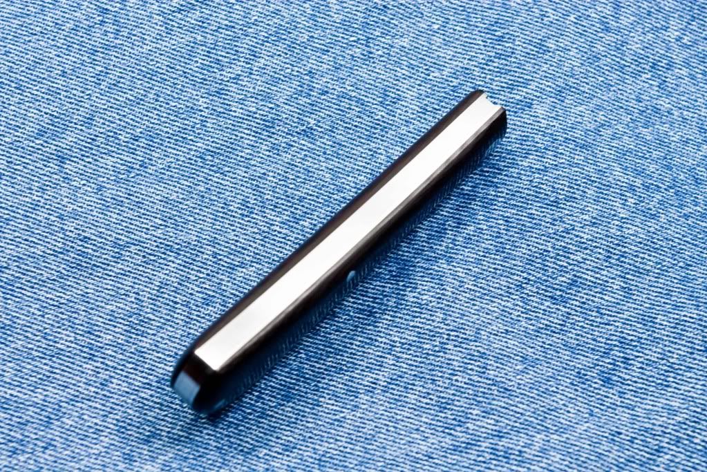

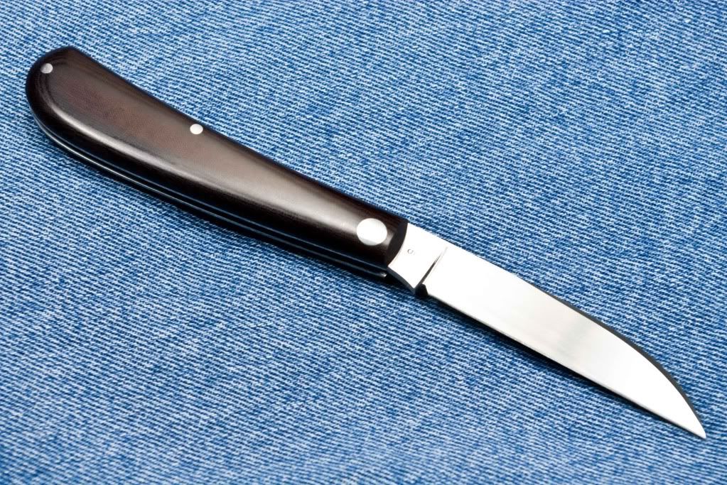

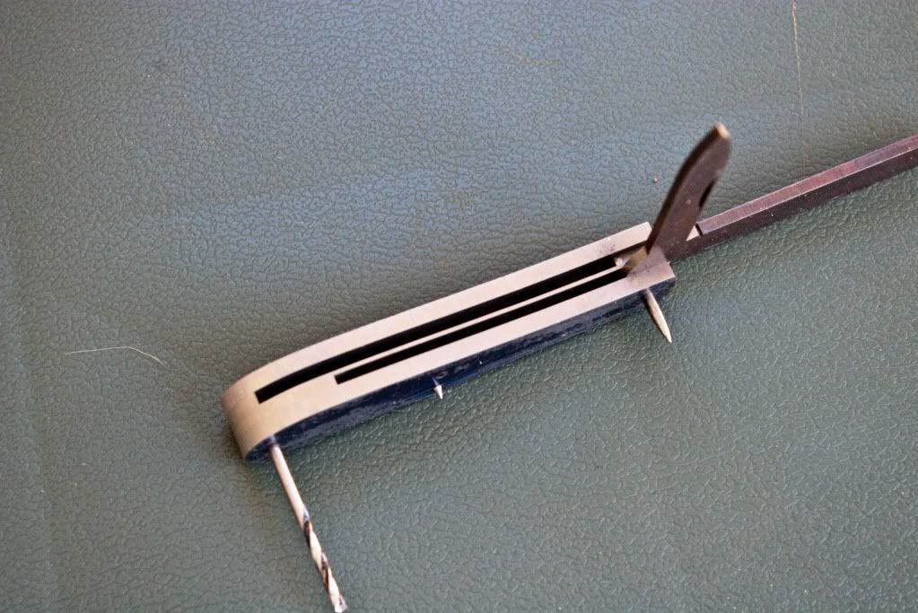

Here is a knife I also have on my bench at the moment, being built for a BF member. I am excited about this build. This is a slightly longer than 3 1/2 Eureka jack. This will be my first Eureka jack, although I have made a couple of cattle knives based on the Eureka pattern. This is just a cool pattern all the way round, from the curves , to the slender pen blade with hidden kick , wonderful swedging, fine long pull on the master, rat-tailed/threaded bolsters and great bone. The biggest departure from the Carrier is the extension spring for the pen blade. We have not nailed down the shield as of yet. Here are a few pictures. This little knife really has it all! Comments more than welcome.
