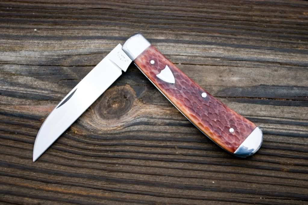

The lighter color gives the bone a "lively" look! Nice knife!
That's a great looking Swayback, Ken. I like the color of that bone a lot!:thumbup::thumbup:
Ken, I like this one a LOT. Great pattern, great choice of shield for the pattern and beautiful color dye and jigged bone. I hope you plan on using that dye and jig pattern again. ;)

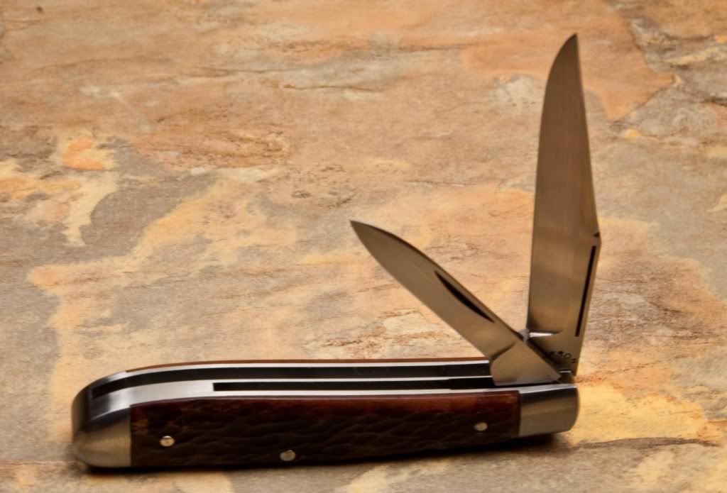

Here is another swayback going to Blade Show. This one is on the opposite end of the spectrum of the Micarta swayback. Bolsters, shield, my jigged bone. The bone on this one is a bit lighter and with more variations in color. 3 5/8 inch, 154Cm.

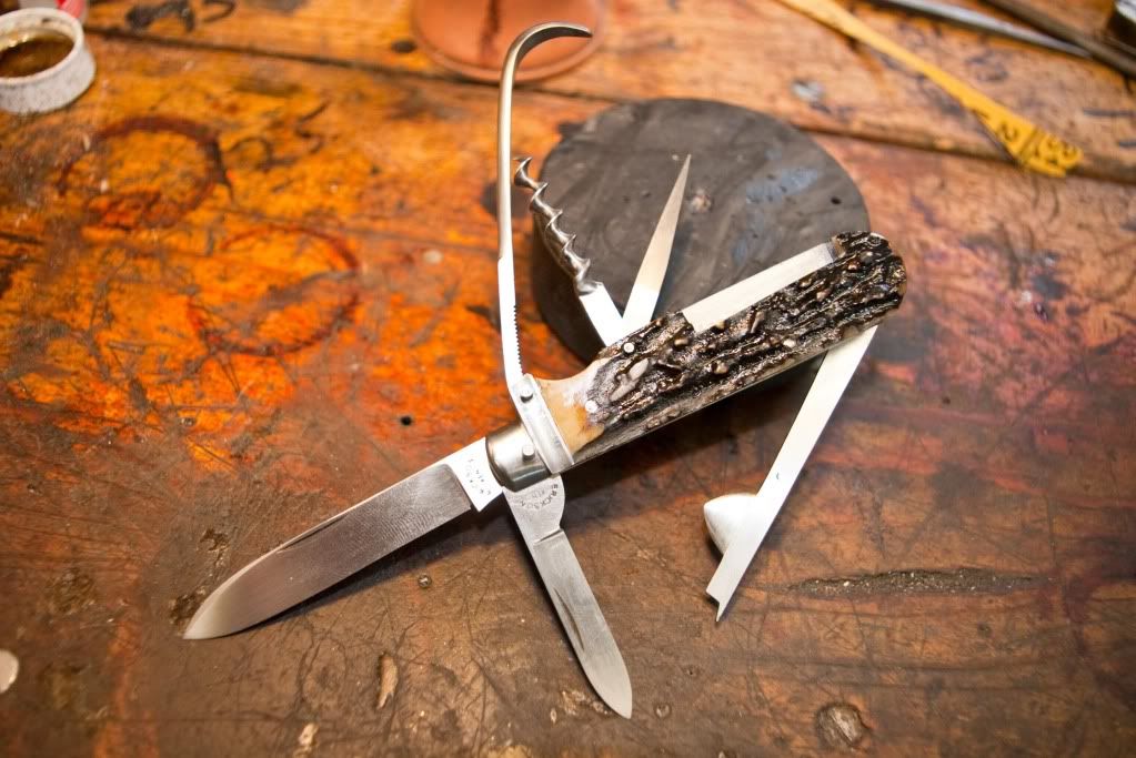

I had a chance to rescale the horseman's knife in some stag that I like much better. I started to refine and finish the parts:eek:, I am going to be hand sanding for a week on this thing. There are just a ton of parts and surfaces that have to be finished, much respect given to the men, women and children that worked in the finishing departments when these knives were being made in quantity.
Hey Ken,
These scales really do that knife justice, there fabulous! When I think about all the work necessary to finish this piece I get tired and my
fingers are aching in sympathy. This is a tour de force of your knife making skills, great talent combined with a passion for your work.
Looking forward to our next project...
Jeff
Just too cool Ken. I would really like to see both edges of this knife. The fleam tucks into the stag? No spring...I guess? Uhhhh.....what's next on your list of impossibilities? Put this one under glass at Blade. Congratulations.
John Lloyd
Thanks for the kind words guys! I will post a full set of pictures when I finish it up this week. Should be around Wed.

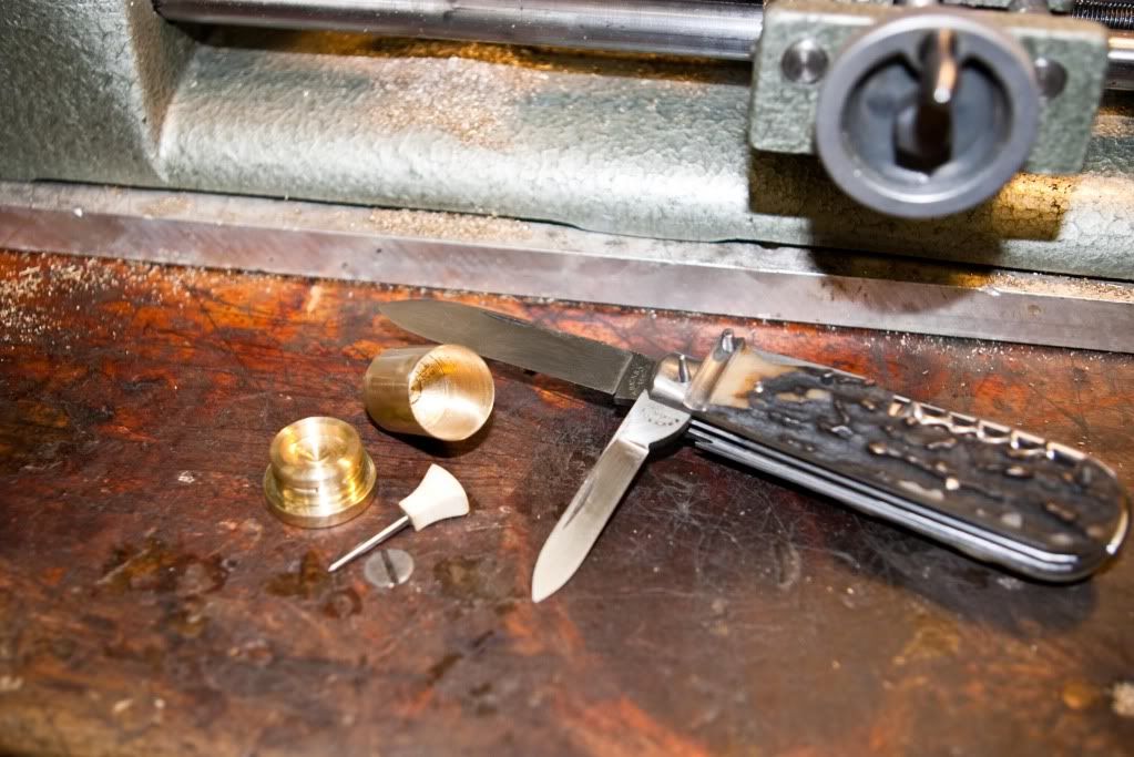

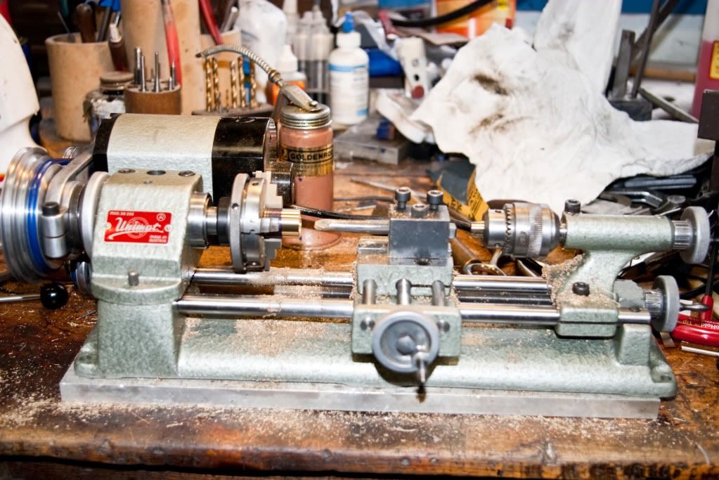

I normally try and stay out of the shop on Sundays but just had to go out and play with my new micro lathe. My intentions is to make a desk top fitted display case for the horseman's knife and thought it would be neat to include a oil bottle. I machined this in a few hours today, totally out of bar stock. The bottom/base is retained and sealed by a 11/16 dia. o-ring. Base and body are brass, with a tapered stainless steel stopper capped with Mammoth ivory. The stopper can be used to pin point a drop of oil at the joints. A fun Sunday afternoon project.
Ain't CREATIVITY great! These are the things that bring life to a project like this, that added touch, that truly raises the
bar to the exceptional! Terrific work, fine execution, adding another layer of complexity to a wonderful "pocket knife"!
Keep them comin', Ken

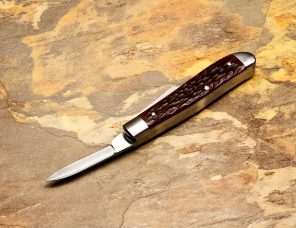

Here is a peanut just finished up(not available) that is based on a Remington peanut. The Remington features a sabre ground master and square bolster. I made my knife with a few minor changes, a sweeping cut swedge compared to the very square cut Remington, an extension spring for the pen blade and just a tad fuller blades and frame compared to the Remington. This knife is 2 7/8 closed featuring CPM154cm blades and springs.
Now there's a peanut! Awesome Ken!
Thanks Gary! I have resisted building a peanut until this knife came up. It is so easy to mess up the proportions on these little knives. When I was presented with the Remington I knew it was one I was interested in building. I was also asked in the spirit of keeping the cost down if I would build it as a single blade. I am really glad I was able to work things out and was given the go-ahead to build it as a multi-blade as the original Remington.
