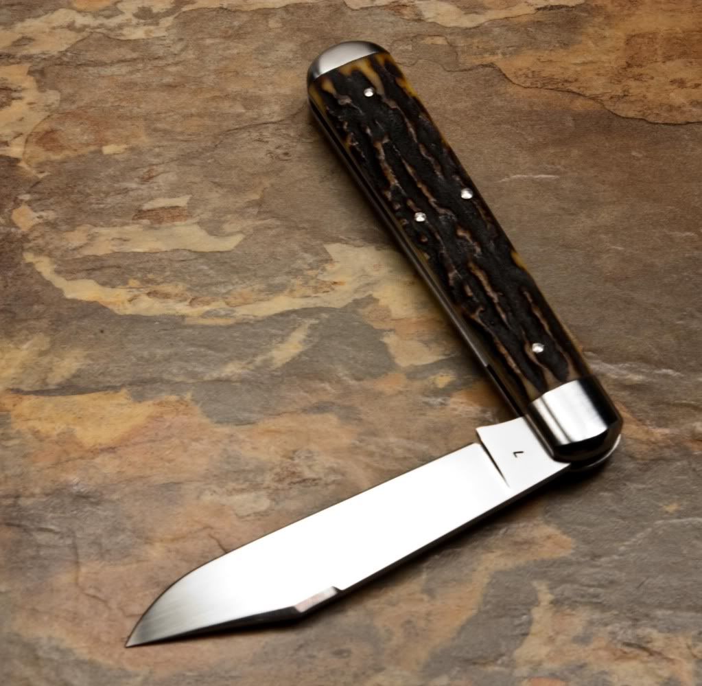

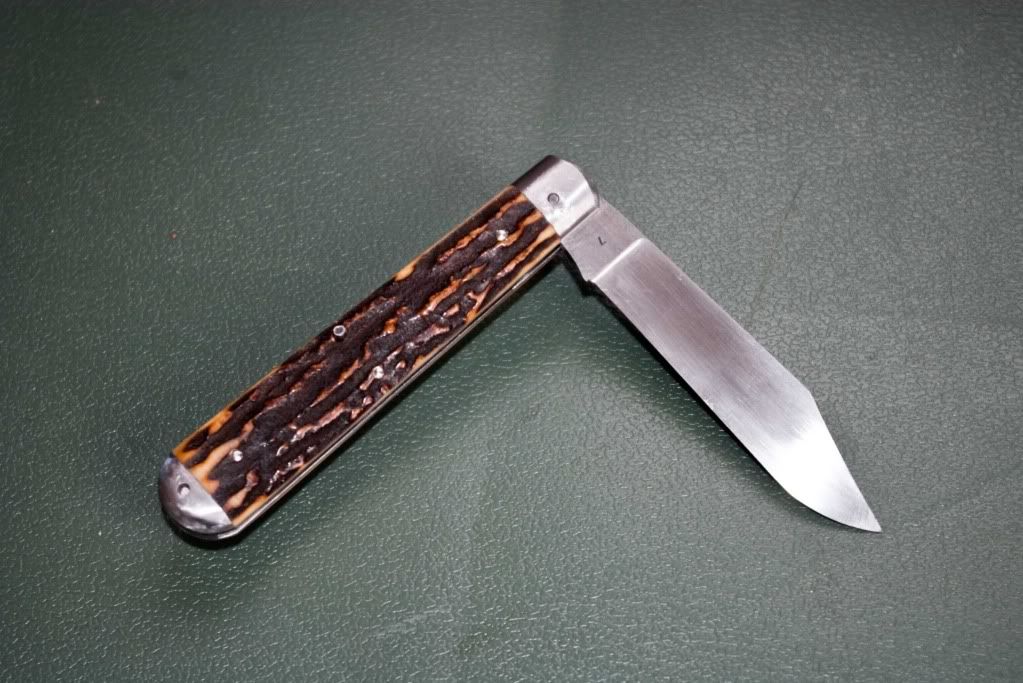

Had a chance to fit the scales. I am real happy with the stag. The amount of bark left, the thinness, has a nice vintage look which I think reminds you of the Sheffield and German knives from the turn of the last century.
That's among the best stag I've seen you use, Ken, and as you know I really like the Jr. Michigan Pen.
You have "Little Mester" blood running through your veins, Ken!
A beauty in the making!

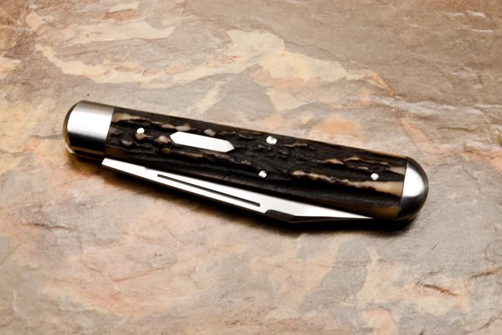

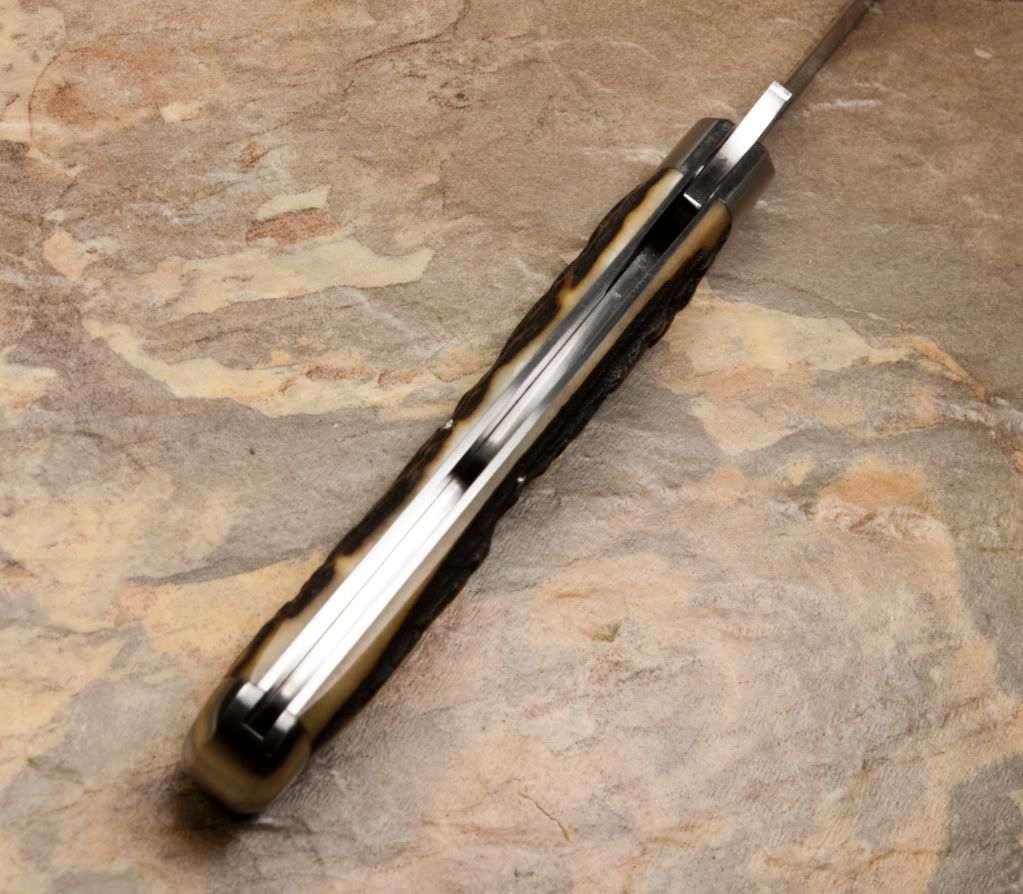

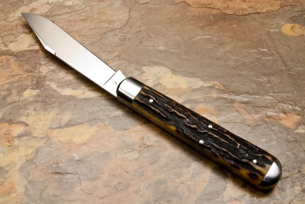

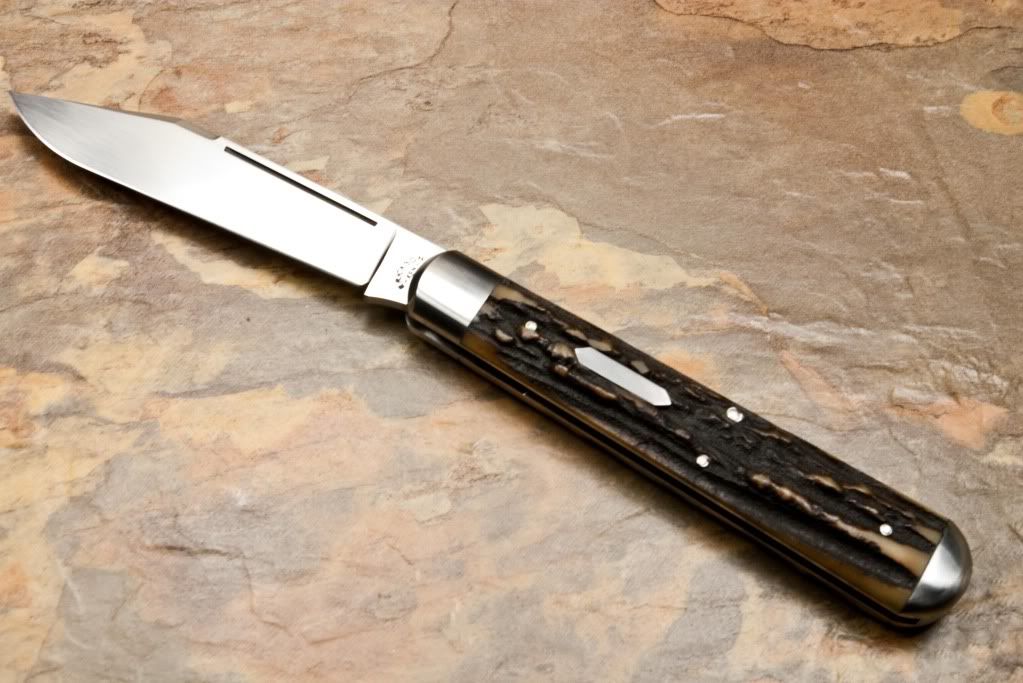

Thanks for all the kind comments on my "JR Michigan Pen". I had a chance to complete the knife today. Real happy with my first bushing install. REALLY happy with the stag on this knife.
4 1/8 closed
CPM D2 steel
Integral 416 frame/bolsters
Half-stop
Bronze pivot bushing
Flat grind, cut swedges
