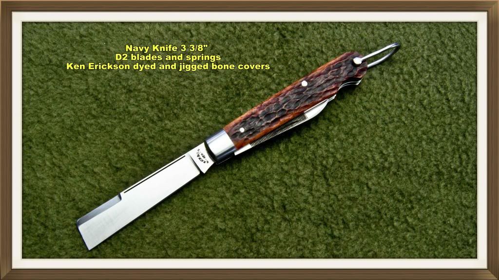

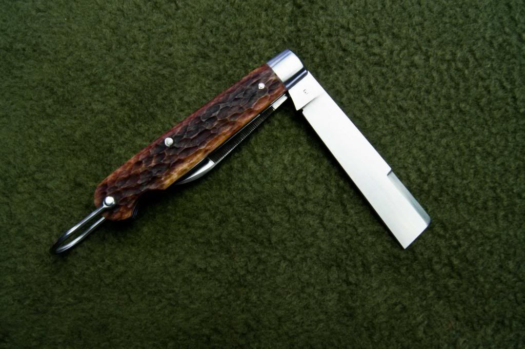

I finished up the second knife in the Navy Knife series.
These knives were a blast for me to make, thanks Charlie for the opportunity!

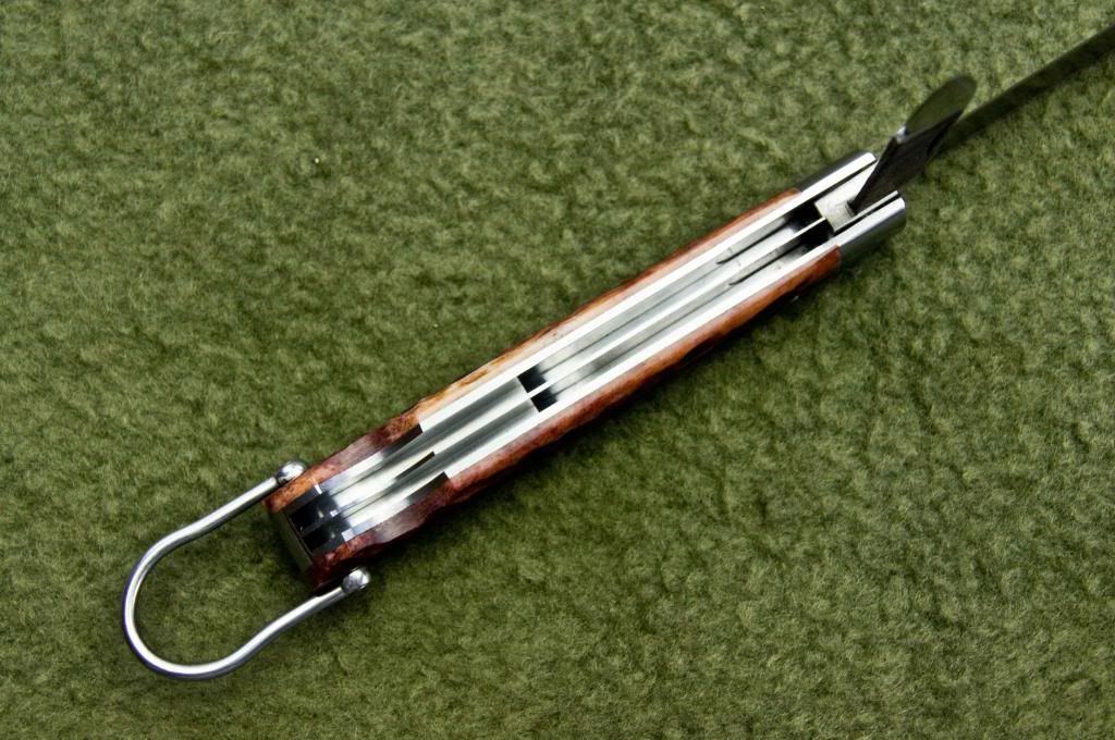

The second knife features my dyed and jigged bone along with a bail. Making the bail presented its own challenges. The bail is made from 416ss. No forging was used to accomplish the "eyelets" that the pivot pin passes thru.
Great knives Ken! I love the jigging on that bone!
