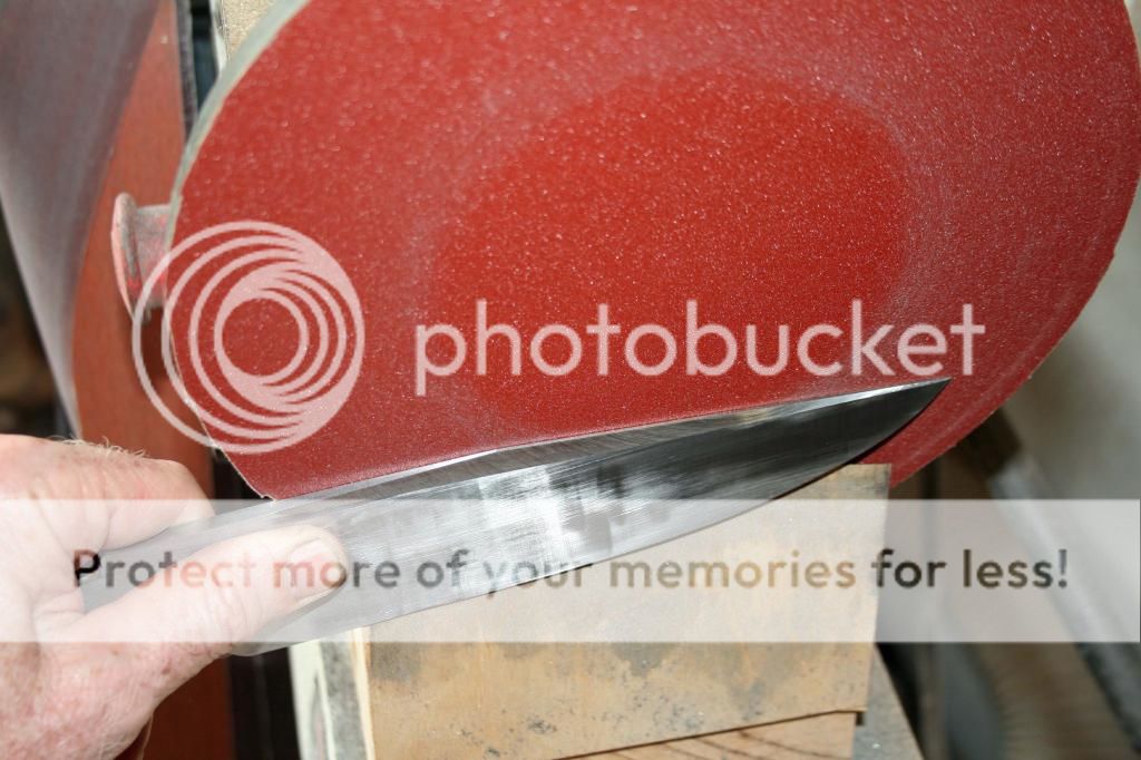

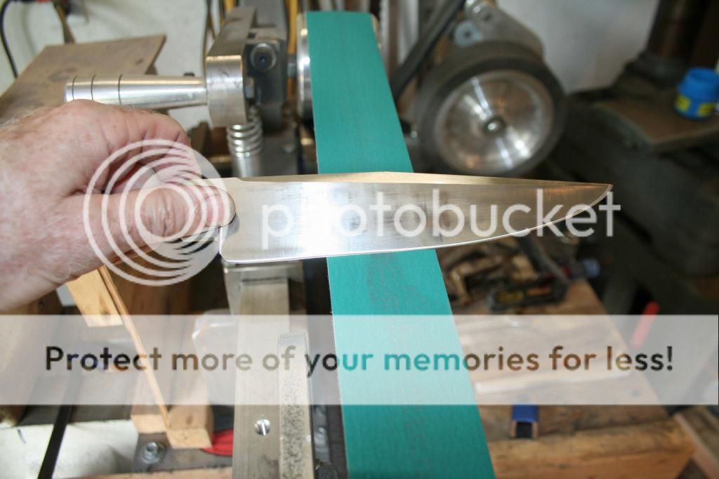

Next I go to the disk grinder to cut the clip. My power source for my KMG and disk grinder is a variable speed wood lathe.
I’ve made a simple blade rest out of wood to assist in this process. I like using the disk grinder for this because you can grind the entire length of the clip at one time and keep the cut in the same plane. I start off at 80 grit then finish with 120 grit. The rest of the sanding is done by hand when I finish the knife.

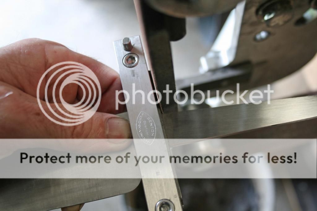

Next I square up the back of the ricasso by putting the knife in my carbide faced file guard and cleaning it up on the grinder.

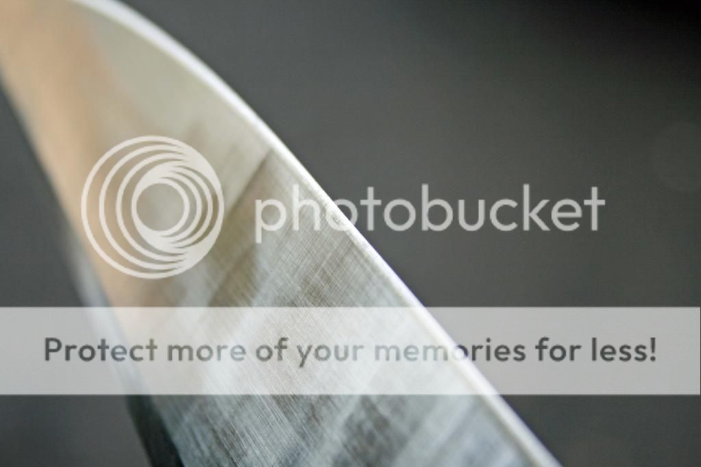

Then I feather in the cutting edge.
Then I do a quick test of the edge.
The edge looks good.

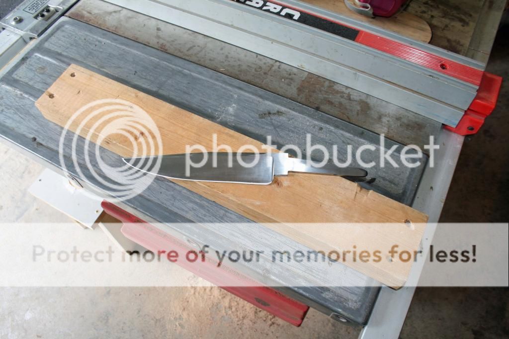

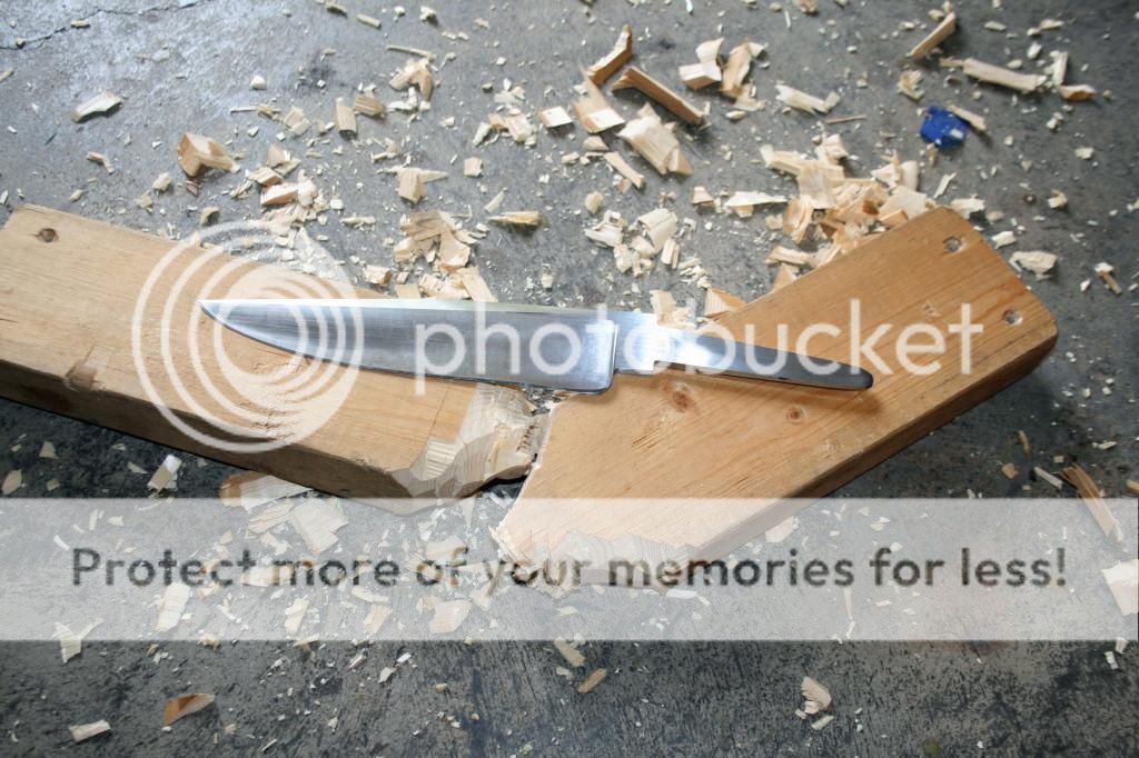

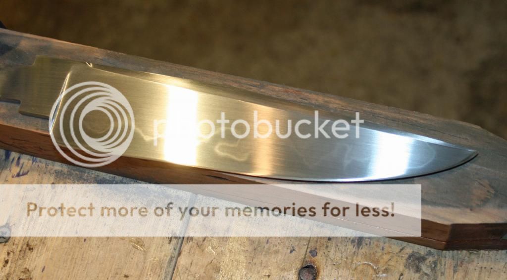

Then I begin the process of hand sanding. I start with 220 grit, if I have a few deep scratches I will go back to 120 grit. I have a tapered 2x2 that I clamp the blade on for this process.
After sanding with 220.

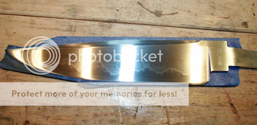

Right side of the blade at 1000 grit
Left side

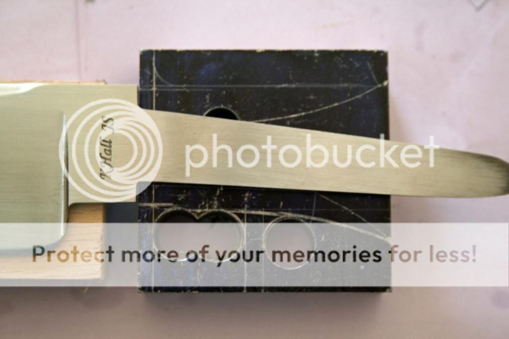

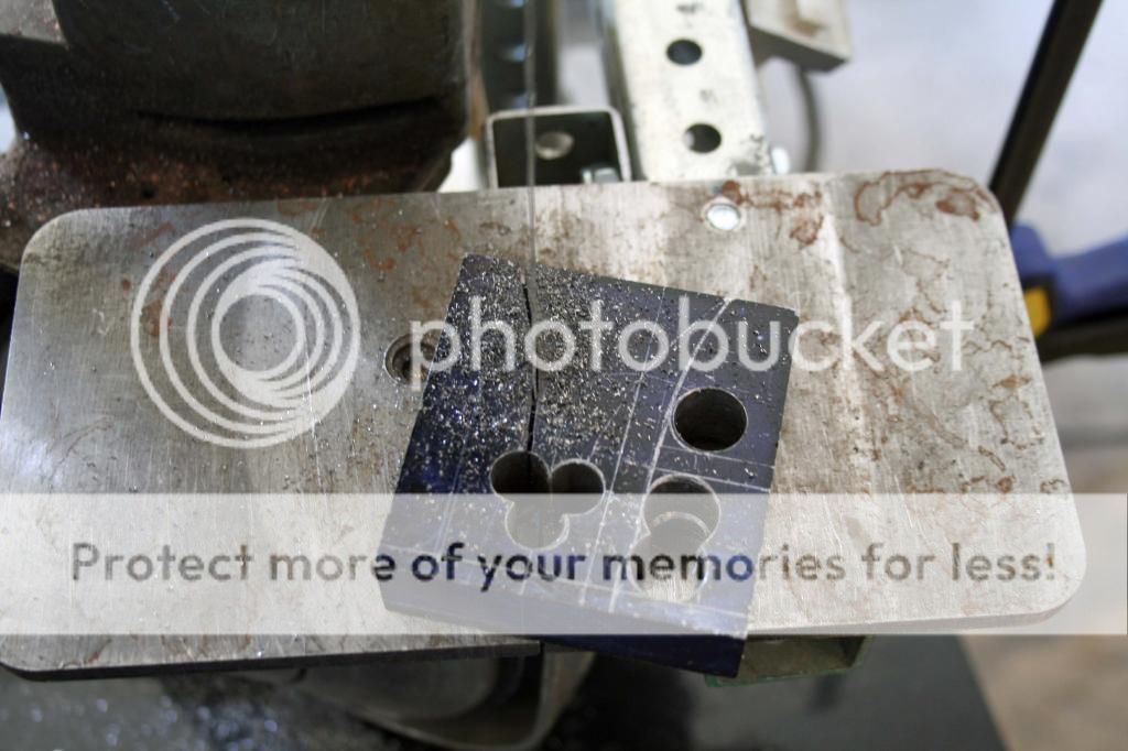

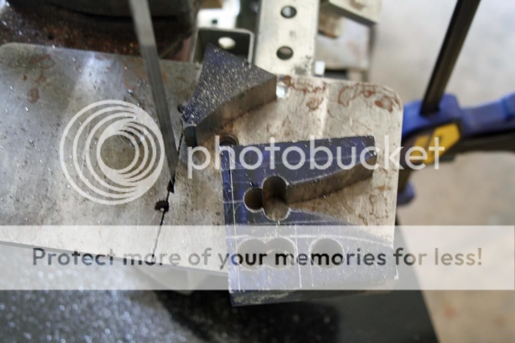

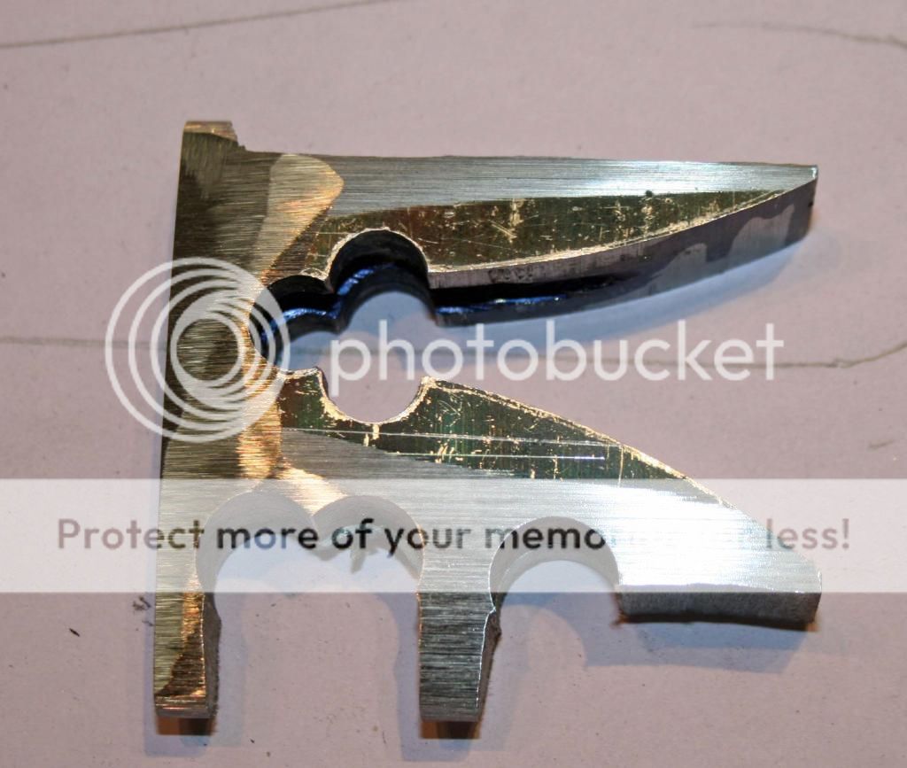

With the blade completed, it’s time to focus on the keyhole. I begin by marking the tang on the keyhole block.

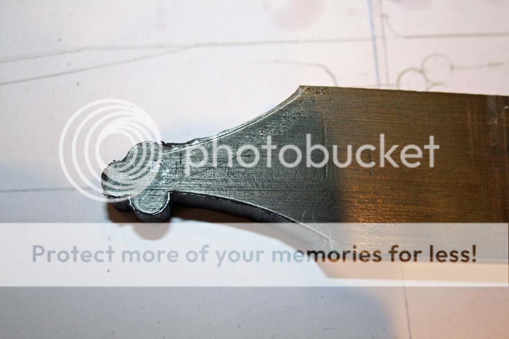

Next I cut out the keyhole with my porta-bandsaw.
When I clean up the cut lines on the grinder.

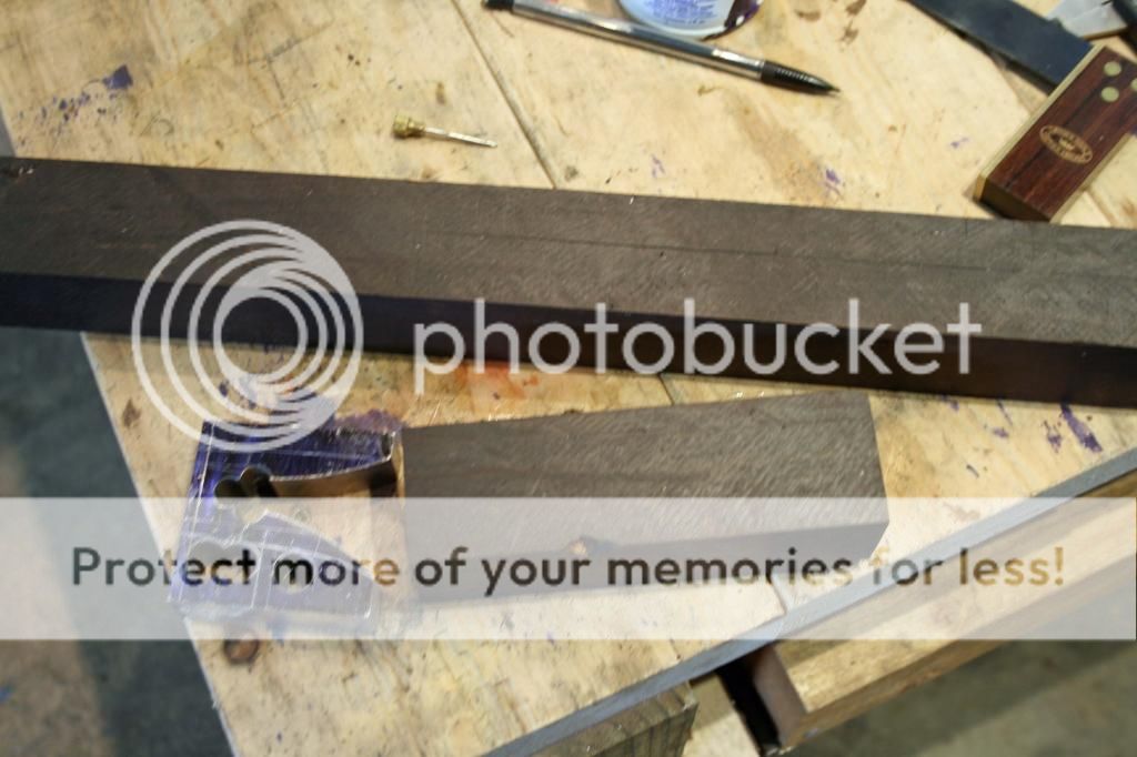

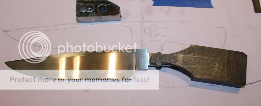

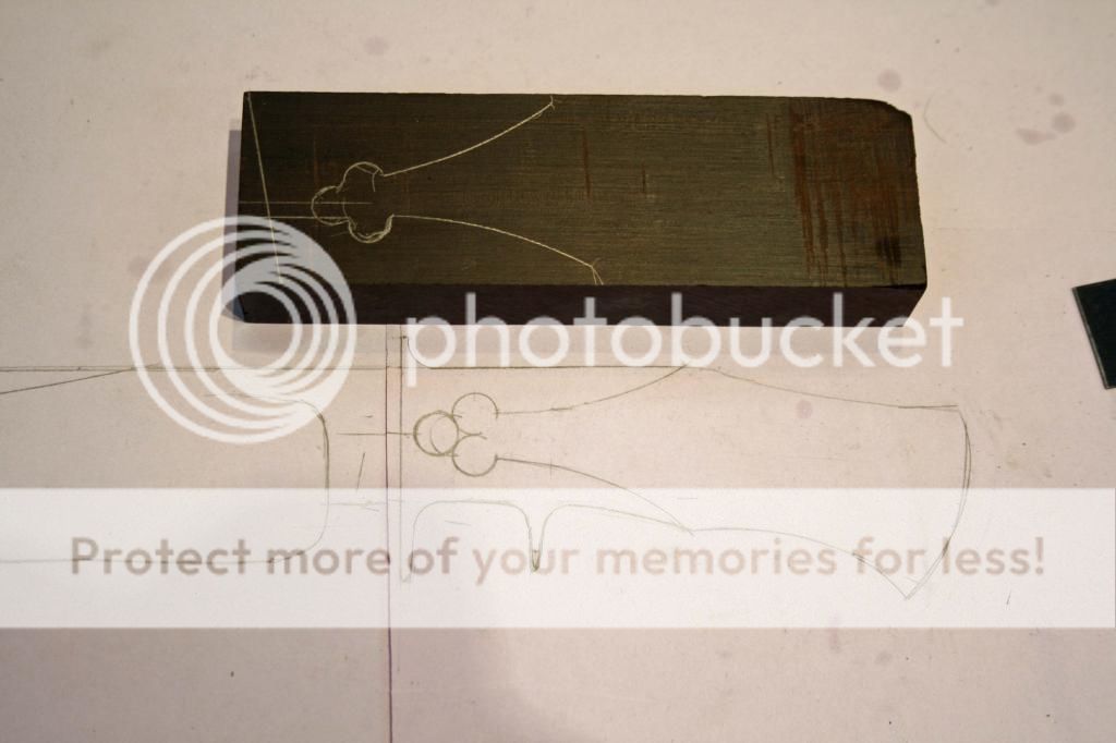

I am going to make the handle from African Blackwood.

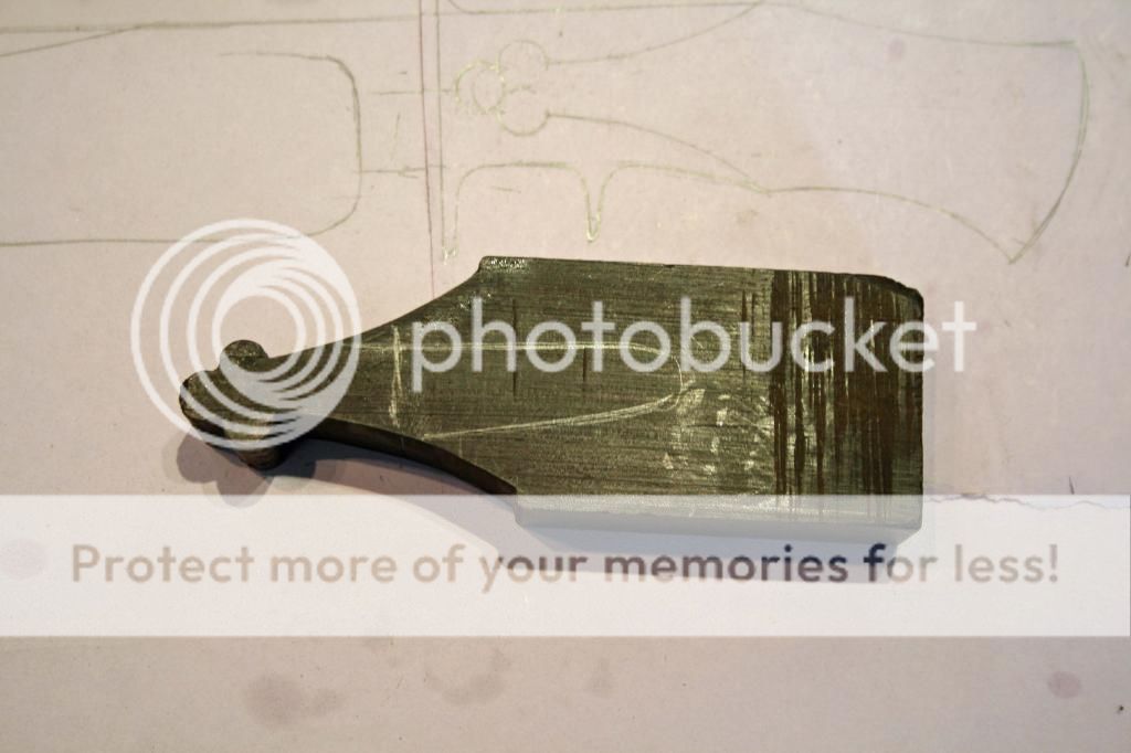

Next I mark out the keyhole on the Blackwood. I clamp them together so they don’t move during mark-up.
Next I go to the wood band saw roughly cut out the design.
Then I go back to the grinder and clean-up the band saw cuts.

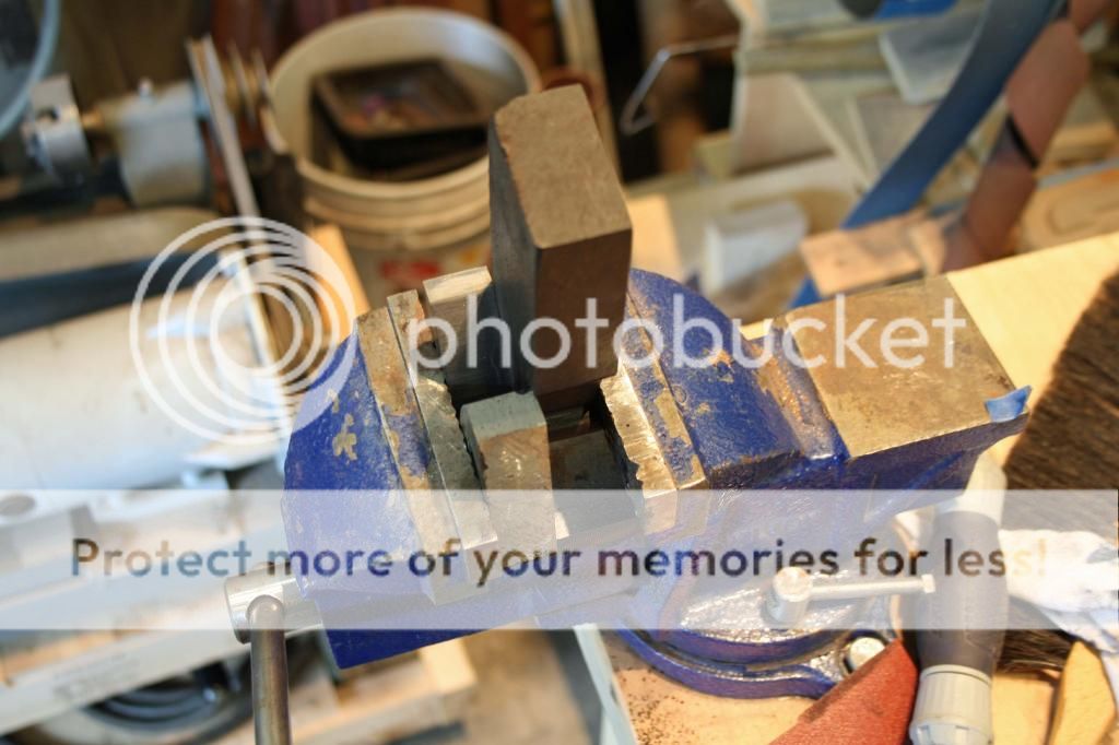

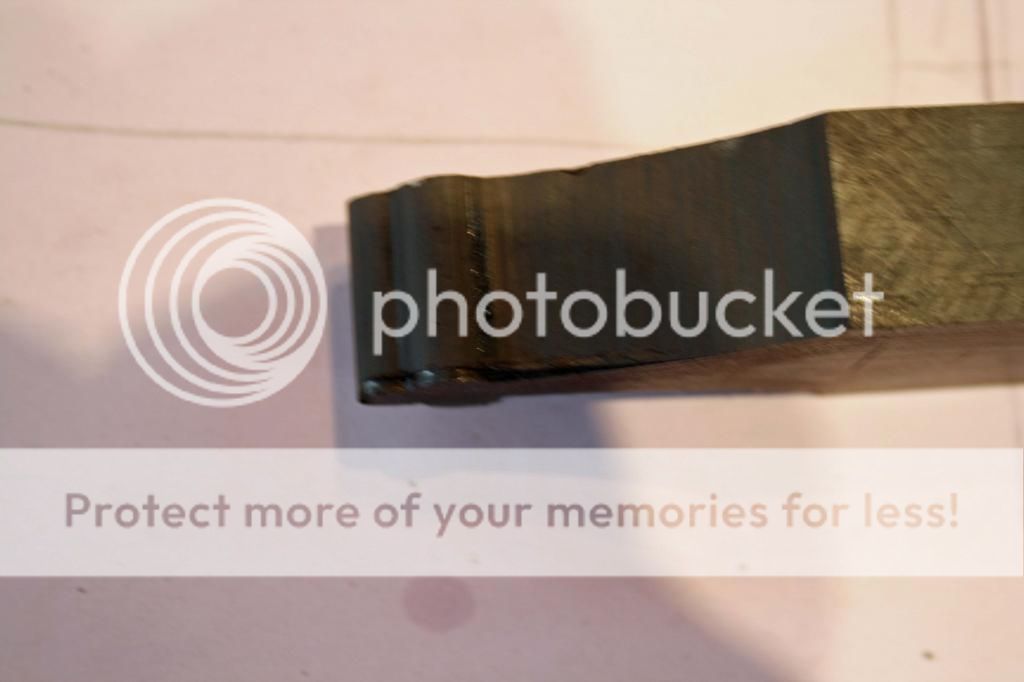

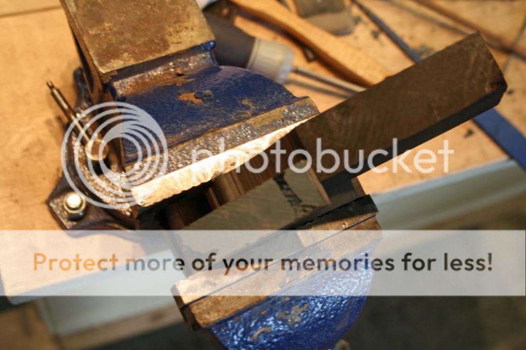

Next I begin the process of pressing the handle into the keyhole. I do this with my vise. I only press about a ¼ of an inch.
This gives me a more defined line to grind to. I carefully grind off a little more material. Then I go back to the vice and press the handle all the way in.

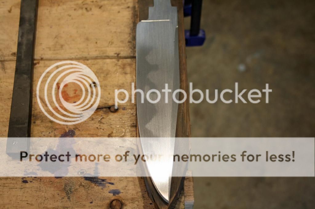

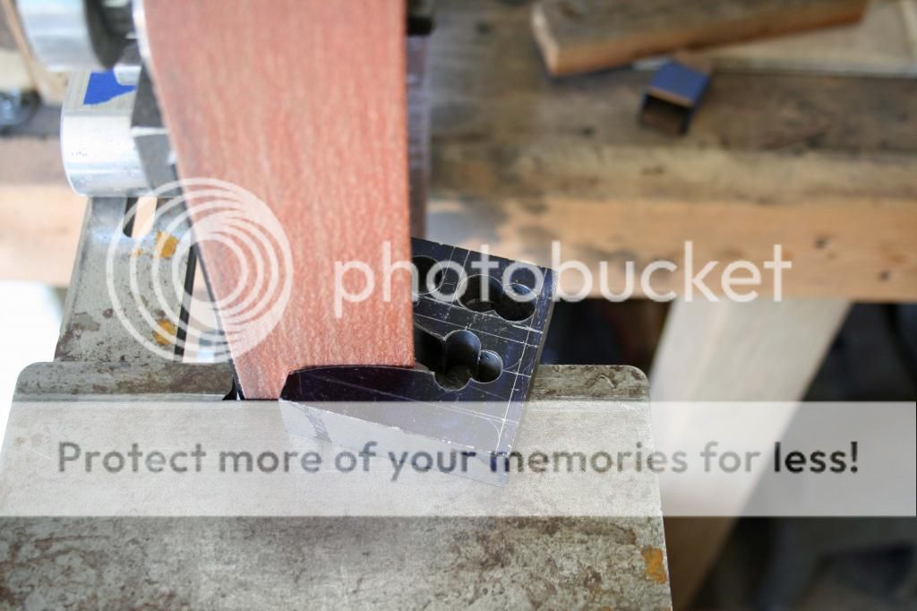

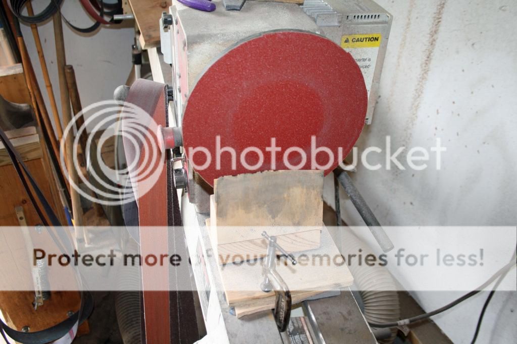

Here is another shot of the grinder without a belt.
Nice !! What speed do you run the belt on your plunge platen ??
Metalmole,
I run the grinder at a very slow speed. Tracking can to challenging and some times the belt does not want to run. There is a lot of drag going over that edge. Sometimes I even pull the belt by hand. You have to be careful not to cut to much, because you just want to clean up and even-up the plunge line.

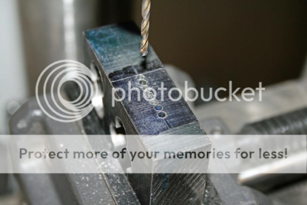

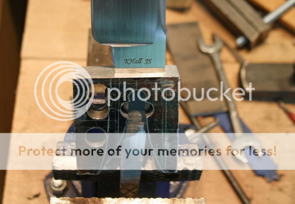

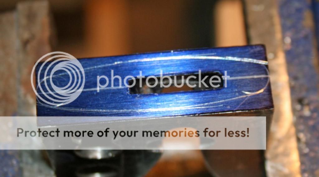

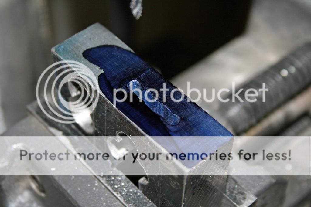

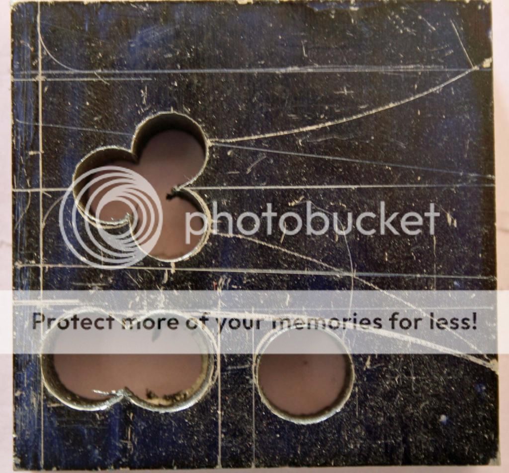

Now begins the work of cutting the tang hole in the keyhole guard. I mark a centerline down the face of the guard and mark the width of the tang at the guard and then begin drilling pilot holes (3/32) along the line.
I then go back and drill the hole closer to final opening size needed. Then I used an end mill in my drill press to cut out the webbing between the holes.

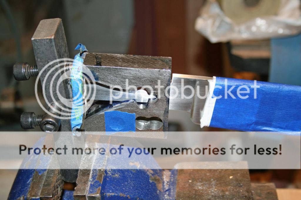

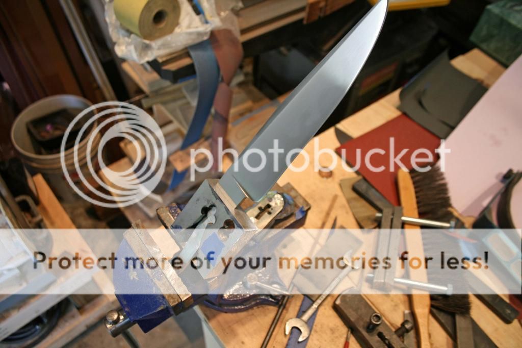

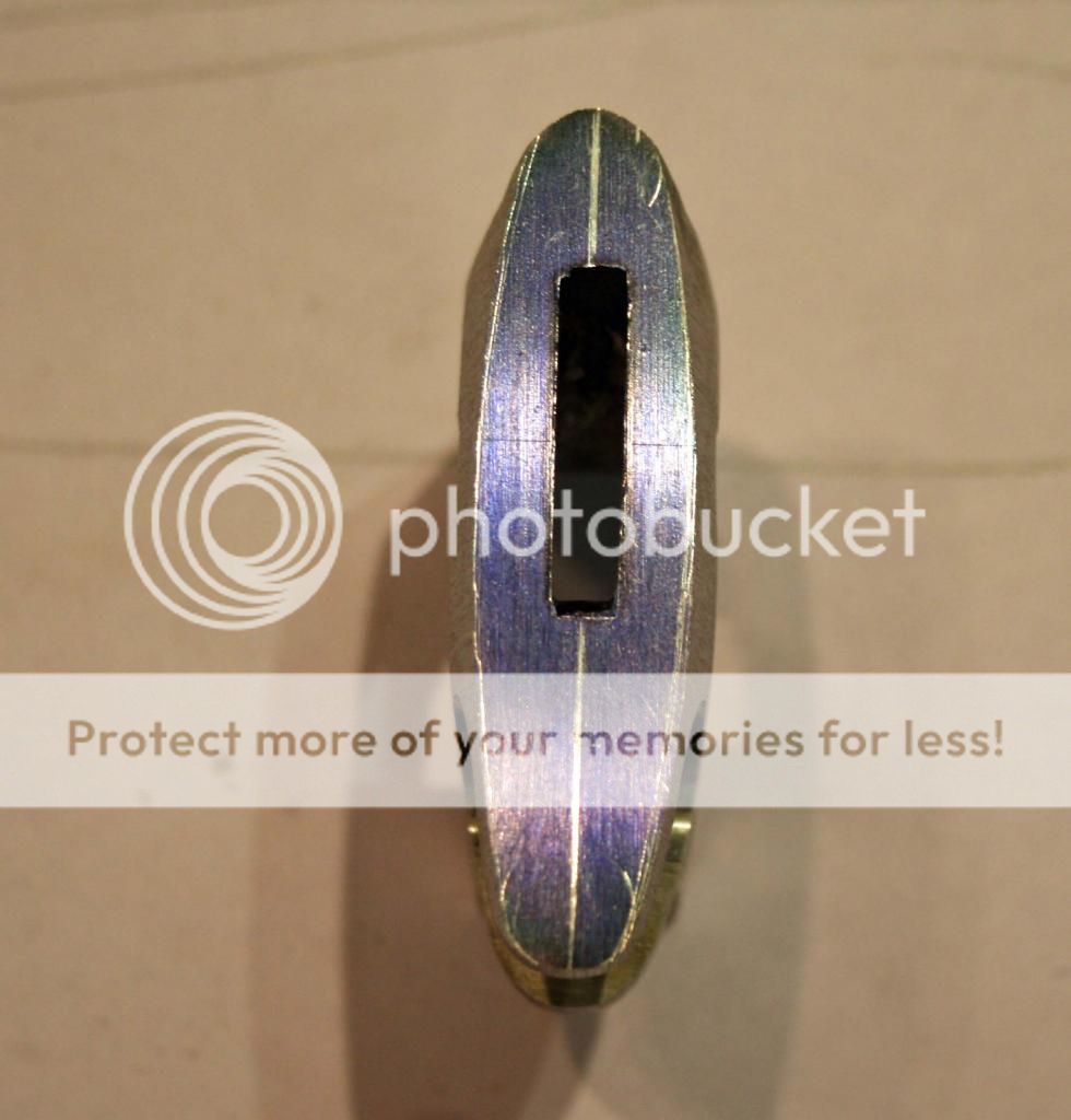

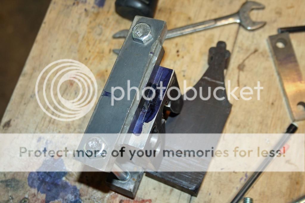

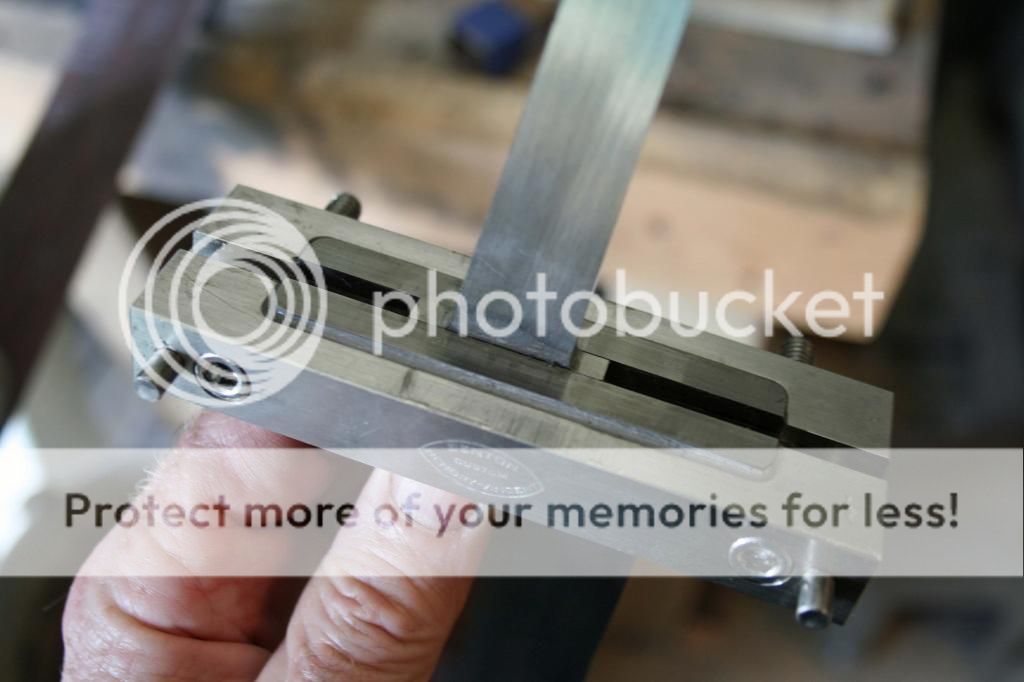

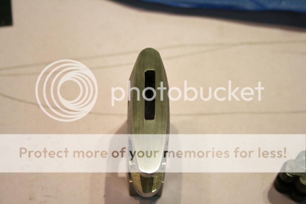

Then I begin the long slow process of filing the hole to final size for the tang. I have a file guide the I made that can hold the 2.5” keyhole block.

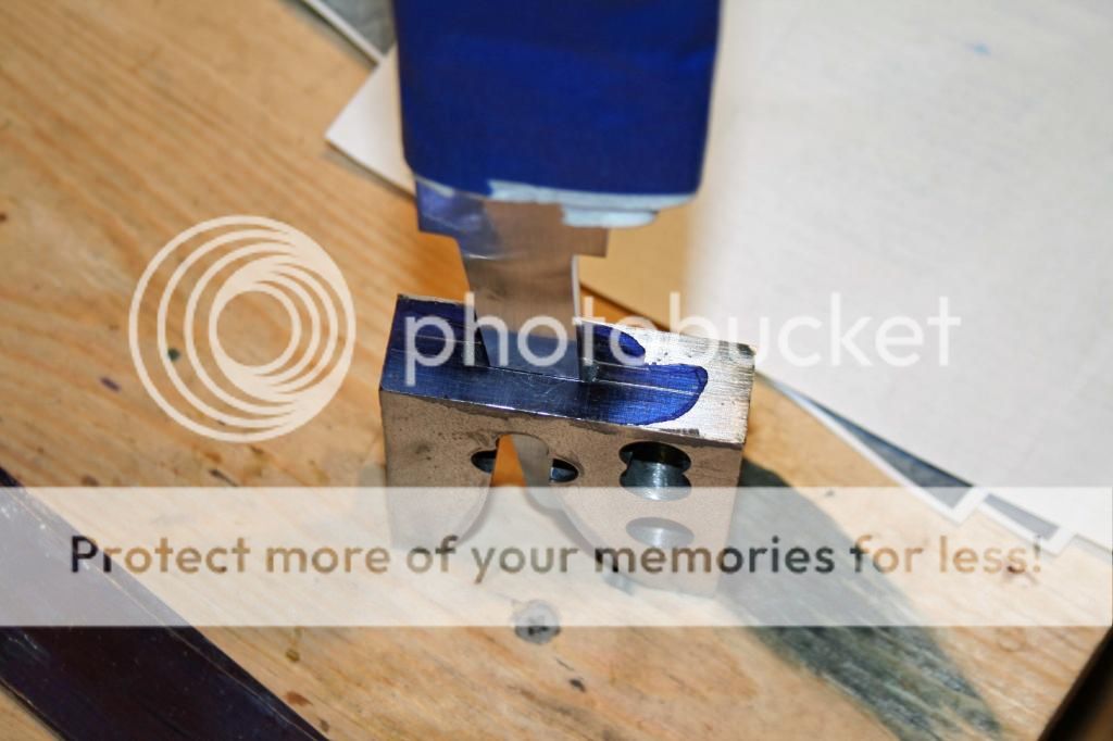

Here is the first test fit.
Once it is close to final fit, I use my press fit jig to force the fit so I can find the high spots to file off.
Here are a couple shots of the final fit.

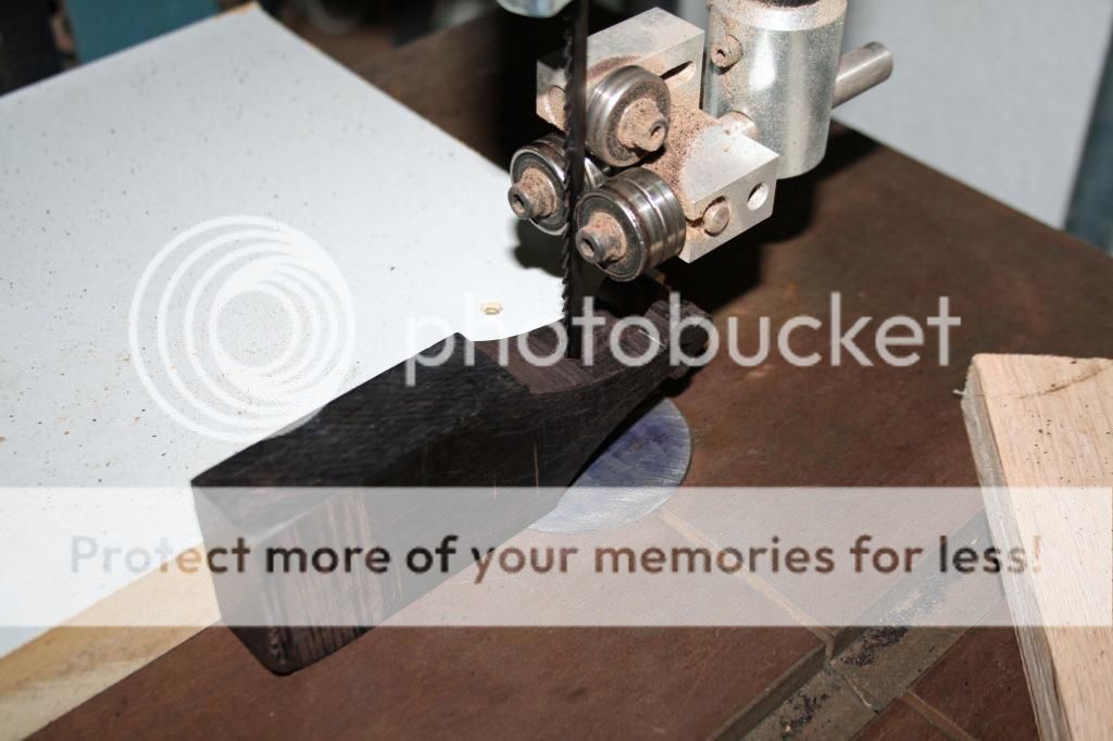

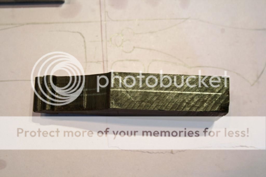

The next task is to cut out the space for the tang from the handle block. Here are two pictures of the marked up handle block.
Next using the band saw I cut the center out of the upper part of the handle block.

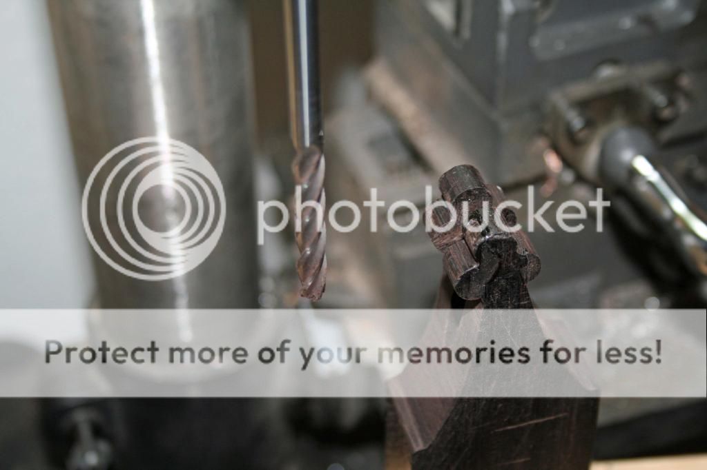

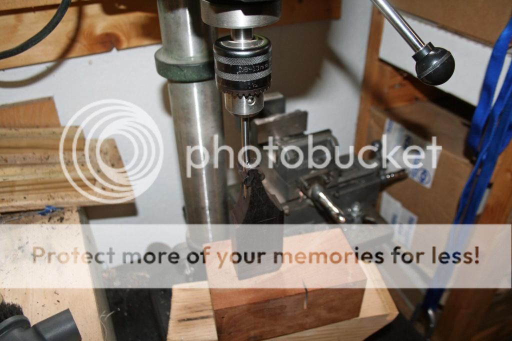

Next I use the drill press to bore a hole each side of the tang slot.
Next I use a 6” long ¼”end mill to cut out the material between the two holes.

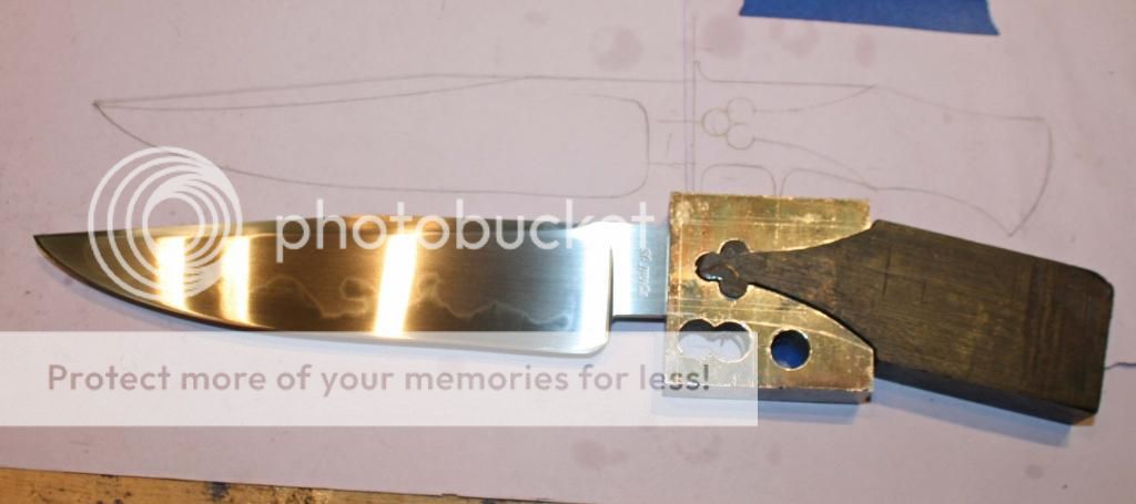

Then I check the fit of the tang in the handle and then the fit of the knife, keyhole and handle.
Next time I will begin shaping the front end of the guard and epoxy everything together.

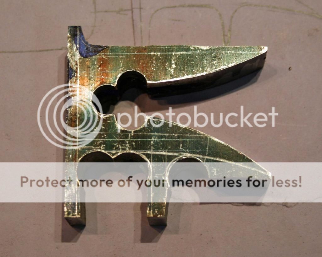

I started by marking out the shape of the face of the guard. I use a circle template and a French-curve.

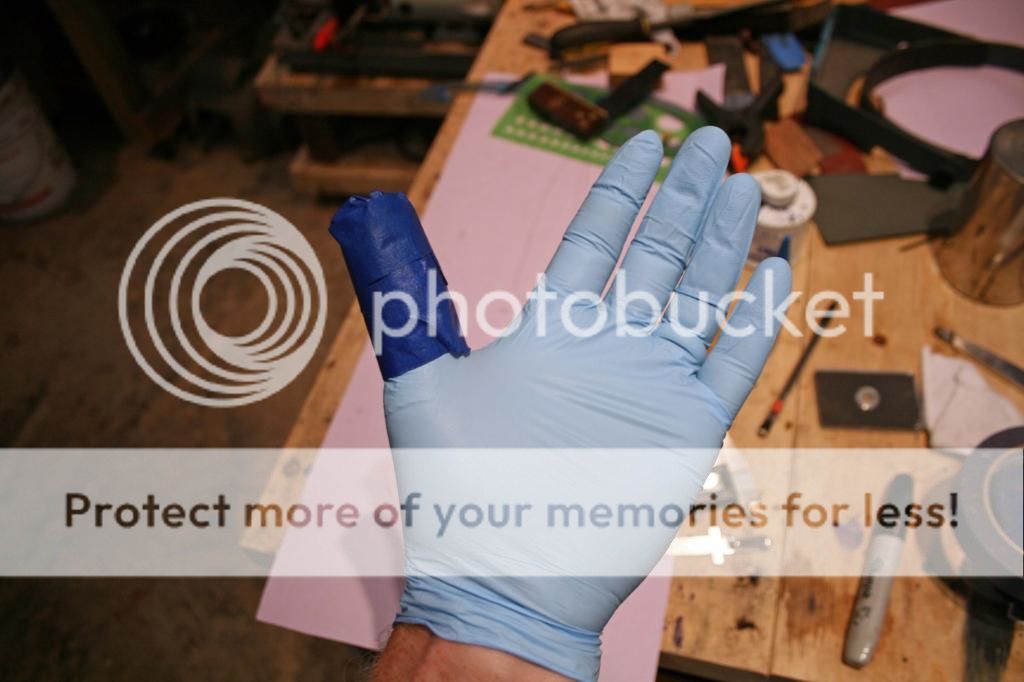

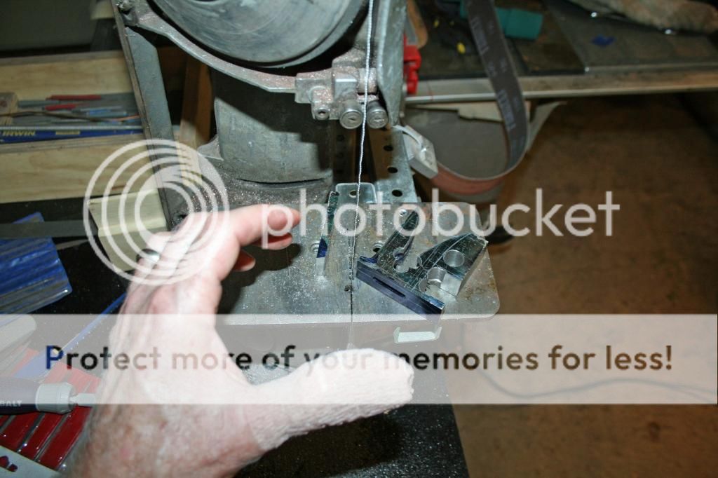

Before I begin to shape the guard I cut off some of the excess material from the keyhole block. In the process of doing this I had a small slip and managed to cut my left thumb. So I had to take a timeout and go get three stitches. In the picture below you can see the area I saw cutting when I lost focus. Be safe out there these tools can hurt you.
Well, with a rubber glove and some tape it’s back to work.

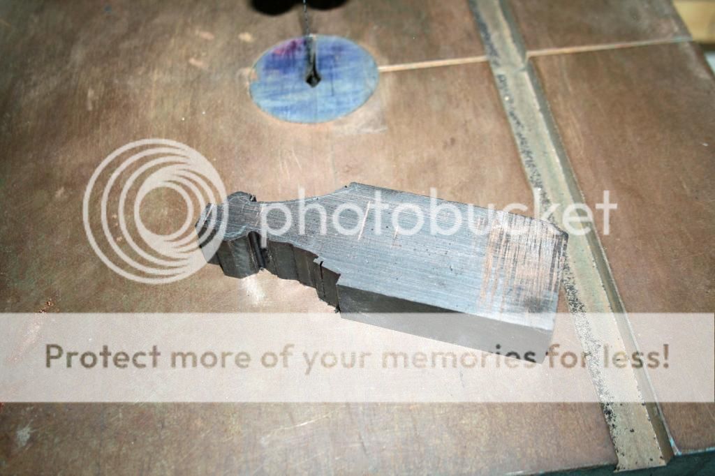

I finished cutting away material from the keyhole block.
Next I begin to shape the profile of the guard, I do this on my KMG grinder.

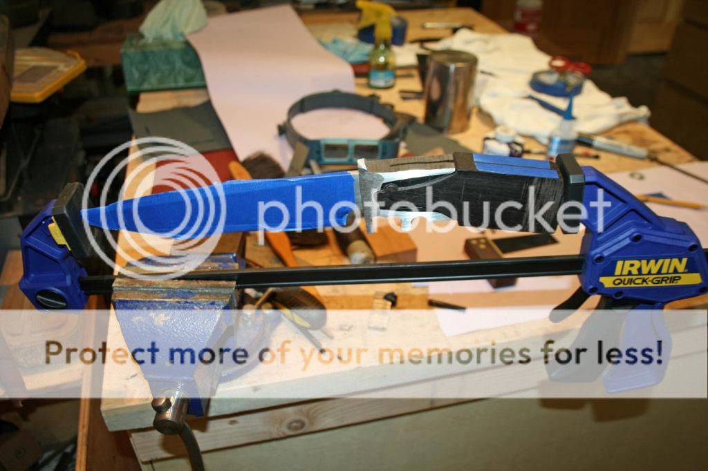

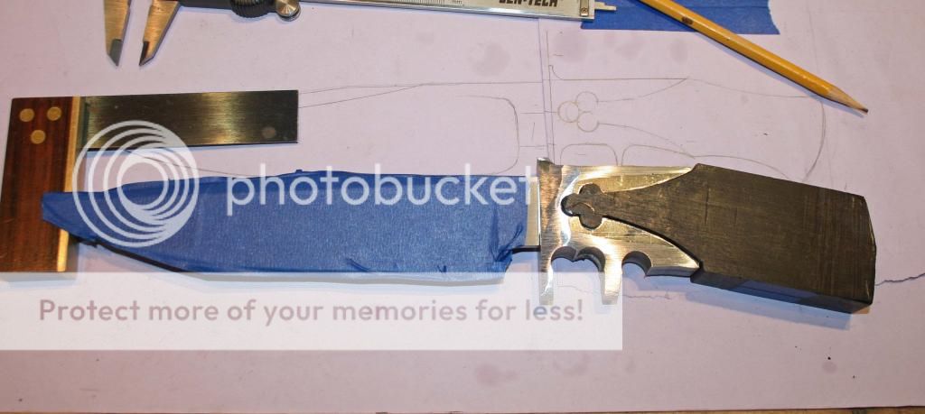

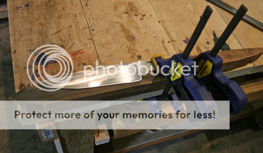

Next I do one more dry fit-up and how I will clamp everything together.

Next I get everything I will need for the glue-up. I’m using 15 minute epoxy. I was concern that I would not have enough time to put all the parts together and get them lined-up. You may note that I have black leather dye on the table. I mix some of this in with the epoxy so if there are any small voids that are filed with epoxy will match the African Blackwood.
