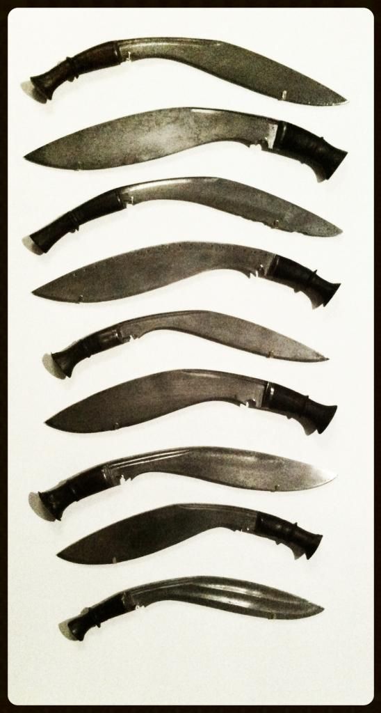

I've been trying to figure out a good way to display my collection. I'd like to figure out a good way to display the khukuris along with their scabbards all on a wall, with the blades out of the scabbards, without having to make hundreds of holes in the wall (I think I have over 40 khuks now - haven't really been counting - you know how HIKV goes...). And of course they have to be easy to remove and replace, so that they can be used, fondled, etc. One friend suggested that I should hang them all from the ceiling of the living room, kind of like the sword of Damocles, but I think that might make visitors a tad uncomfortable. Not to mention that the longer ones like swords would create quite an obstacle course, since I don't have a high ceiling. But it made me smile thinking about that option.
Great stuff Bookie, I'll be following this with interest. I'm always looking for good ways to display my kukris.
Currently I use a brass picture hook to hold the belly and a brass pin to sit in the kaudi. It's a very grainy pic (deliberately so, I was going for an antique arms & armour catalogue look) but you'll get the gist.
It works well for me, but I really like the idea of a rack.
