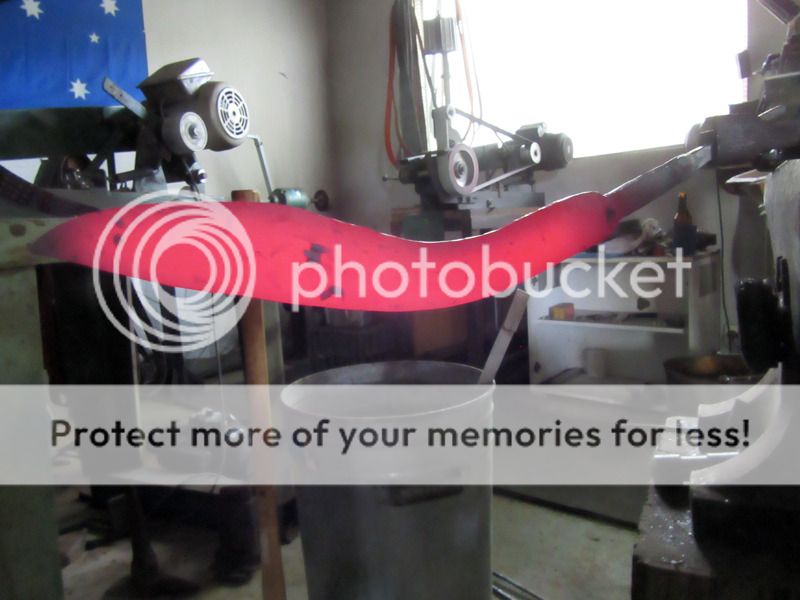

I'll jump in. I got some steel hot, W2 in this case. Smacked it out a bit and here it is normalising :D

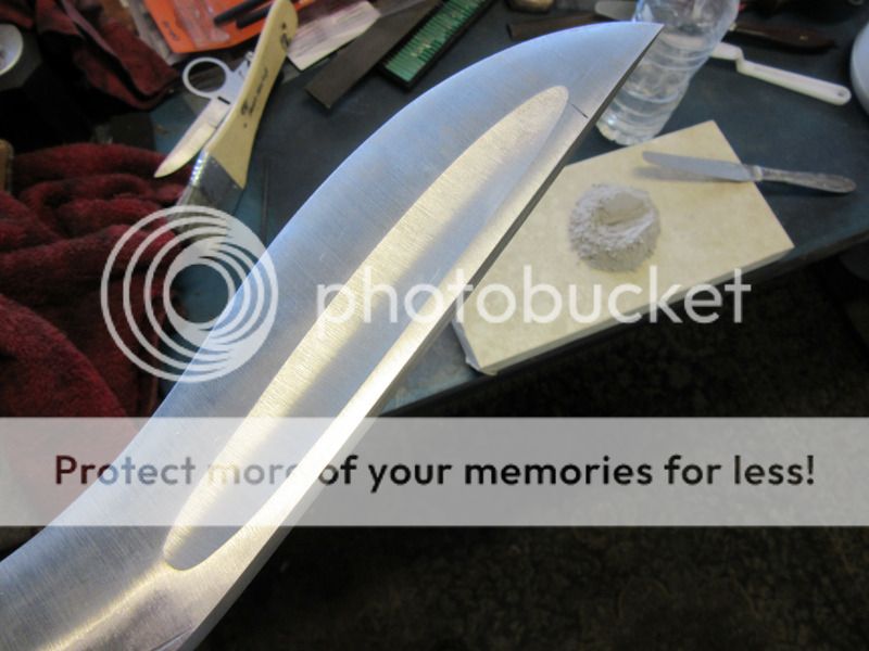

After forging in the fullers. Note to self make a pattern outa aluminium, that wont burn as easily :eek:
Give it a rough grind, ready for the next phase. Yep thats the smallest slot I've ever cut, 2 mm wide, and no matter how carefull I was, 5 slot drills later had it done. Such is life.

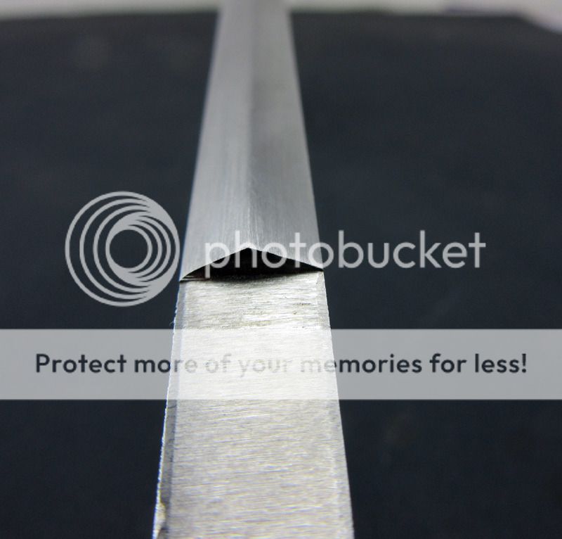

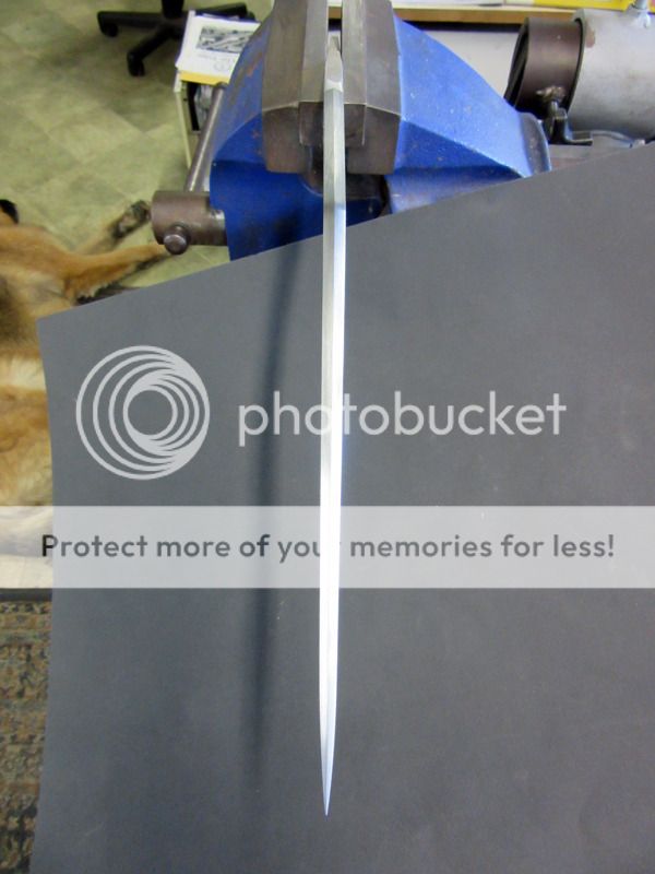

Time to do some file work on the spine and cut the blood dripper in. You can just see my workshop supervisor doing her job, as usual. :D

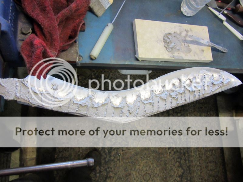

Take it up to 120 grit and apply some clay.

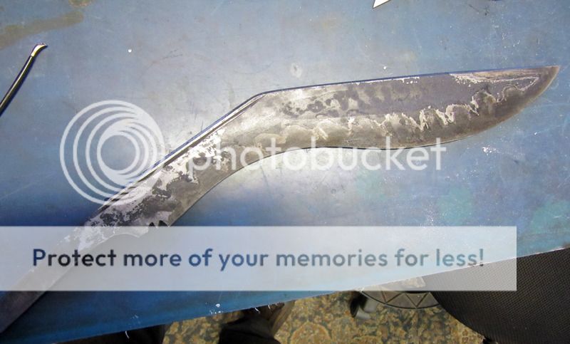

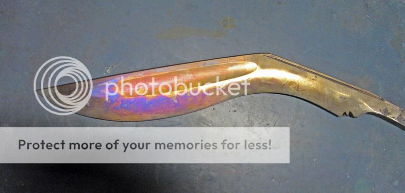

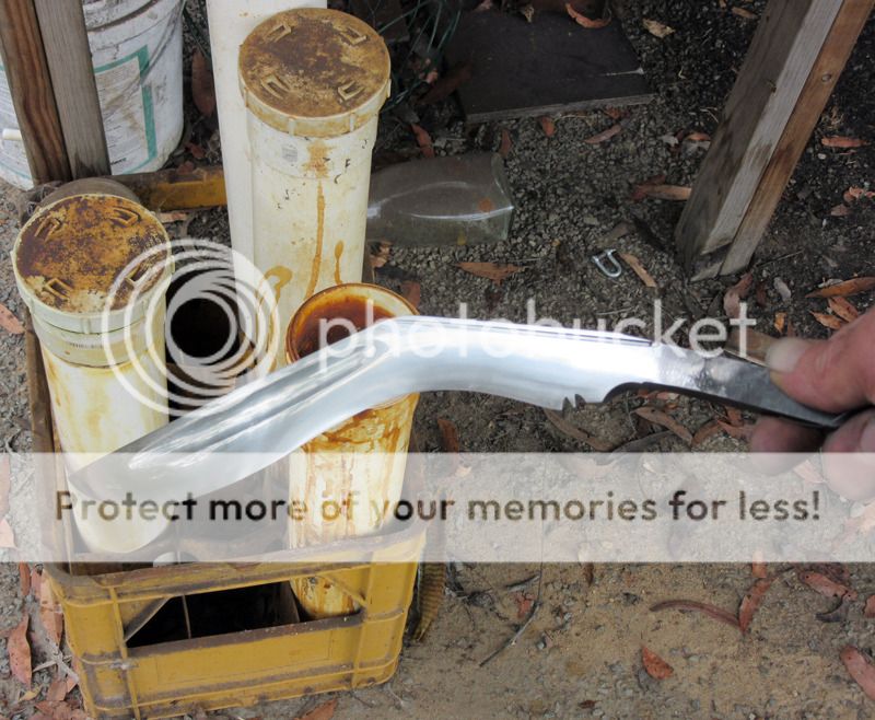

Here it is after the heat treat showing some nice frosty bits. Always a good sign :)
After the temper
Thanks for looking and comments welcome
Cheers Keith

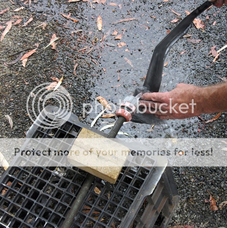

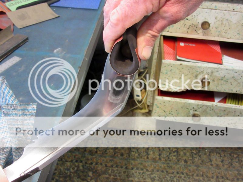

Time to do some hand rubbing, the little fuller is a real pain

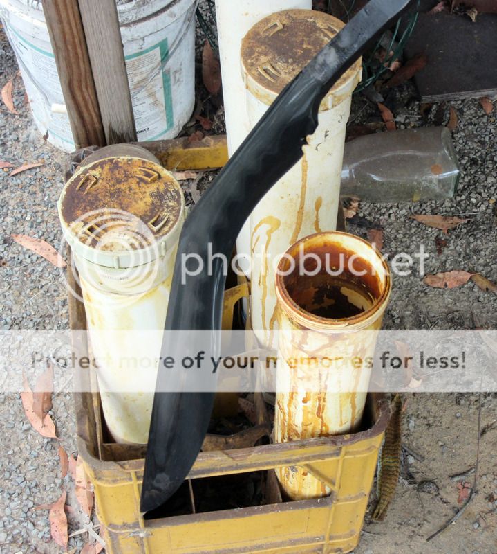

Ready for a soak in the magic revealo juice :D
Dirty oxides, give em a rub with some oooo steel wool, repeat until I'm happy.

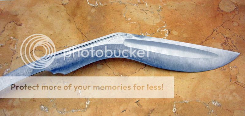

Happy :D

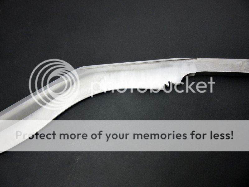

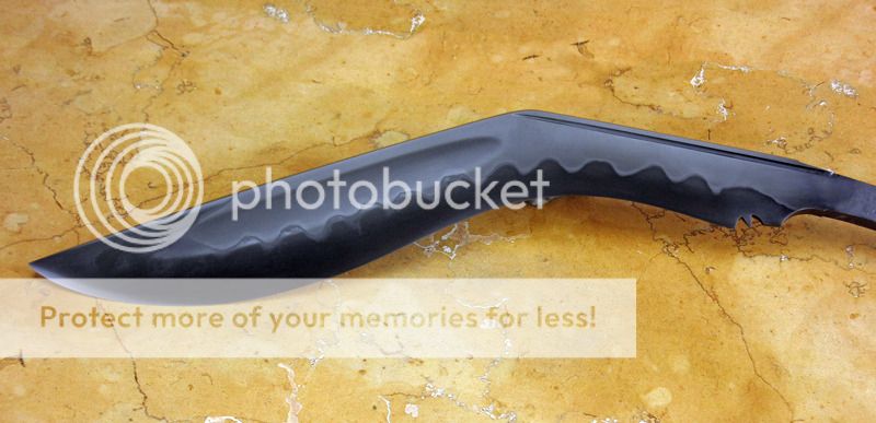

I was totally expecting the large fuller to mess up the hamon... How'd you keep it even?!
I'm a huge Khukuri fan... I like where this is going :)
Hi Jacob, are you referring to the hamon? The hamon is in the fuller and in hindsight I would avoid doing that in future, just for the asthetics of it IMO.
