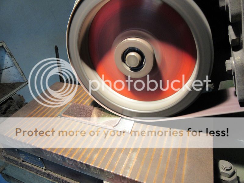

Towards the butt it flares out, I had no copper in that width so I melted up some copper and poured it into a flat mould.
Here it is on the surface grinder, gotta love supa glue :eek:

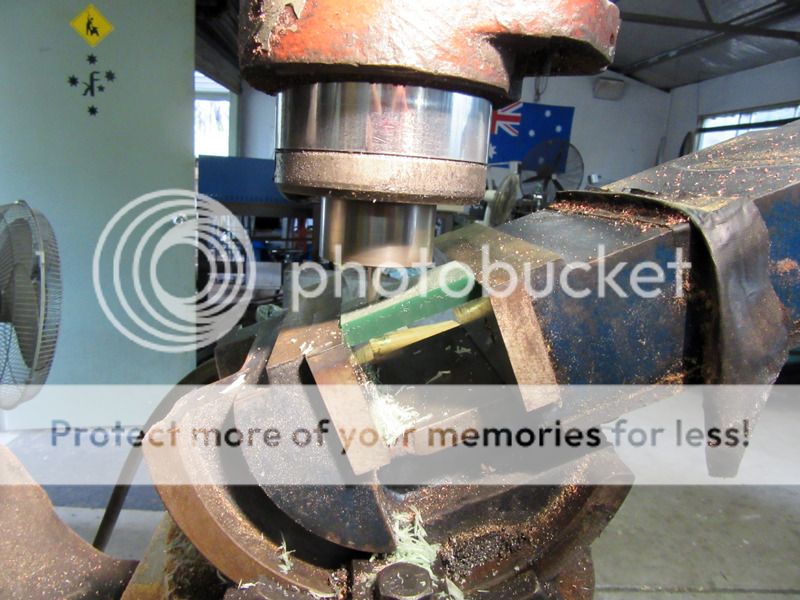

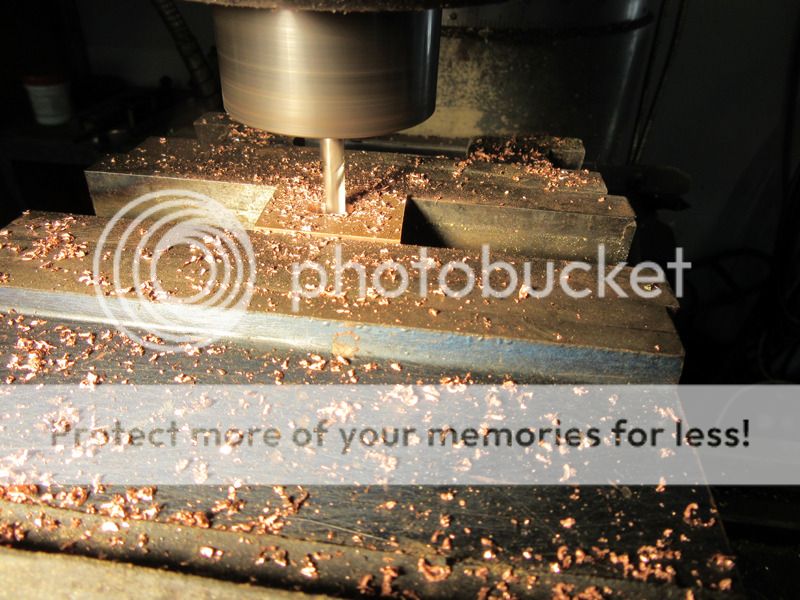

Bit of milling on the spacers

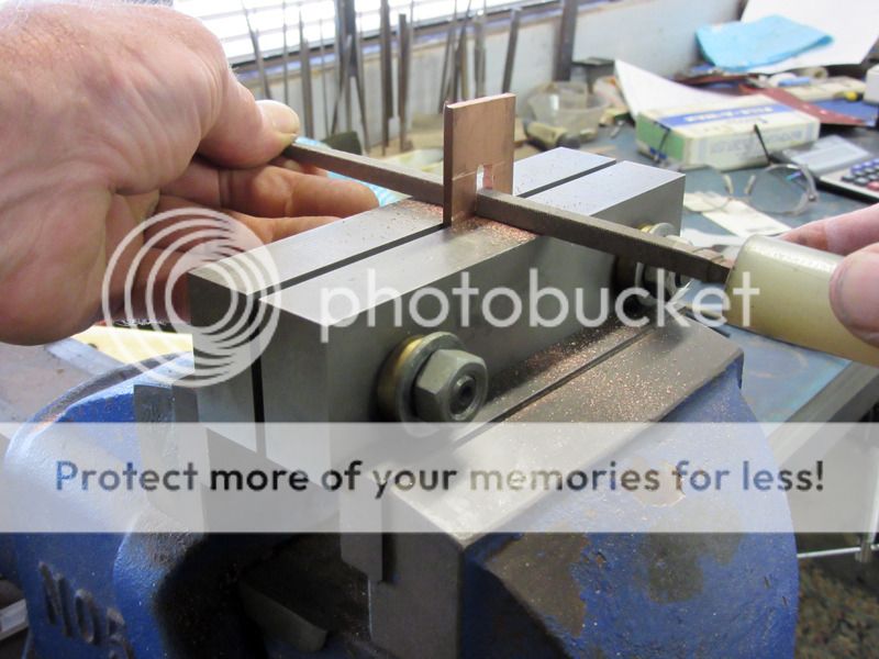

File work

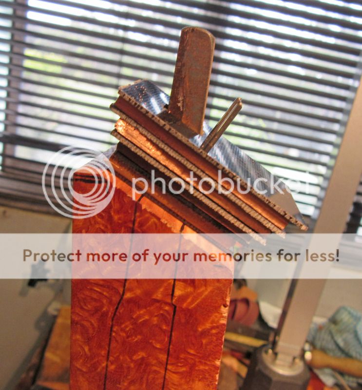

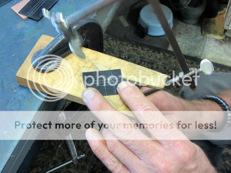

Cut some slots in the G10 with the trusty jewellers saw

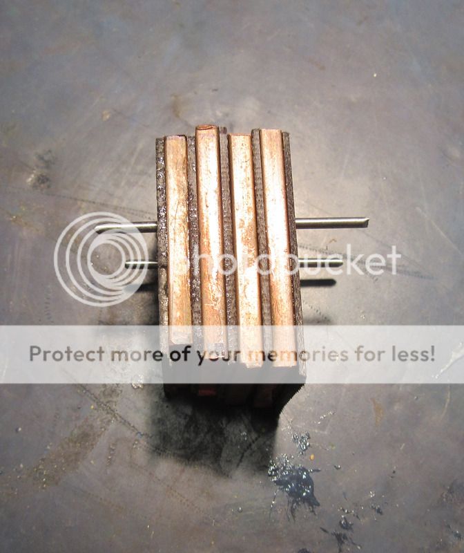

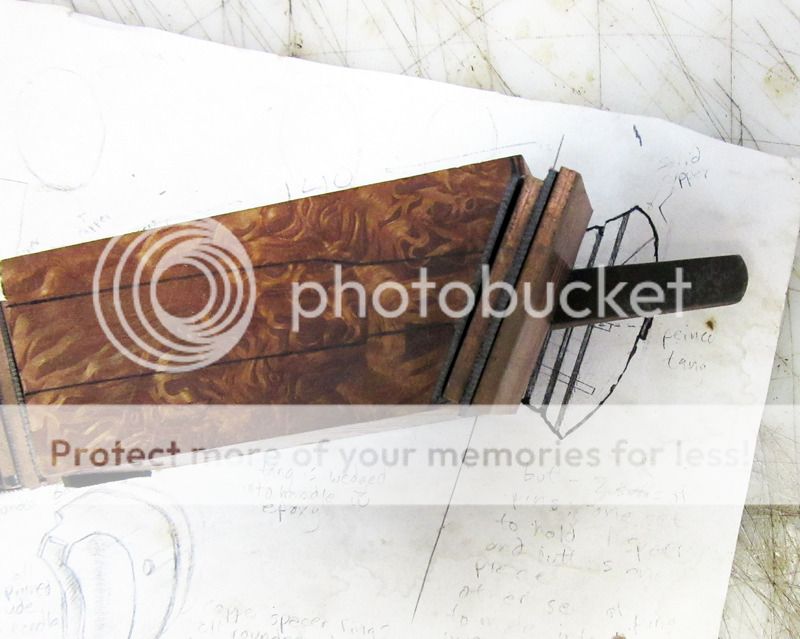

Stack em up
Did I mention I love supa glue :D, once the glue has set drill my locating pin holes
All ready to make the butt cap. Mill the slot in the wax, nice tight fit. Once I've filed it to shape I can send the parts of to be cast, Yay !

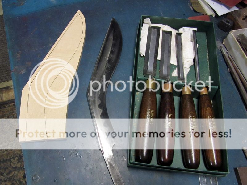

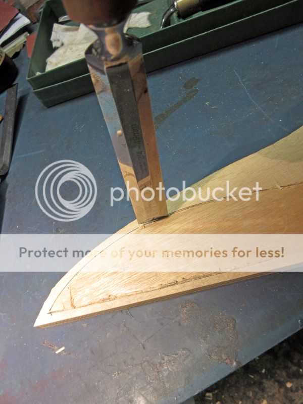

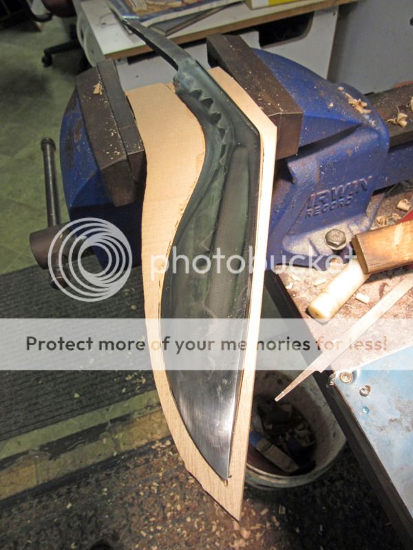

Well all my wax models have been carved and I have dropped them around to my mate to cast them. So I started on the pants :D Wooden scabbard wrapped in leather. I have chosen White Beech because its light and easy to carve with my favourite gooseneck chisels. Start with the marking out and then go around the outline with the chisel.
Once i have this done, start to carve. Have to go around the profile with the chisel and go deeper each time until I am just a little under half the thickness of the blade (I'm putting in a felt liner)
Here it is fitted

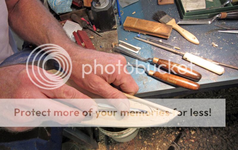

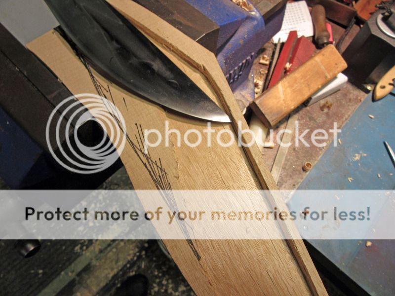

Because of the shape of the blade, I press the spine up against the top of the scabbard and mark out the outline the blade takes for insertion and removal. You can see the lines I have marked out in this next shot.

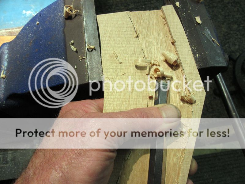

With the chisel go around this new profile and carve it out to the desired depth. It can be a lengthy process as you need to check the depth constantly.

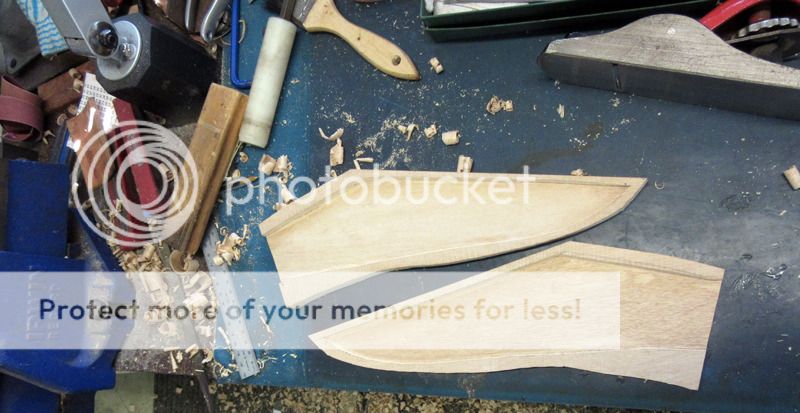

Here we are with both halves carved. Note to self, must sack the cleaner for not tidying up ! What a bloody mess :eek:

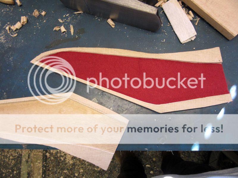

Fit the felt liners. I dont adhere them until I've just about to glue up the 2 halves (keeps the dust off)

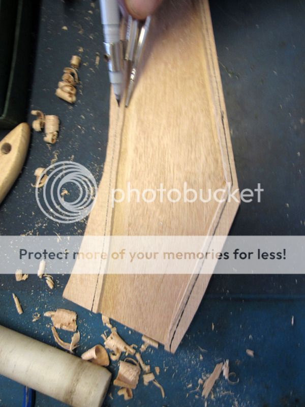

Time to refine the shape of the scabbard. With my old school compass mark out the shape and cut it down to the lines.

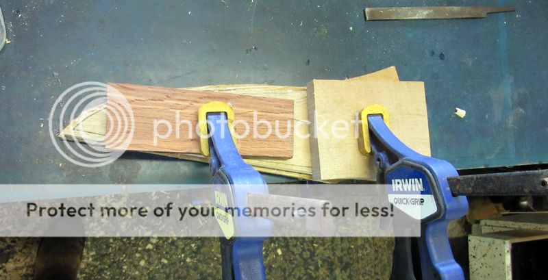

All done, now its time to epoxy the 2 halves together. You will see (just) that I have reduced 1 half, profile wise. This helps with the alignment of the blade in the scabbard. Clamped up and left to set.
