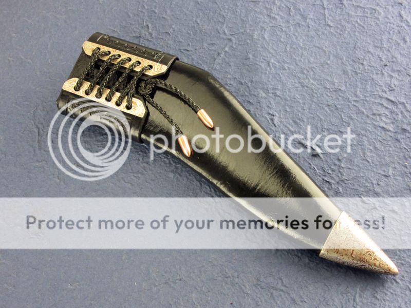

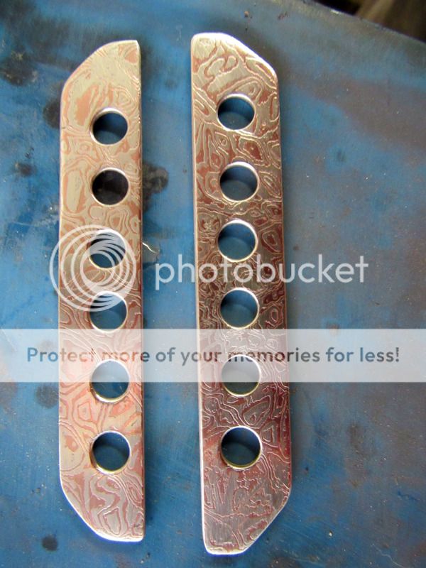

Yes I know its been quite some time since I last posted any more work on this project. Firstly the scabbrd I made ended in the trash, so I had to make another. Secondly, and heres a tip, don't get anything cast in copper. Apparently it is the worst alloy to use when casting as it oxidises at melting point, along with other nasty problems. I know this as we had to get three sets cast, first two had porosity all over the place, finally the last cast was a bronze alloy that came up trumps. Live and learn they say. I will say that it is complete, finished, caput and all done :)
So here is the final chapter (at last)

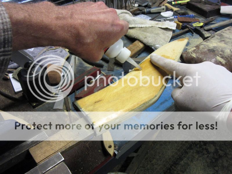

I made the scabbard out of White Beech, its fairly soft so I gave it multiple coats of supa glue. Hardened up nicely.

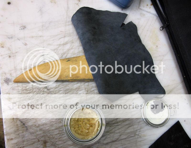

Time to overlay the scabbard with some leather, section by section, streching the leather as much as I could.

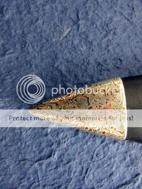

Here it is all stiched up with a Mokume Gane Chape and a closer look at same. Copper and Sterling Silver in this case and some other pieces for the frog

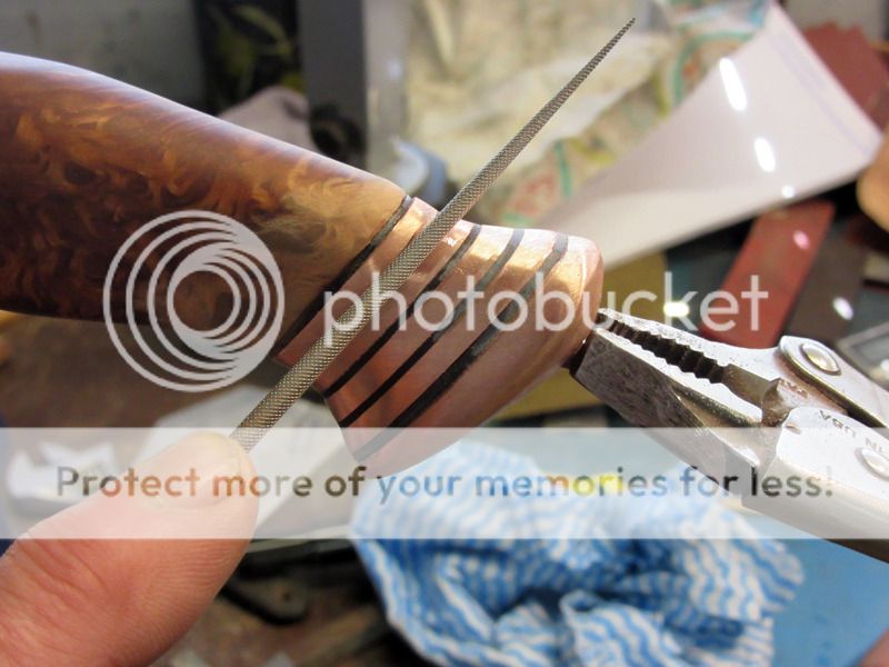

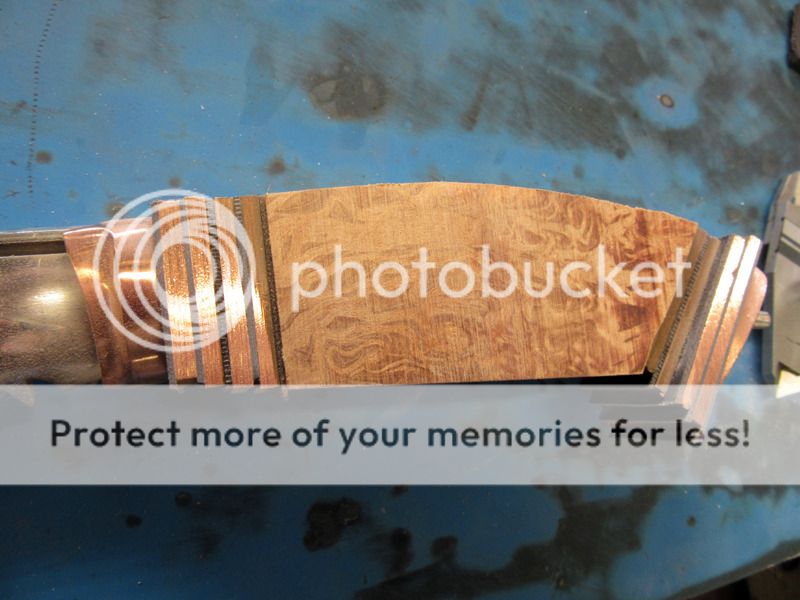

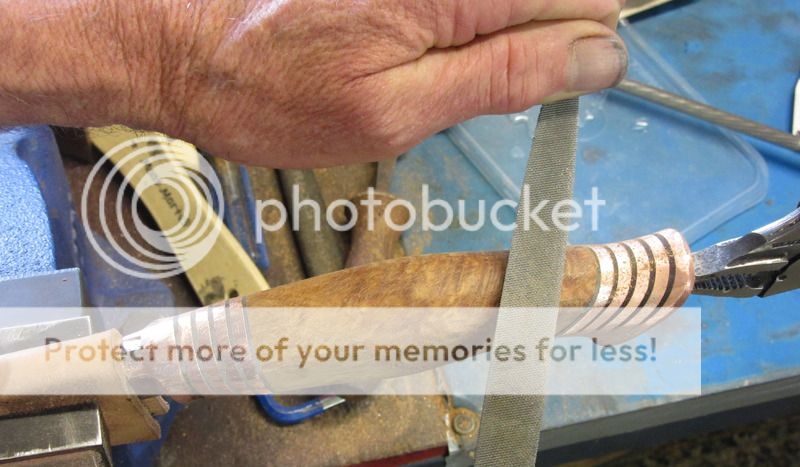

So now that I have all the handle pices time to start shaping it all.

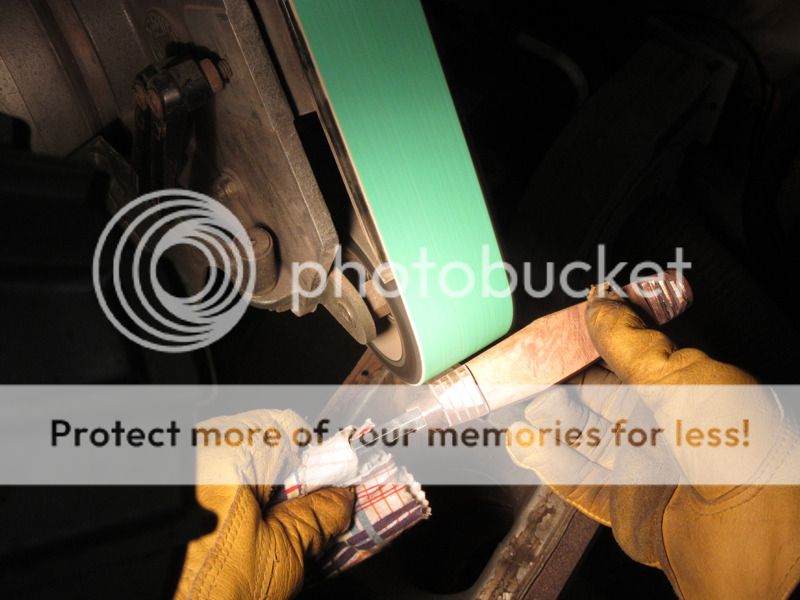

The reason for the gloves is the spacers are G10 ( horrible stuff to work with) and its bloody cold!
Time for some hand profiling.
Rounding out the spacers

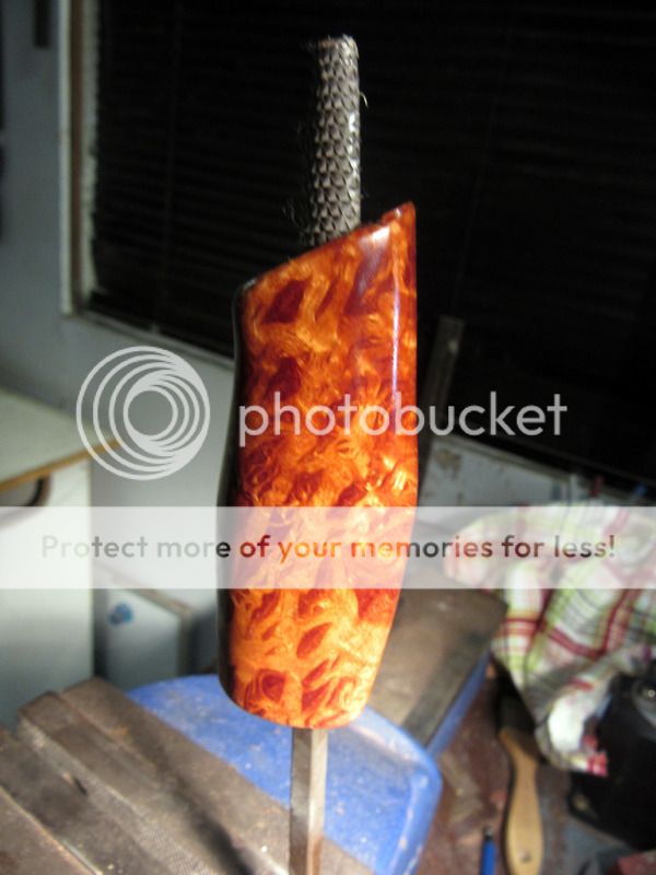

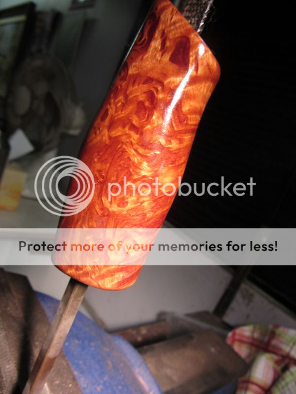

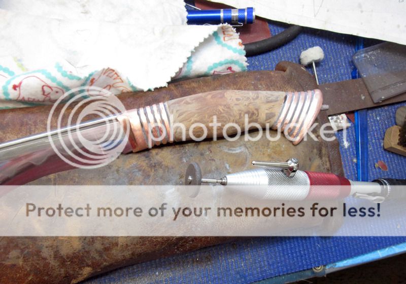

A little bit of polishing
Handle sanded and coated in Danish oil

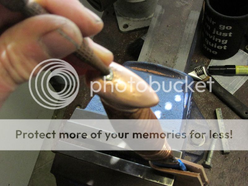

Time to peen the tang :eek:
All done

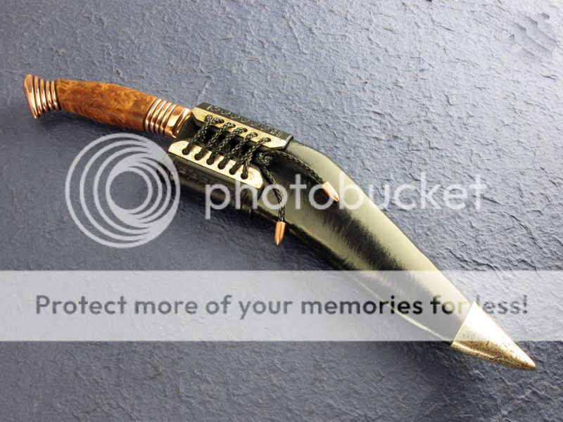

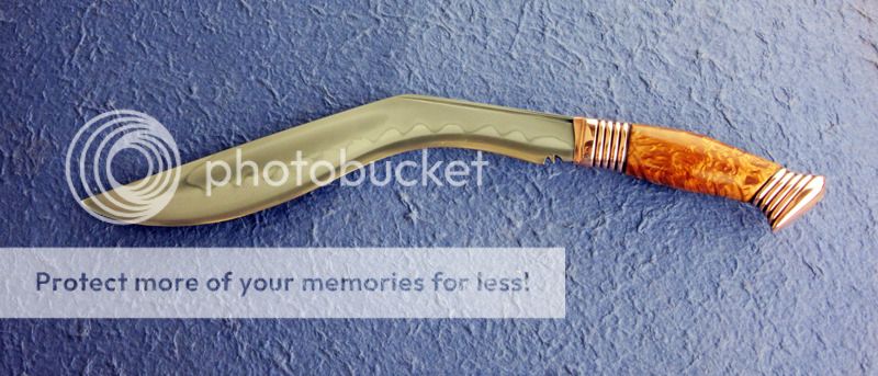

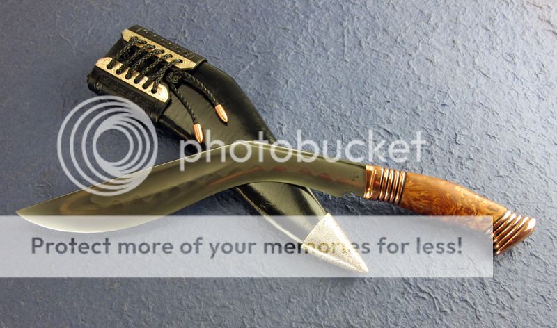

ps Here are the final specs. BL, 10 1/2" 275mm. OAL 17", 432mm. 0.378", 9.6mm spine at the Habaki. Weighs in at 1 lb 11oz, 750grm.
Clay hardened W2, copper and G10 spacers. Buloke burl handle. Timber scabbard overlaid with leather. Sterling Silver and Copper Mokume Gane Chape and frog fittings :)

Thanks for the comments mate. I must admit I wasn't aware of the fact that tradionally the tip is left soft (note to self)
