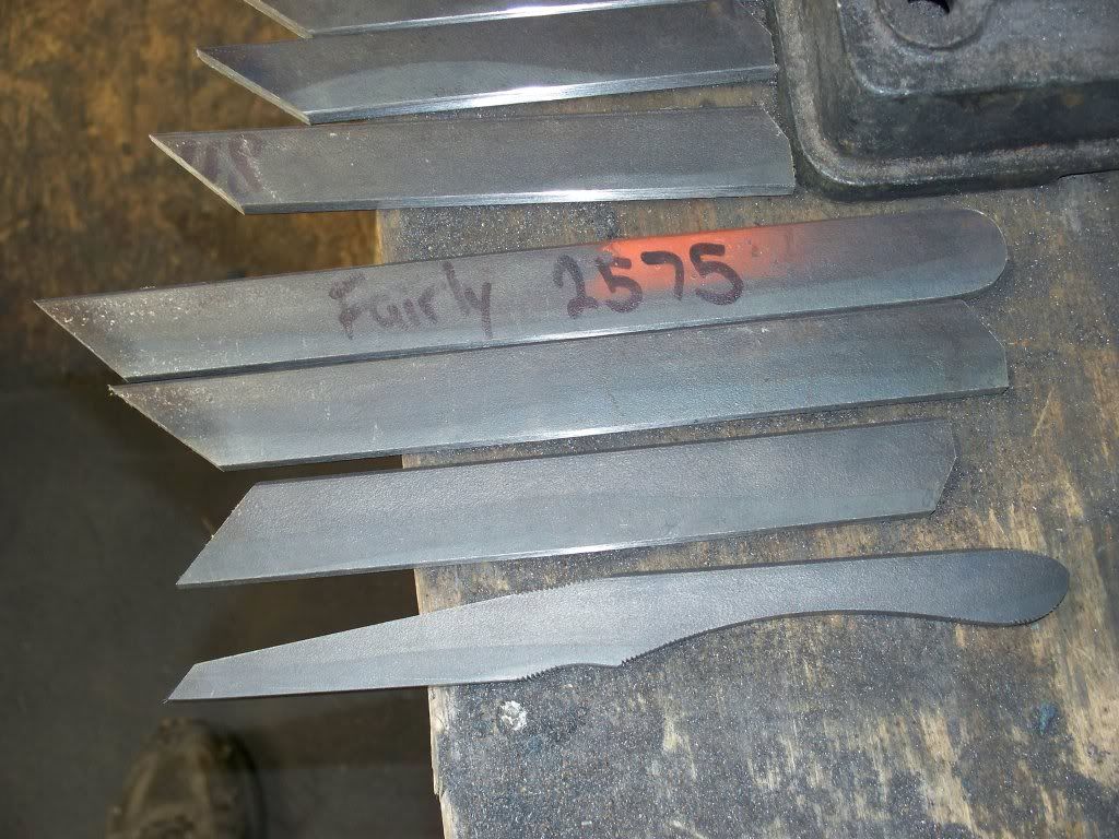

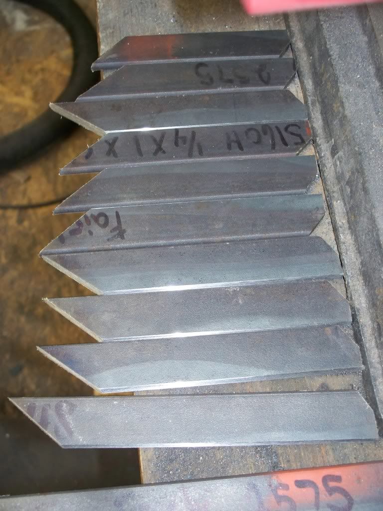

I have finished the 5160 to only 40 grit on the profile so the lines will change a little especially at the butt area.

5160!
This material is a bit thicker that .25...

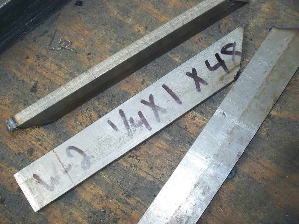

3 in W2 water hardening tool steel - this stuff is tougher to work with... brine/water quench but the grain is so fine they are well worth the extra effort! These are just cut by my chop saw and that is it so far.

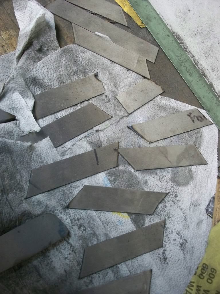

Lots of 15n20! .058" thick and most of these are 4" long. I just completed one today with this steel/pattern and it only weighed 22 grams with the sheath! They will look a lot different once profiled, these are also just chopped up. I'm keeping one I know that, these are easy to stash everywhere.

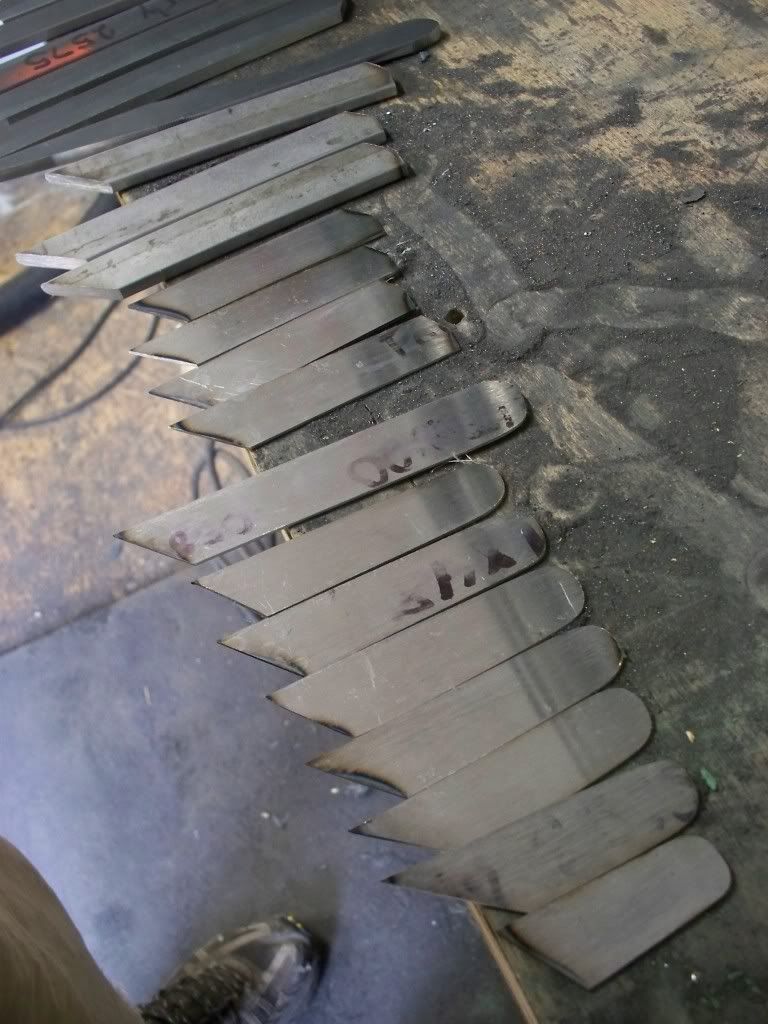

15n20 rough profiled
2 basic styles - rounded butt and angled like the 5160 ones
Most are the same size but there are 3 smaller rounded ones and one larger one that will probably wind up a tanto.
15n20 & W2 rough profiled
Most of the 15n20 ones are the same size but there are 2 shorter rounded ones and one longer one that will probably wind up a tanto.
The top three that are silver colored are W2 and the rest are 15n20.

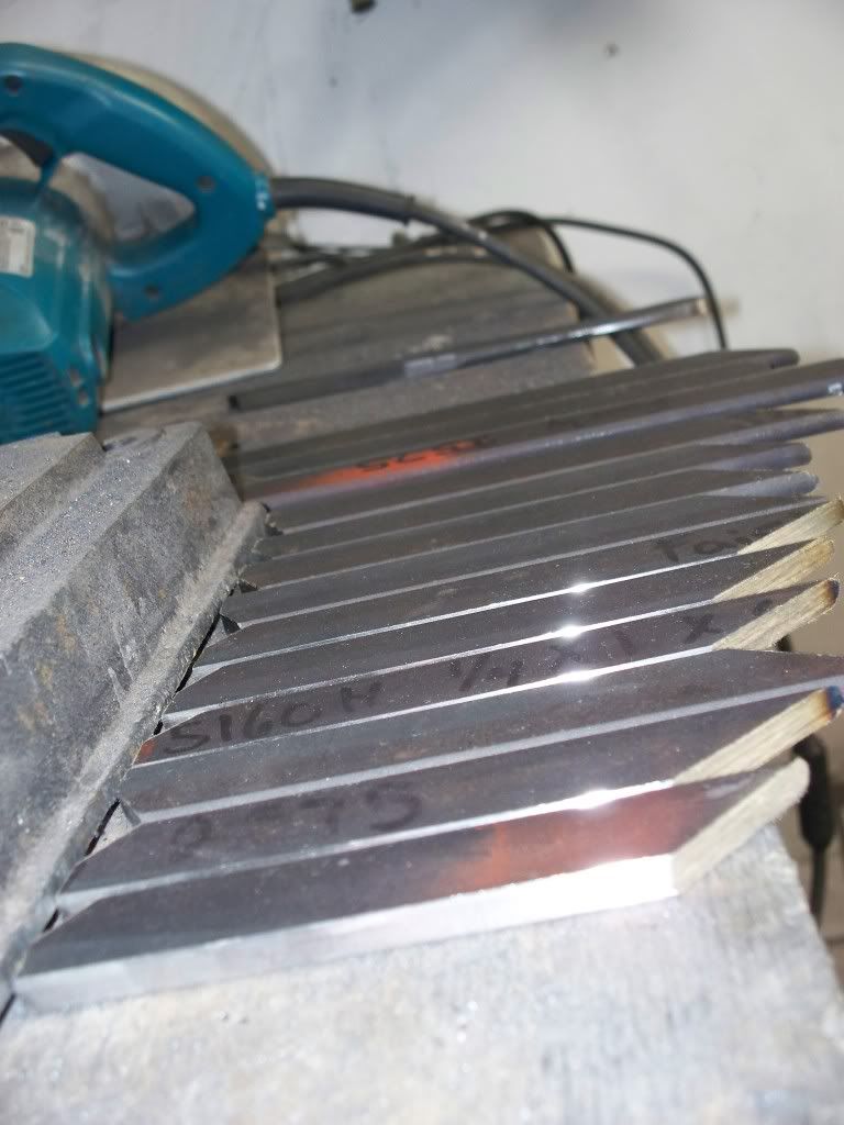

I was dreaming about kiridashis last night, lol! I worked on these until late and have them all drilled and chamfered. Next I'll go back to profiling, I have a few more stages of that to go before anything else.
I was looking at the above photo, lol that table was clean two days ago!
