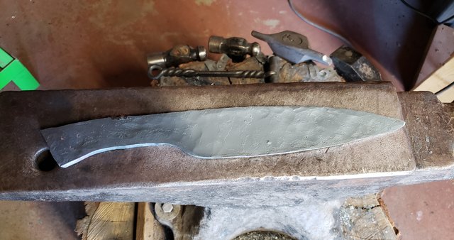

I had some time today after forging out an order, so I hammered this out of 15 n20. It's a bit over 13" overall. Now let's see if I can find time to finish it.
