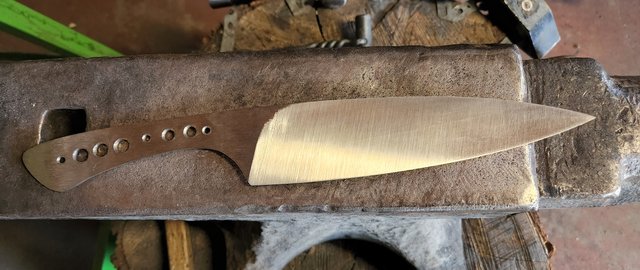

Got the carbon blade finish ground and 95% sanded. Final grind is thin and flexible, should fly through meat. Handle cut down and hierloom fit ready for glue.
Knife is feeling a little simple/plain so may etch it out or have a play with some patina.

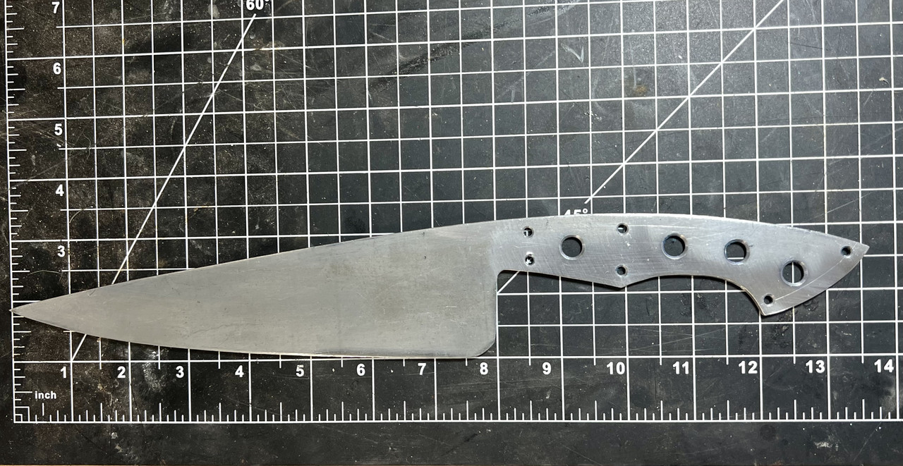

I’ve had an interesting few weeks but I think all that’s behind me and I have evenings free for the next 8 weeks so I should be able to get it done. I had planned to profile a bunch more AEB-L and send off for heat treat all at the same time, but realized I wouldn’t be able to wait that long if I wanted to get this one done in time. But I did get my scale options in for the knife:
Sometimes simple is better. Looking good

Those are some great looking knives! You’re way ahead of my schedule. I’m still waiting on blades to get back from heat treating but I ordered some new epoxy, and some Corby bolts plus a counterbore for them. Should be ready to get to work as soon as the blades get back.
