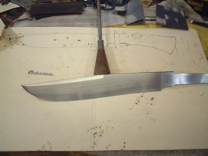

I got myself into the habit of doing a drawing of however I want a knife to come out. I usually draw the ENTIRE knife before I even proceed.
Handle and all.
This way, throughout the creation of the knife - from forging to completion - I always have the end-game in my mind, as well as hard-copy reference.
Then, I will even cut out a pattern to refer to during the forging process.
This gives me something to keep on hand for reference after the knife has moved on.

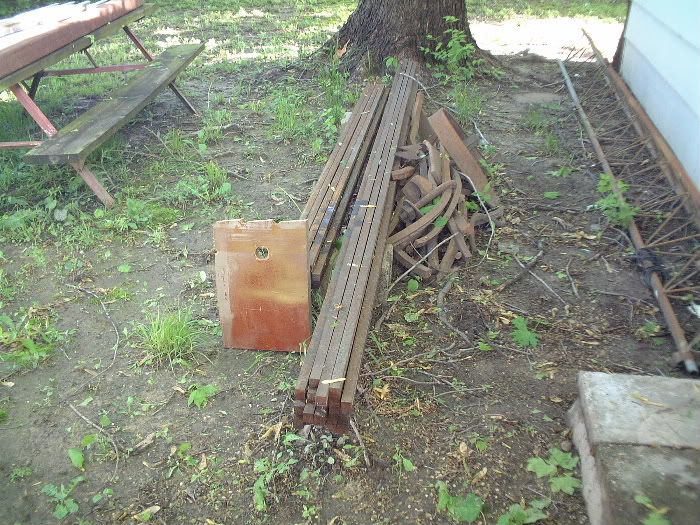

Here I will show my supply of materials for this project, which I'll admit, is more than I gave Roger and Lin!
I can afford a few mistakes!
And here is the drawing, the square stock, a peice I have knocked down and the pattern.
When I knock my large stock down, I leave it well over-sized so I can then make whatever I want.
This piece over 1 1/2" and was .334" thick.

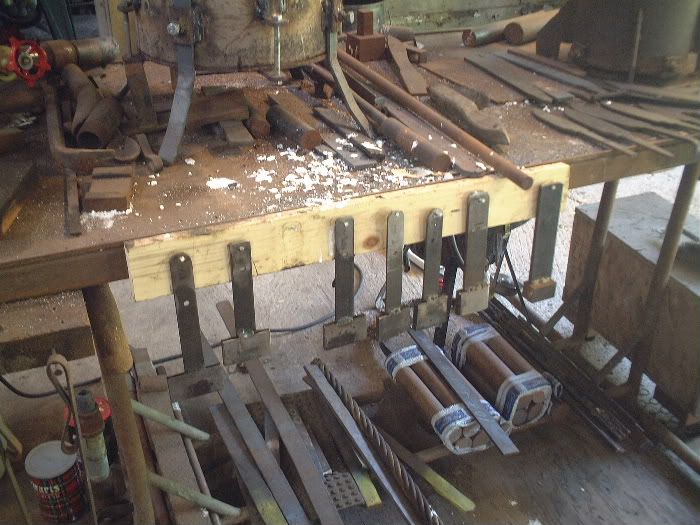

Here is the forge area:

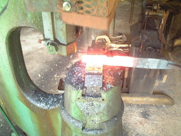

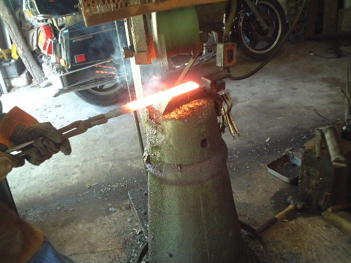

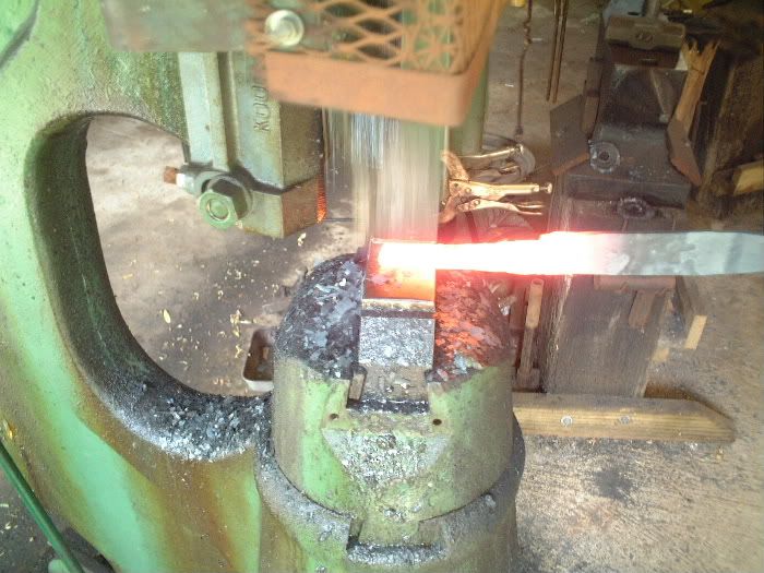

and here you'll see me reducing the size. I do this with spacers that I have made to stop the hammer dies at pre-determined thicknesses.
Here is the first draw-down to .300"
Then, I will draw the entire bar down to .270" with progressively thinner stop-blocks.
After I have the material reduce to a working thickness, I may even want to widen it, as is the case here.
I do this on the dies in my hammer which are taper on the front and rear edges for slight drawing.
The, by stepping down with my die spacers, I will litterally forge in the blade distal taper before I even shape the blade profile.
When held laterally on the dies, the material is widened:

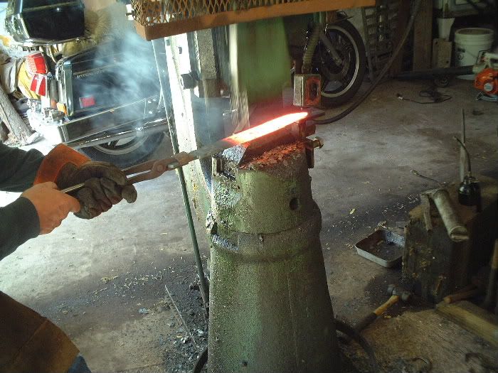

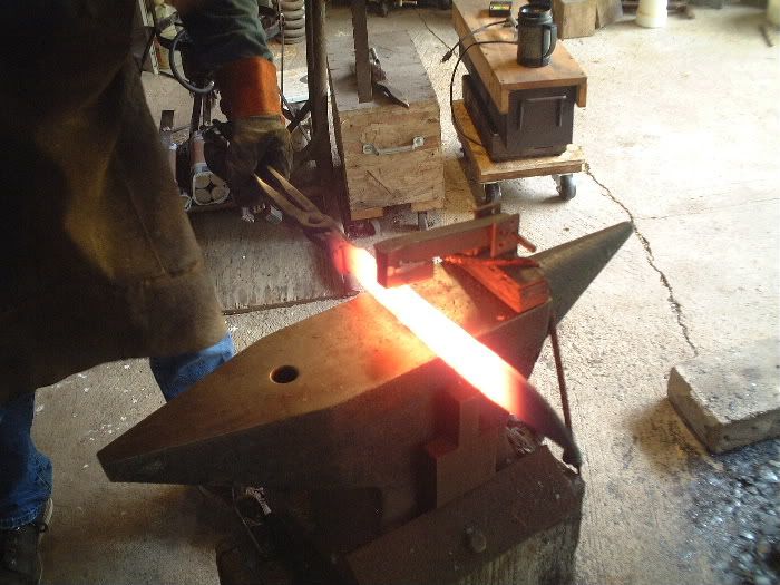

To the anvil next and start forging in the tip:
then using the pattern to determine progress and how to "tweak" things:

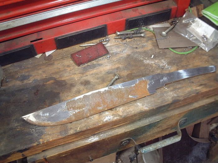

Here is the basic blade shape prior to final tweaking:
Drawing out the tang:

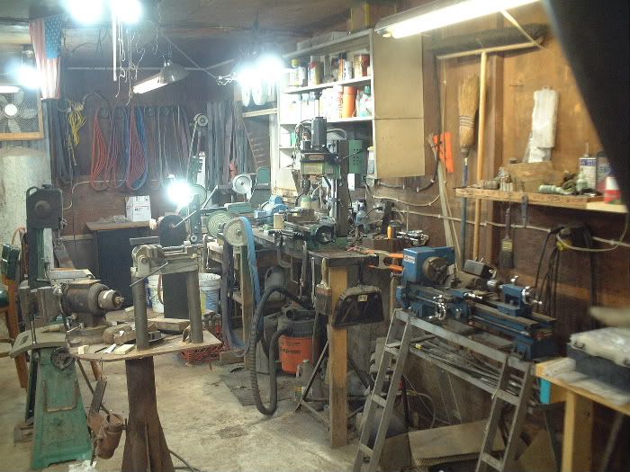

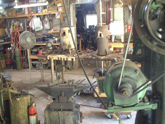

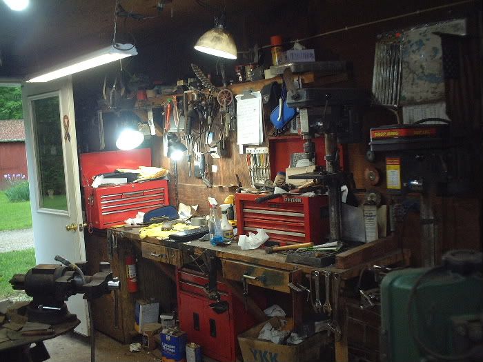

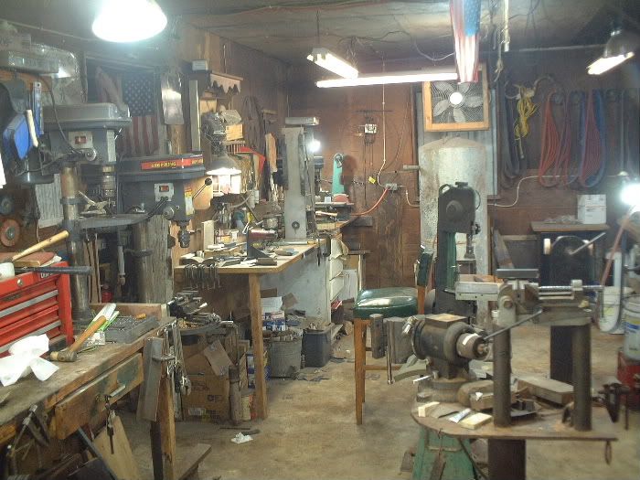

Show ya'll what I do so far today - amongst other things.
A few pics of the finish room.
Now before I hear any smart alec remarks - I MAKE KNIVES! I don't DUST!
ABout once a month when I can't take it any more, I close all the cabinets, tool boxes and drawers, open the front door and fire up the Stihl leaf blower and let 'er eat!
I can guarentee you this shop will see NO cleaning up unti I get back from Atlanta.
In the mean time, I try to equip myself the best I can.
If I need something - I get it.

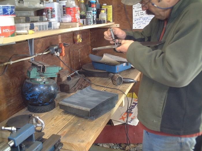

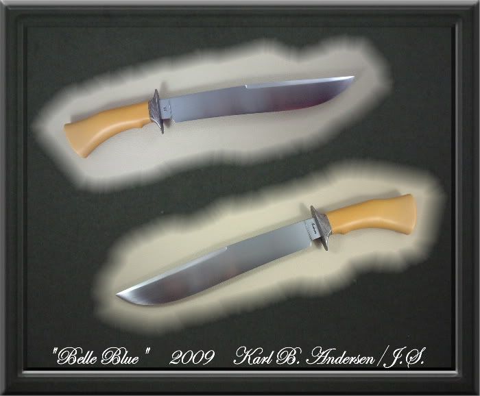

Here I am beginning work on "Belle Blue".

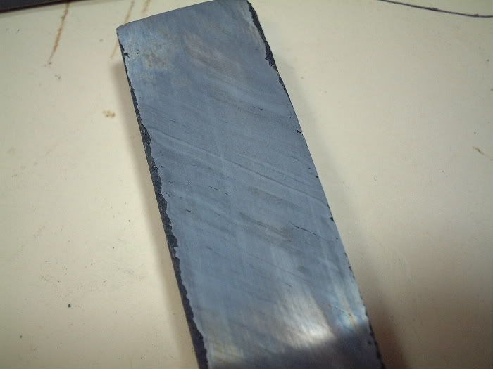

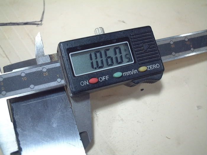

I first square up the side of the ricasso and remove all forging traces.

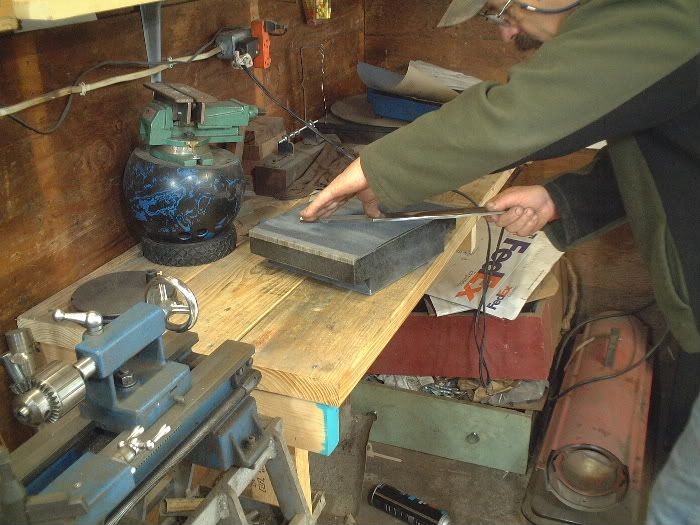

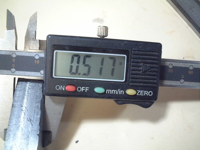

Then, I'll take my knives to a granite lapping plate that has been certified to +/- .0001" laterall accuracy.
I'll then mic it to ensure both sides are consistant.
With my take-down method, I can afford no variance as I mill my guards and those sides are true and parallel.
"Belle" ended up at .251" at the guard shoulders.

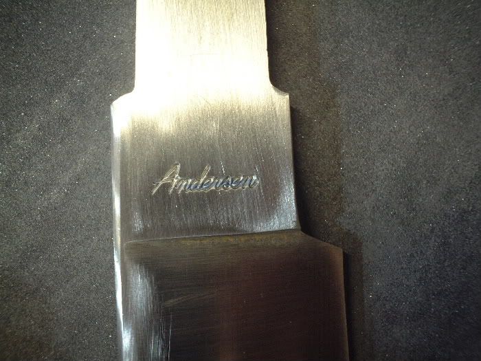

Now we'll press in the Maker's Mark!

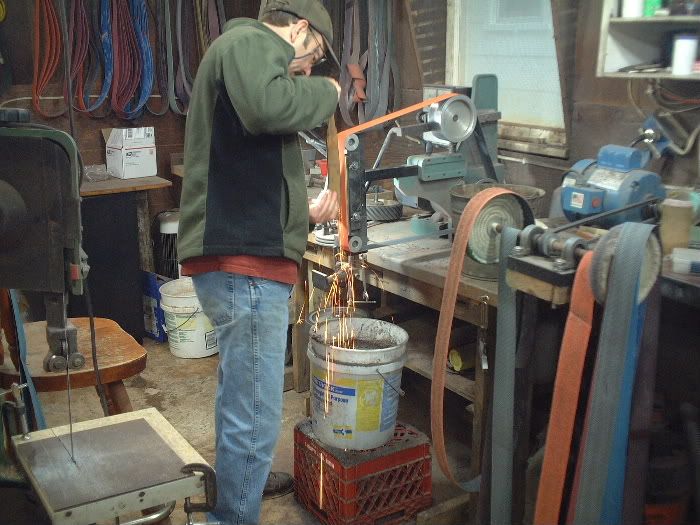

You've all seen grinding before, so I'll dispense with that.

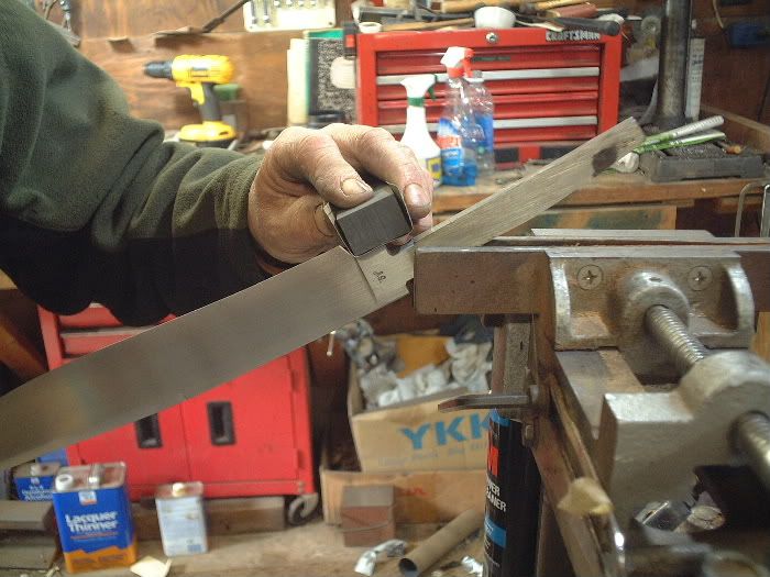

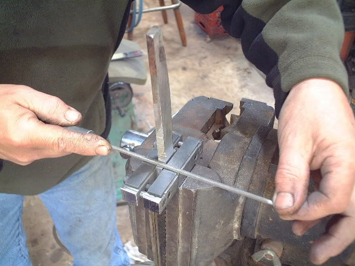

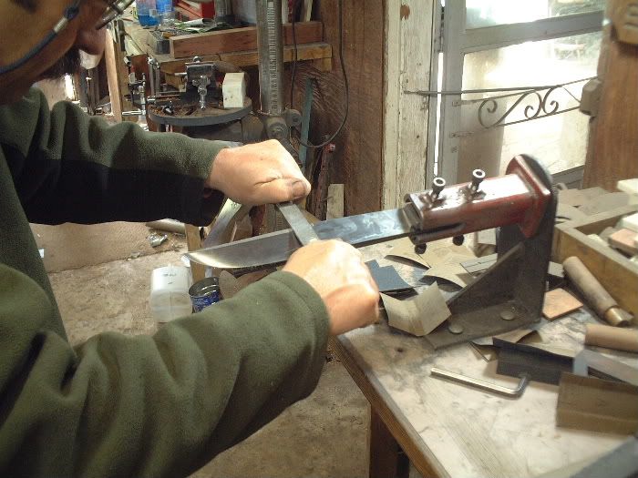

Next I go to a knife vise and bar sand the grinding scratches out.

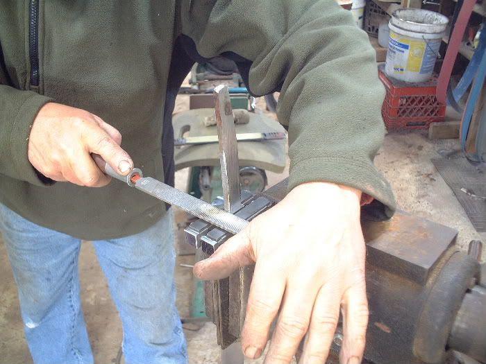

I've nevere been a big fan of mistakes, so I try to eliminate them before they happen - I draw file my false edges rather than grind.
I find it a little relaxing actually.
And almost NO mistakes ever occur.
Gettin' close!
Now, file in the guard shoulders
Radius the joint:
Clean up the choil:

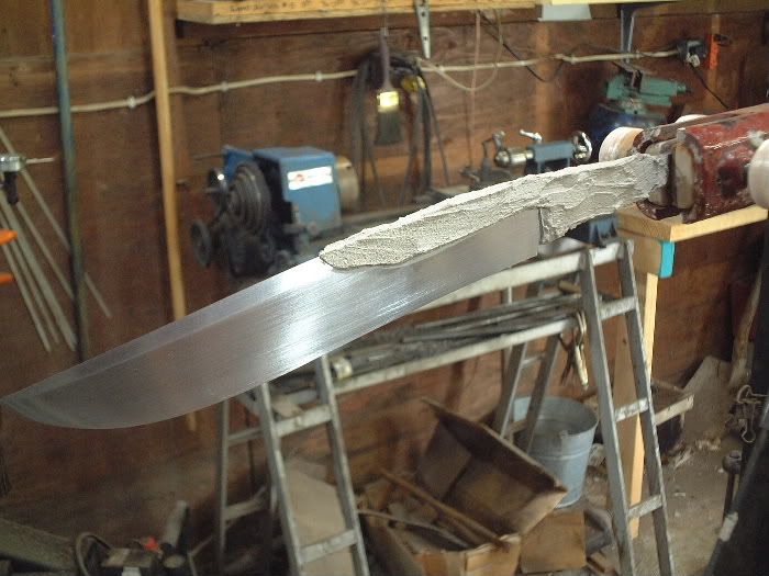

5160, especially the stuff I have, is AMAZINGLY tough in pearlitic form, not to mention tempered martensite!
I like to clay my guard shoulders and a few inches of the tang, as well as some of this spine on a hard-use chapper.
I did these photos myself on a tri pod and timer and caught this pretty much right where I wanted it!!
This is right out of the oven after an austenizing soak on the way to the quench tank.

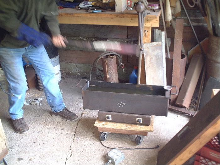

I just pulled "Belle Blue" out of the tank and she is resting peacefully in the tempering oven right now.

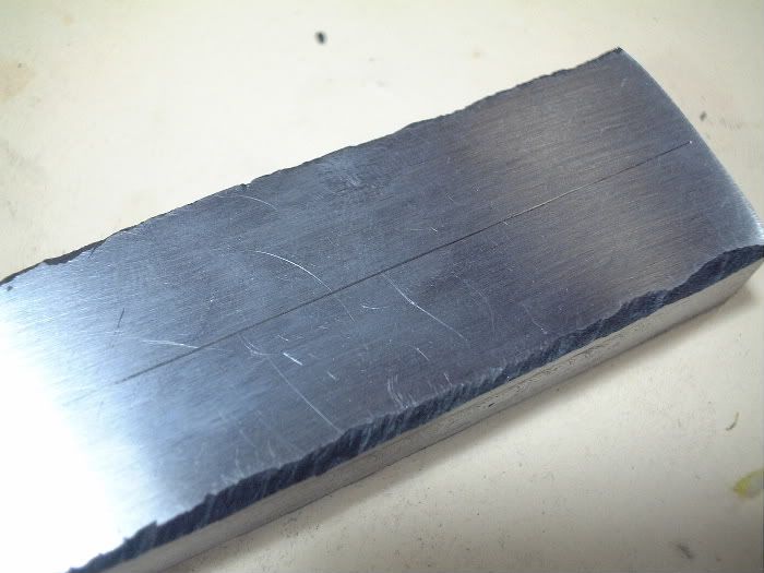

I took my testing file right to the cutting edge and for all I was worth, I couldn't even insult the ol' gal!
She's gonna be something to contend with!!

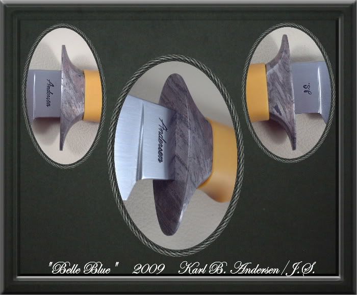

Let's clean up "Belle's" guard material a little.
I took the twisted wrought and ground off the scale on the grinder.
Then, flattened and "paralleled" all four sides on the mill.
Then, took to the granite lapping plate and got 'er true.
Here I wiped on a little FeCl to check our twisting success:
Looks good to me!
I used that .600" spacer on the hammer so that after I removed the scale and trued up the dimensions I would have a piece 1/2" X 1".
Here's what I got:

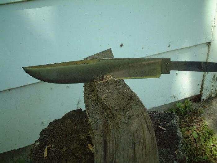

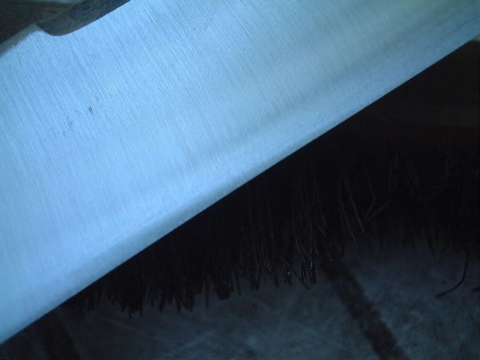

I did a preliminary grinding and took the edge right down to zero.

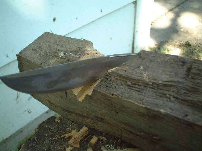

Last fall I was at a neighbors house and we got to talking about firewood somehow. He said that he had a bunch of oak that he'd had for years and didn't remember the last time he used his fireplace, so I took what he had.
This is that ol' bone-hard oak that'll take the edge right off a chain saw blade!
What you see here is about 100 whacks into some of the oak.
I was able to bury "Belle" that deep in the oak with NO HANDLE!
Then, I cleaned up the smears so the edge could be seen.
I think she'll take to the woods quite readily.
