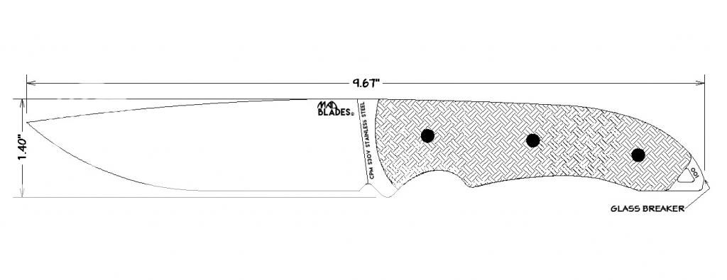

Do you feel comfortable posting your design?

I was going to use the buffer to get a satin finish, can I obtain a satin finish with a particularsanding belt?? Yea I'll post my design....

The grinding jig I am going to be using is a toss-up between the one Aaron Gough made and the Snoody mastermind jig, I redesigned both in CAD to fit my knife design precisely and implemented a stop for repeatable plunge lines on both sides of the blade
