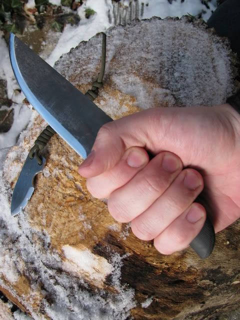

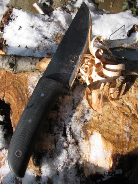

A few things struck me ‘out of the box’. First, it’s got a pretty unorthodox design. When I first saw pics of the blade, I really couldn’t decide how it would fit my paws. Turns out pretty well! It’s very beefy and well rounded, just what a chubby chaser like me needs. One thing that can turn me off with a handle pretty quickly is an ‘inverted’ hump at the blade-side of the handle, where it arches upward instead of downward like an egg shape. This handle sort of skirts the subject with the lightest inflection, but functionally feels pretty much straight. Or put another way, there are no odd curves that you’re forced to adapt to or work around.
The micarta is smooth and warm in the hand, and the dropped edge gives good protection from the blade for even the most nervous of users. The filing at the spine is just what good filing should be, meaning not at all abrasive to the thumb but still giving a bit of security. The rest of the spine is left unrounded and ‘edgy’, which makes for a great firesteel or tinder scraper. The edge wasn’t bad but needed to spend some time with a strop.
The leather is almost a whole other entity to be reviewed. It’s almost ornate with the cross straps. The workmanship is really quite impressive and it gives a lot of carry options (alternate settings for the belt loop). The edges of the leather are all well polished, and the stitching is tight and strong. It’s a bit weighty overall but not prohibitively so.

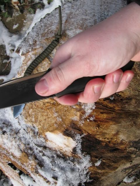

In use, the handle is as comfortable as I’d hoped (most know me well enough to know that this is saying a lot). There were no real hotspots encountered. Most notably, it was comfortable in numerous grips, especially a side grip. Stuff like that is what makes a simple, well-rounded handle so important: there aren’t any goofy grooves or humps to dictate your grips. No one likes a bossy handle.

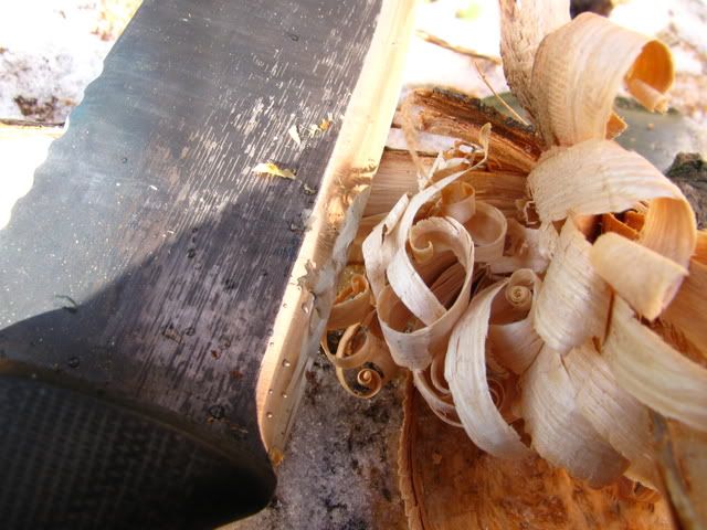

I made a few quick feather sticks (even my twigs/sticks were all pretty frozen and hardened, so this was smooth as always). I made these before spending time with a strop which was another drawback (gonna do it again after a quick sharpening). Batoning was likewise not an issue, the convex edge really helped it glide into a frozen piece of firewood.

After some more use, I found two small things that I'd change. One is to contour the handle a little bit, but only at the rear. My pinkie feels like it's gripping something too wide so I'd want it to thin just a bit there. Second, the sheath's retention is a little too good! Hard to get in and out easily. If the mouth of the sheath were left a bit 'open' instead of coming back down to the size of the handle (kept nearer the size of the 'guard'), it would be much easier.
