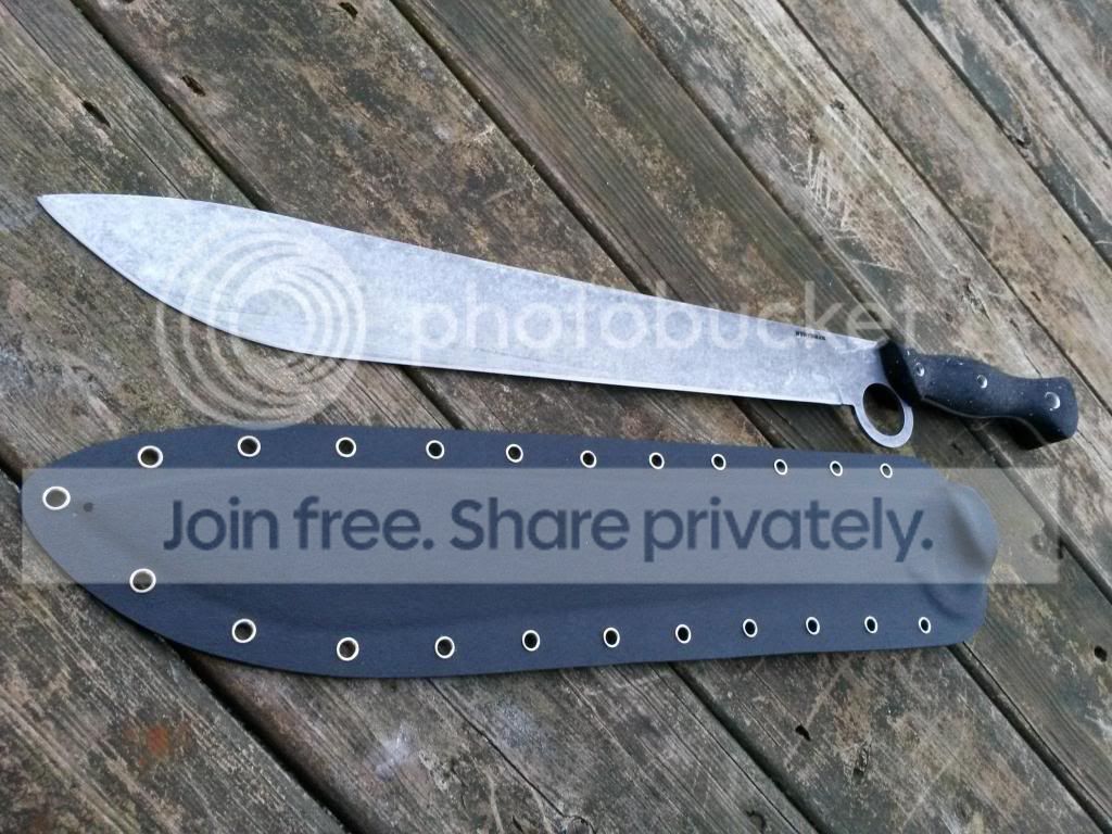

I've been struggling alot with consistency, especially in my machete sheaths. Drilling consistent holes in a 2 foot piece of kydex is just about impossible to do freehand. A hole template is something I am going to need to implement in the future as well as a more consistent molding method. Id also like to develop a more professional and defined look for my sheaths. The ones I've been making are not very confidence inspiring in terms of visuals. :grumpy:
One thing alot of us who do our own sheaths may overlook is the amount of time we spend on them. On my run of 23 machetes I did, I probably spent 40 hours making the sheaths--something I include for free. I spent so much time and money on the sheaths that I ended up making no profit at all on the machetes. Your tips are definitely going to help me get faster and more consistent.
An idea I had for molding was to secure the top piece of foam+backing and then attach the bottom piece to a floor jack. That way I could quickly put the kydex on the foam and then quickly crank the floor jack a few times to achieve fast and even molding pressure.
KaEl...
Nice sheath. But do not give them away for free that is crazy considering the time and money it costs to make a sheath that large.
