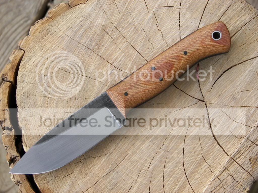

Does this knife look like it would work with a kydex sheath? I just finished making it today and want to buy some budget kydex tools to make one, but just wanted to check to see if you thought it would work first.
Hey mate, unfortunately no picture came through with your post...

Oops, my bad. THIS knife?
The front of the handle either needs and angle or to be rounded off before it would likely work nicely with Kydex, this is so the handle can slide into the sheath easily. That being said I'm sure people have made it work with squared off handles before...
Cool, thanks for the pointers. Just to clarify, you mean like this knife, right?
Yep! Exactly like that! The angle doesnt have to be quite that shallow, and it could be rounded instead, but you get the idea.
