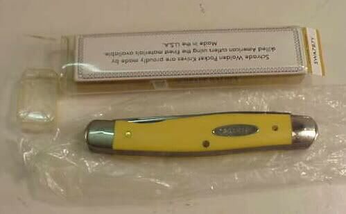

Cal, and aint that a fact!The tube with the paperwork containing the words.."Used under Licence from Taylor Cutlery,LLC. The Ellenville N.Y. factory closed in 2004.Production of these knives was moved to Camillus,New York"..........never gets shown and indeed always seems to get lost when a post 2004 'Reproduction Knife' is being onsold........as genuine. We actually have laws in Australia regarding 'Truth in Advertising' which tends to curb this sort of stuff as there is some recourse.........my old Infantry Dad always had a saying 'Time spent in reconnaisance son is never wasted'.....Hoo Roo

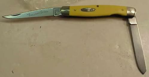

Camillus made 787 post 2004

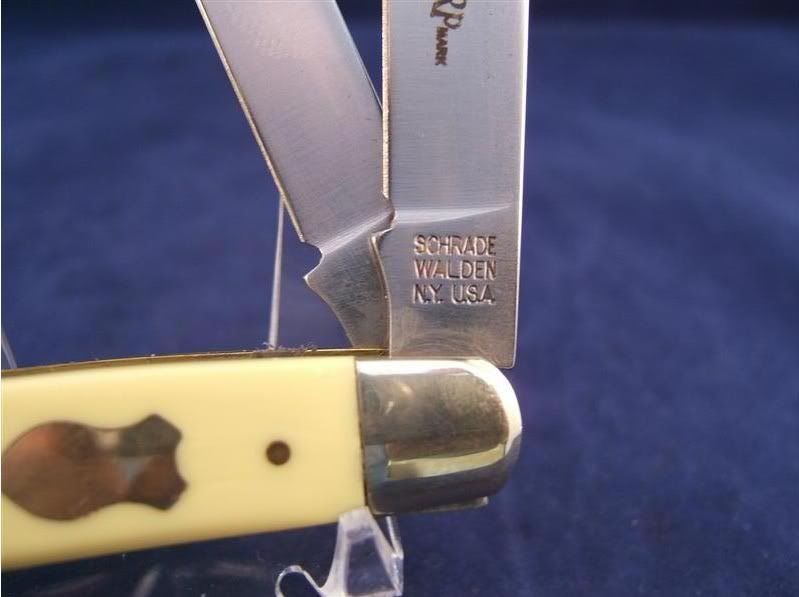

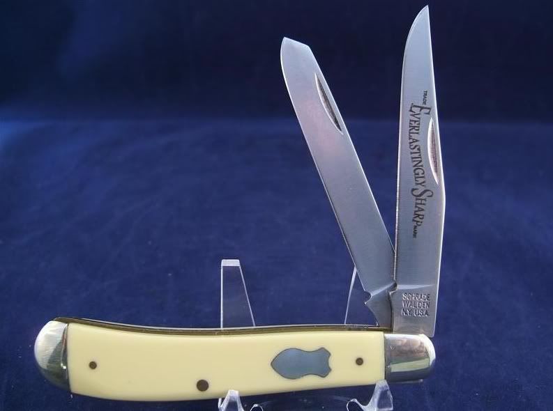

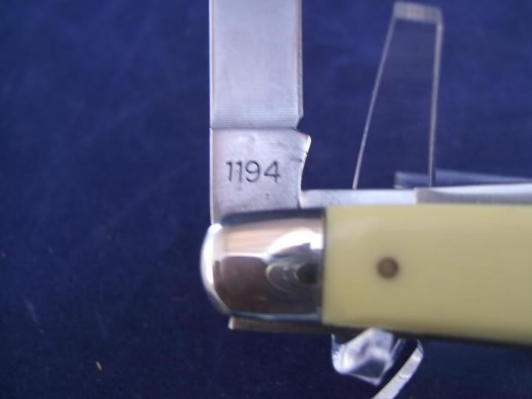

MINT VINTAGE SCHRADE WALDEN N.Y. USA 1194 POCKET KNIFE
Here is a very rare new mint condition vintage pre 1973 Schrade Walden N.Y. USA manufactured 1194 double blade Trapper folding pocket knife with felt pouch. The carbon steel blade is embossed with "Everlasingly Sharp". Blades are factory sharpened only, no signs of use, very quick snap, factory bright steel and all lock up tight (no wobble) when fully opened. The yellow smooth delrin handles have no splits and are unmarked with no sign of carry. The nickel silver bolsters and shield are also in perfect unmarked condition. Blades measure 3 1/8" each in length while folded measures 4" in length. This knife comes with a felt pouch which has protected this very fine knife for many years as part of a collection of fine vintage knives.
Bolster pins. Camillus did not use the Swinden patent keyhole bolsters.
And non valid Schrade Walden pattern numbers. Be very cautions of any new looking knives with the Everlastingly Sharp Etch on the master blade. It is a 293Y trapper and they never bladed a 787 like that.

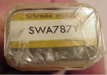

Hal, regarding the 2 patterns shown above, "787" and "1194", do you have original S-W tubes for these patterns which you could post pics of the tube ends for comparison ?
roland
I do, but Schrade did not make a yellow muskrat like that anyway with those blades or numbers. Other than that, the flaps look good. None the Taylor numbers match the old Walden numbers.
