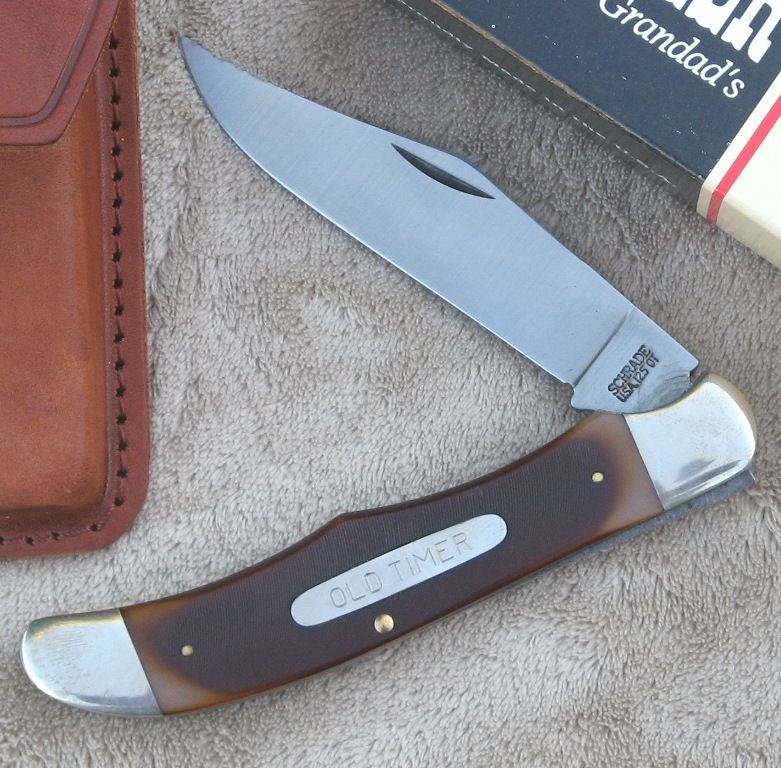

It's my father's 60th birthday in August and I'm on the hunt to get him a Schrade Old Timer 125OT Mustang knife, but I'm nervous about getting ripped off with a Chinese knock off (post 2004) knife with inferior steel. There are many currently on ebay but I'm just not sure what I need to look for. Any ideas? Looks like many of you are pretty smart about these knives.
My dad had this knife back when I was a kid in the 80's but he lost it on a camping trip one Summer. He was pretty upset about it and I thought that getting another one for him would be a great idea. I was fascinated by the knife as a little boy!
Any help will surely be appreciated!
Hi from Australia, There is a Schrade 125OT for sale on A.A.P.N. at a members shop and it looks quite OK (not perfect)
Just look at all the Schrade knives for sale there - That one is a little over $100. - There is also a nice 124UH same knife with diferent handles.
http://www.allaboutpocketknives.com/aapk_stores/index.php?category=7
There is also one on eBay for "Buy it Now $145"
I would think that is about the price you will pay for the best knife around (as new in a brown box paperwork ect ect) # 290705556168 .
I would ask the seller if that was the best price he could do for that knife...NOT everyone is looking for that knife, at that price! ... Ken
Make sure it has SCHRADE U.S.A. 125OT on the stamp. As far as I know, this is the only stamp they used on the 125OT.
Also Ken, the 124UH is a bit different pattern, with a shorter length, stainless steel blade, and no linerlock.
