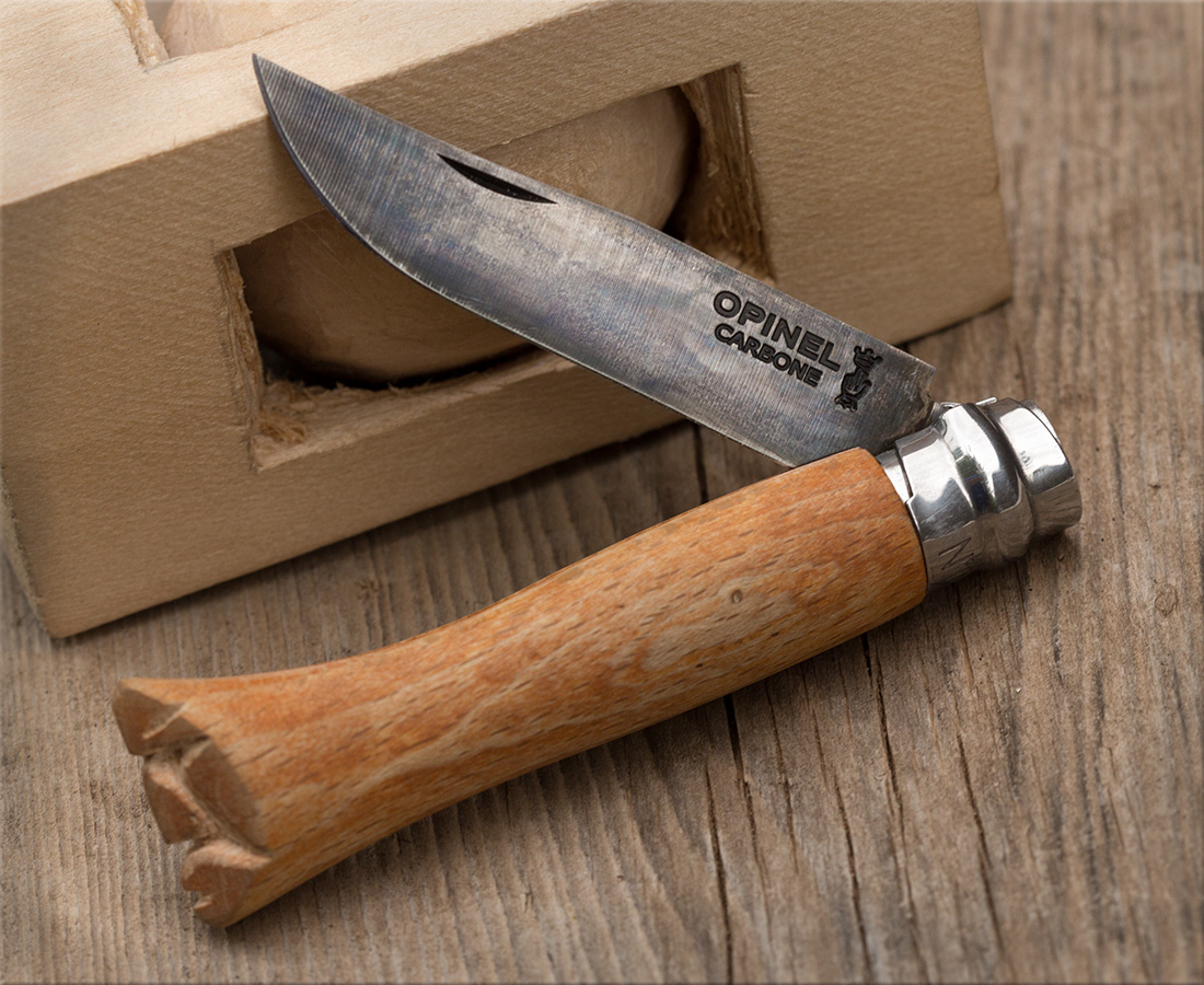

Had to see what the fuss is about so ordered a couple of #6s (smallest size that locks). Sanded off the varnish, carved Opie's face on the end, blue wonder patina, and after a few minutes on the wicked edge / strop it's wicked sharp. Pretty cool little knife for the money. :thumbup:

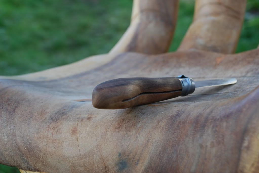

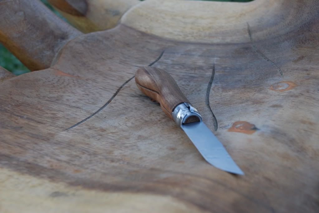

I did some checkering on this walnut op8 that my friend Sam sent me (finger side only). I had been thinking of doing more, better and more refined now that I have a feel for it. The big difference is I made flats to do the checkering. On the contours I bet it would be a great challenge? Good luck!

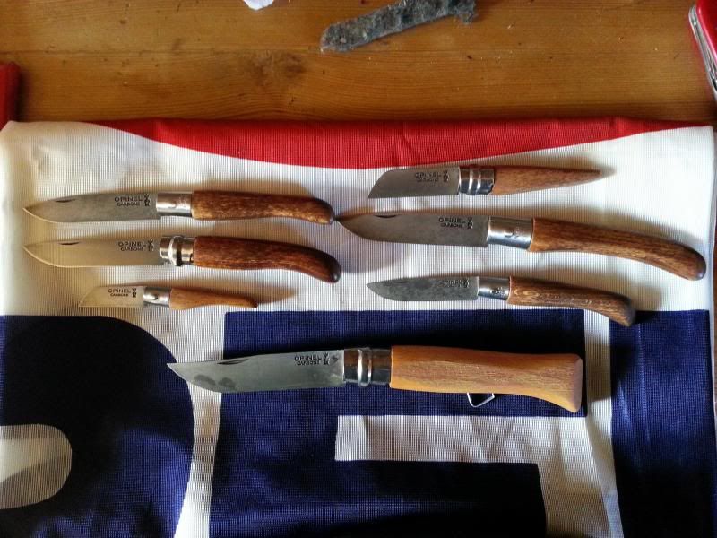

Here are some of my modded Opi's.
Nothing fancy, just modified to make them more functional to me.
The two sheepfoot are a nr 6(top) and a nr 4(bottom)
The big machete at the bottom is a number 9 which I'm currently working on to make it in a number 6 size sheepfoot.

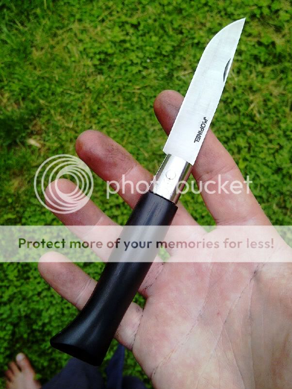

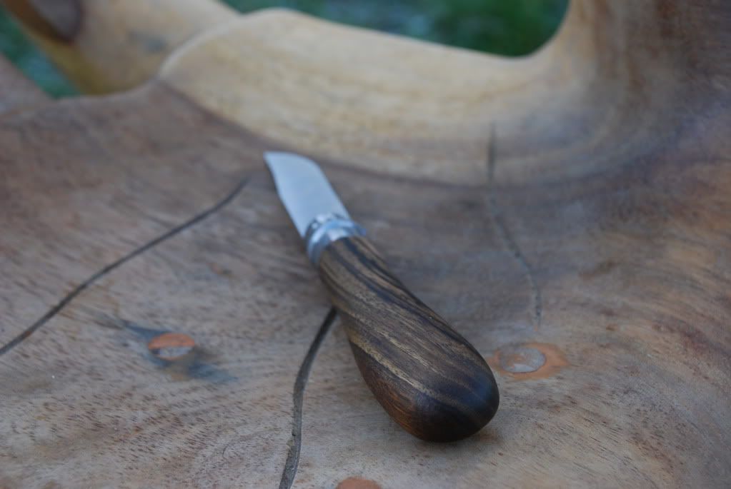

I thought some of you modders may appreciate my finished ebony "1890" as I like to call it :)
This knife came with a mirror polished stainless blade which got REALLY sharp and has PERFECT grinds, but I just did not want to deal with the glare at work all day and the way they mirror polished it would have been hard to take to a satin finish. The buffer lifted out the nail nick and logo so it would have been more metal removal than it was worth.
So, I tried my first blade swap on an opinel. The ebony is finished by hand with crocus cloth and then buffed with Tripoli wood compound. I made the clip into a drop point and filed away the blade "kick" out to an angle for Three reasons. One to give more room for my index finger, two for making it easier to sharpen and three to accommodate my blade stop mod. After peening I used a swiss pattern knife style file to work the pin. I filed the back square and collar slightly to even it up and open to where I wanted. Finally I gave the collar a hand finished crocus cloth treatment which was tricky. No buffing, just by hand.
Here is the end result in hand:
Next is to show how I make my blade stop. I use stag and I make one angle to match the angle I grind into the blade
(this angle)
If you look in you can see the front angle that matches. Then you can see the flat angle that the tang actually sits on. You can see two faint black lines where it sits:
On this ebony knife I was much more precise and I have the blade raised only 1mm above the wood in the handle.
This will be going to work with me and seeing lots of use. I hope it picks up lots of character.

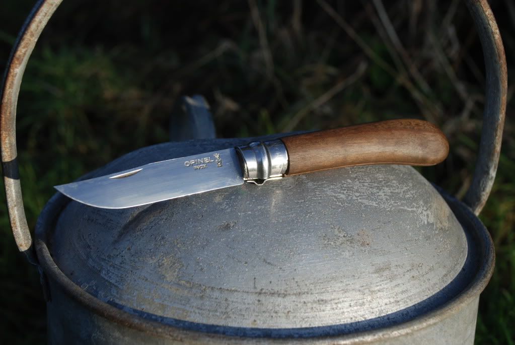

After reading this thread this morning I put my No. 8 carbon in my pocket. I love it as a picnic/camp knife, but I find it a little big for EDC. So...through the power of the internet I tracked down a local general store in my neighborhood that happens to carry Opinels. After a quick trip, I came home with a stainless No. 6 in walnut that fits in my pocket oh so sweet. I have a feeling it will be there for awhile. Thanks for the motivation!
