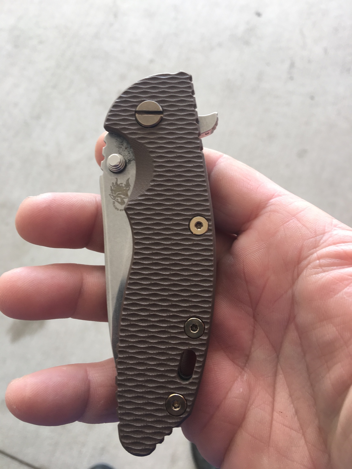

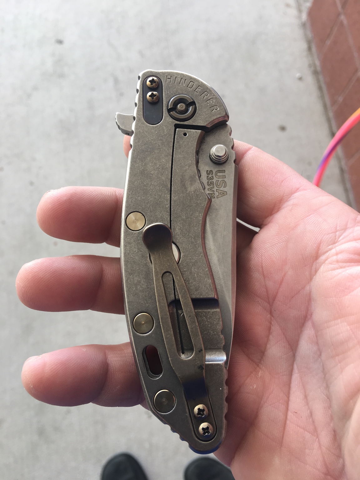

Guess what I'm doing tonight while the wife's at work?!?! Do you guys rotate the hardware while it's on the heat or anything?
Sent from my SAMSUNG-SM-G930A using Tapatalk
I didn't. A little advice, Make sure the whole cooktop is extremely clean. When I did my stop pin it rolled across the glass top and bumped into a crumb when I attempted to pick it up. Now there is a black spot where the crumb burnt on contact, I had to install the pin so it wasn't visible.
Ok good advice. How long we talking like minutes or seconds on the heat?

From what I gather, the difference in time just depends on the shade of bronze you want. Also in case you didn't see the previous page of posts, dropping the stuff into a cup of ammonia (Windex, Glass Plus, Parson's) afterwards - cools it and makes the bronze shade richer.
Ok great thanks
I just tried it out today. Worked great. Thank you for the tips on doing this.
Np bud, and yea i set em and just watch...you don't wanna go to far as it turns blackish blueish...and unlike ti you can't go back an redo it by sanding it off..
Well you can but it won't be as dark a bronze the second time.
The stand offs also turn bronze alot faster than the nuts screws and pivot for some reason
Sent from my SM-G935V using Tapatalk
The first time I did a clip screw because if i screwed it up it was easily replaced. I picked it up after a minute(with needle nose pliers) then every 30 seconds till I liked the color. I'd advise everyone to go through their own trial and error process and find the sweet spot of their stove.
