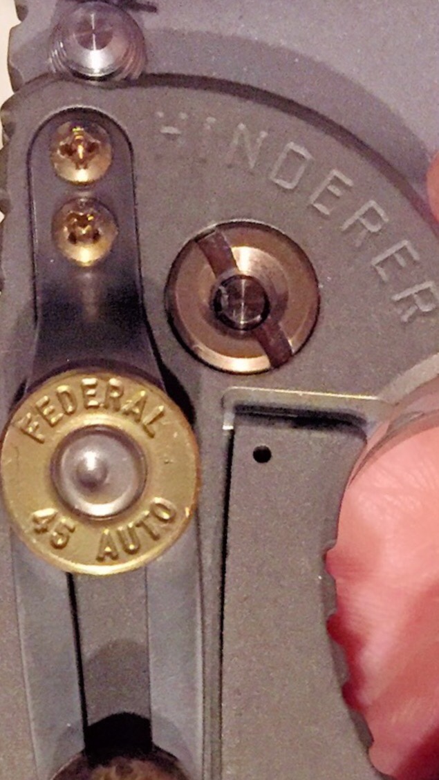

I haven't had any luck finding black hardware for my 18's.
I've been thinking of sending some (plain) hardware to Pop's Custom Clips to have them powder coated black; he does black powder coating of his custom clips and I'm certain he'd coat some hardware for a reasonable fee.
Powder coating is not like anodizing.
It will change the way the threading on the hardware goes together, if at all.
You are changing the tolerances of very fine threads.

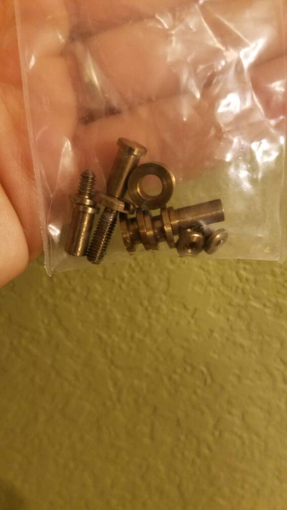

A baggy of homemade bronze hardware outta factory hardware...can't tell difference between them and the ti bronze....once my bronze crusader gets here they'll go on.

Those are stainless? Mind sharing your method?

Heat ano, if you have an electronic stove turn it on high, once hot set a few pieces on it...watch it closely and in a min or 2 they'll turn bronze... best way for an even finish....can also use a torch but can be less consistent...then once they reached the shade bronze i wanted i take em off and drop em in windex.

My method is the same except 3 1/2 minutes(my stove has a glass top with heat elements under glass) and I don't do the windex. What does the winded do for yours? Whatever it does is probably from the ammonia?
When i drop in the windex it turns a shade darker than When it came off the stove...mine has glass over it as well but gets insanely hot

Interesting! You just opened up a whole new world of custom for me. I didn't know it was that simple to do at home. Thanks for sharing, guys. I believe, if I remember correctly, the ammonia causes a small chemical reaction that releases nitrogen, resulting in the color change. If anyone cares about the chemistry. Also cools it on contact, as Bobby said above. Stronger ammonia will give a "stonger" richer bronze.

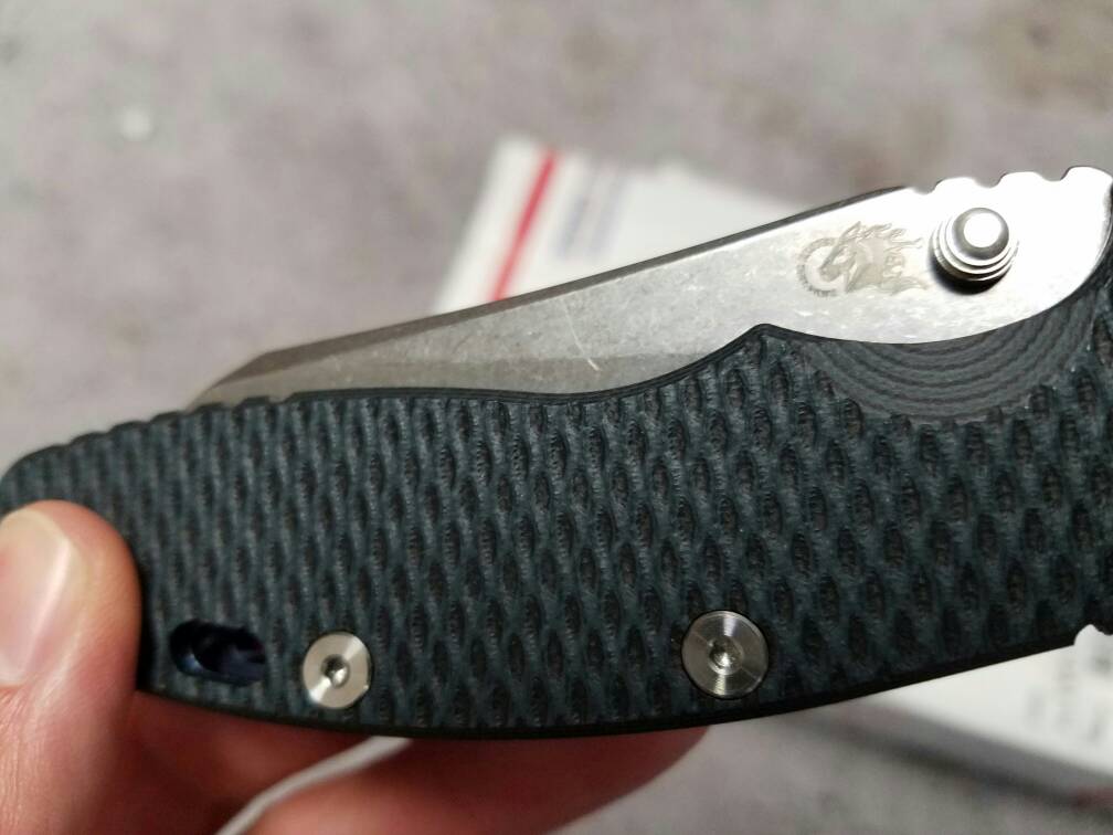

Nice fat scratch on my fatty straight from the dealer. As much as i want to like the wharncliffe blade style and after playing with it for a while, I never had that "bonding" moment that I've had with all my other hinderers so unfortunately this one's going back.
