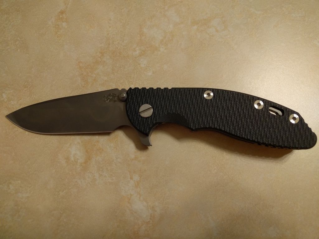

So is the little bit of wiggle in the blade when closed is normal? Also if I'm not 100% satisfied should i still keep it anyhow since it would still be rare...I can't possibly think there would be a ton of these made...it's the sig Sauer legion edition by the way
Did you buy this new or used?
Bought it new straight from sig Sauer .com ...only purple that have the legion pistol can buy one...only only problem I see with this knife is the detent...the ball is only going in like 10%...but the hole is big enough for the entire ball to go down into it.
If the detente was stronger it would flip better and stay in place better when closed. I don't like the feeling of being able to whip the blade out with just a flip of the wrist like in the video I posted
I have the Legion pistol. What do they need for verification to sell that knife to me on sigsauer.com? As far as the detente, you might have to do some kind of custom shaving of the detente ball - or replace it - for it to seat properly in the hole. These Hinderers are notorious for detente and other issues when you get them new. If you look back at some of the pages in this thread, you might find what you need in order to fix it. A lot of us have had similar issues that we worked out thanks to a few of the guys contributing to this thread. Blade play is definitely not normal...don't settle for that.

You have to register the pistol on their site...then they give you access to buy "special"legion products that only legion members can buy...I bought mine last week on sale for$400. So should I just keep this for the uniqueness or just return it?
There is no blade play side to side. There is just some looseness sitting in the detente when i pull on the blade lightly...but again the only reason why it's like that is because the ball is only in there 5 or 10%.
If your comfortable doing this. Take it apart with the proper tools (protect the pivot screw slot with tape on what ever tool you use as the black coating will scratch off easily) and increases the pressure on the lock arm.
well that wont work as i tried pushing in the lock arm with the blade closed and it will not go in any further...but this offset was done on purpose obviously otherwise if the ball went in completely then the lock arm would be touching the blade which I definitely dont want. All I want is the ball to go in about 35% so the blade will be a little more stabilized when closed.
It will work. It doesn't necessarily have to go in further, just needs more pressure on it. Done it at least a dozen times.
