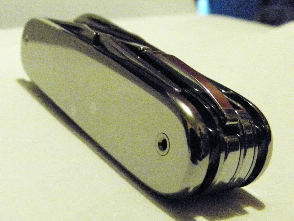

Vic Spirit

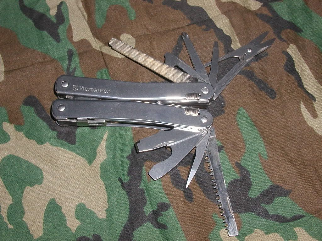

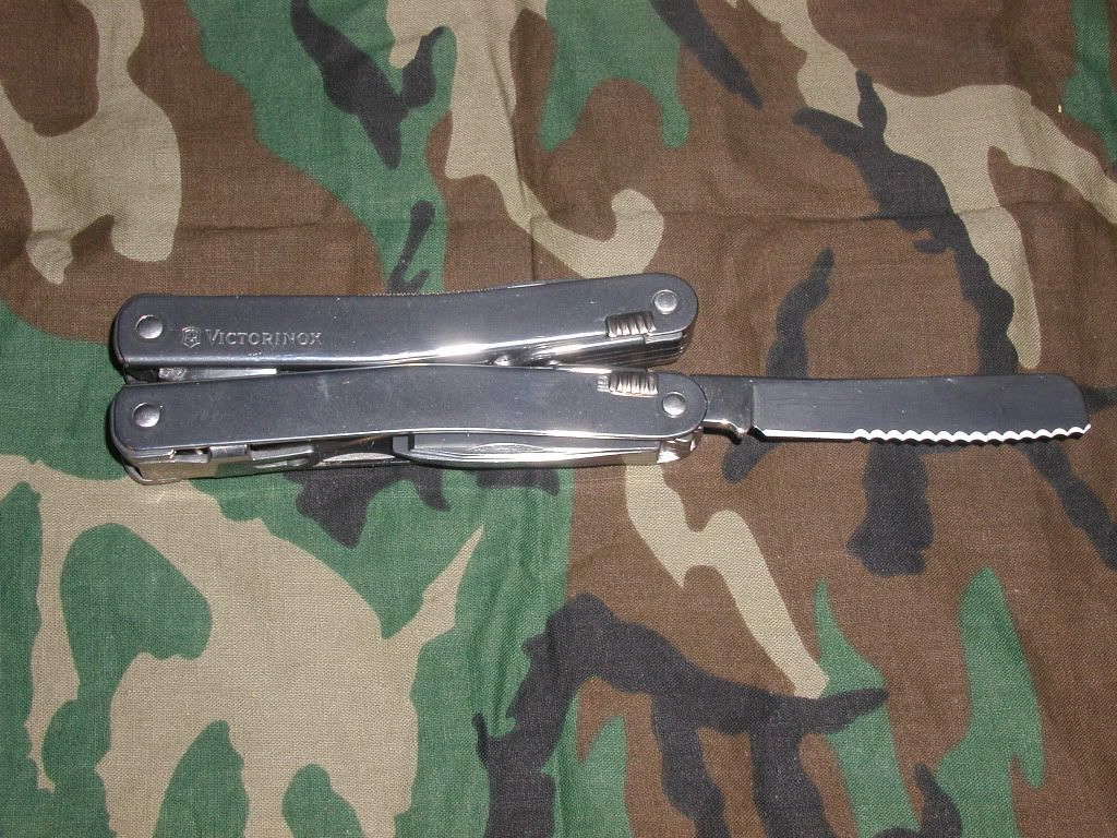

Guidesman multitool

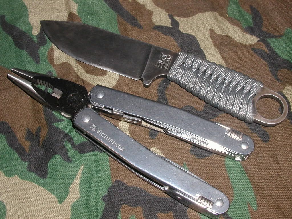

Squirt E4
County Comm driver tool

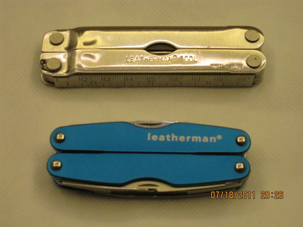

Mini keychain plier tool

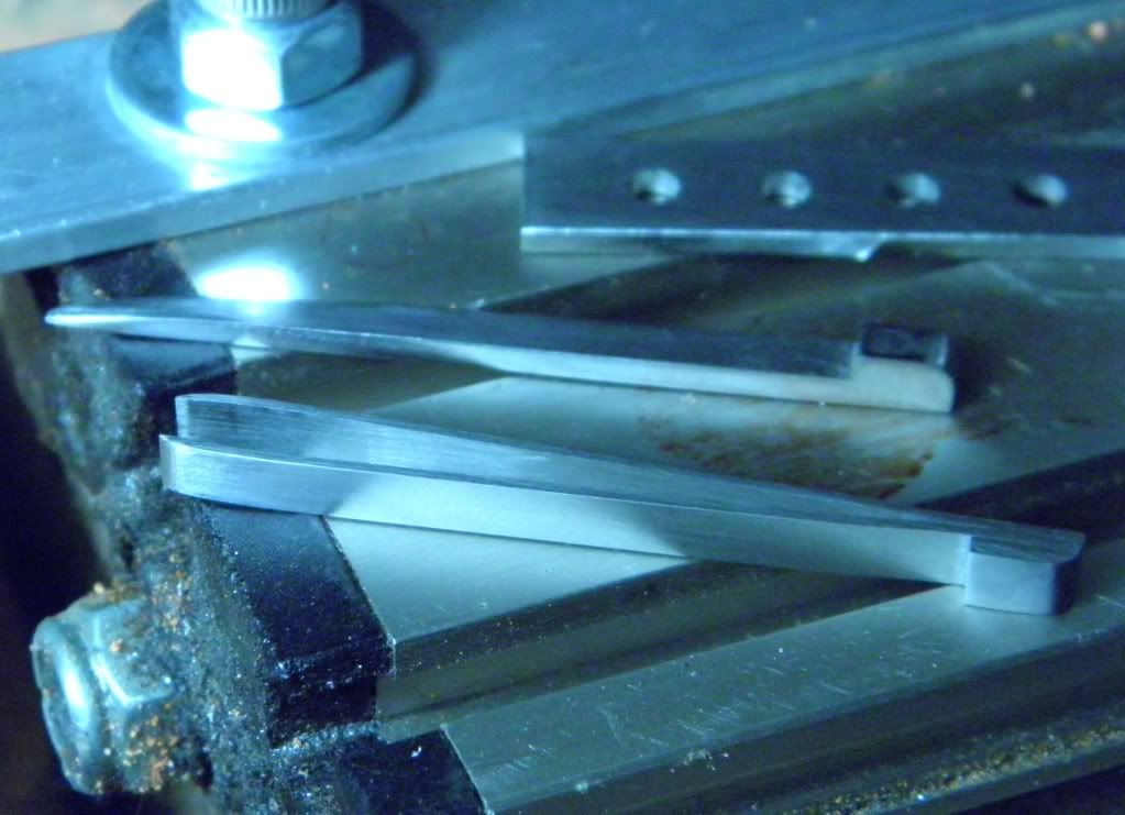

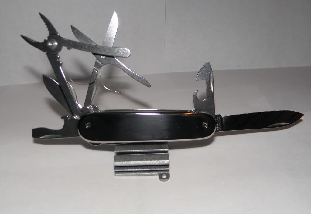

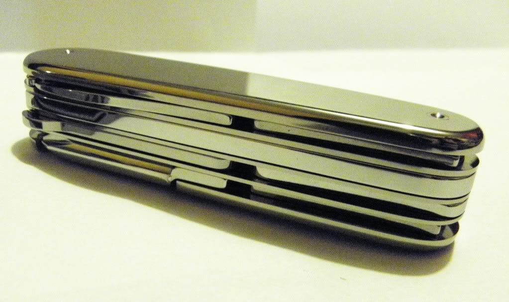

Well, since there's so many SAKs in this thread here's a delux tinker I just finished with 6al4v titanium liners and scales and titanium hollow pins. I still want to make a bail for it and get the shield etched on.
Yep. I didn't do the tools of course. Those are from a Vic deluxe tinker but I made the scales and liners using the original aluminum liners as templates. I used a pre '07 thicker main blade with the crossbow stamp and drilled and honed all the tool pivot holes out for 1/8" pins and installed 32 handmade .005" phosphor bronze washers to keep the tools from riding on the liners. Once I got all the Flitz flushed out with brake cleaner and oiled her up she worked perfectly. I'm no knifemaker but I've been a machinist and jeweler for years so I figured it out.
I looked at your videos and saw that you're a fellow orange-o-phile. I have something else in the works that you may like. Orange G10 SAK Super Tinker with titanium liners and 1/8" stainless pivots. Oh, and titanium tweezers and toothpick.
