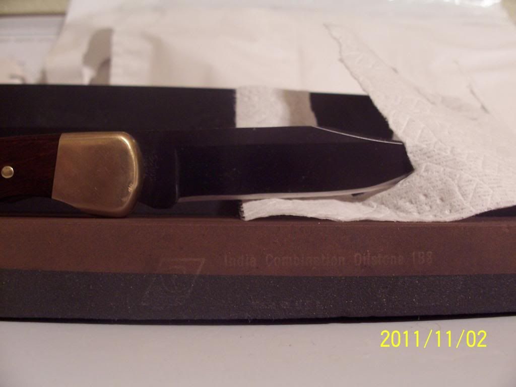

Here is a photo of a Norton IB8 stone with the bear emblem on it. This stone is a mid 80's combination coarse / fine India bench stone. Hence, IB8= India Bench 8. When Norton's mfg. went outside the USA the bear emblem was dropped. Sometime around the late 90's. DM

A man made stone will cut most any steel much faster than a natural stone. As their hardness are much higher. Not just this but their grits and binders are different. A Arkansas stone has a grain like a cobblestone street. Whereas the India and SiC stones grains have points like grains of sand. This enhances cutting. The India being ceramic and it's grains don't slough off during grinding like SiC. Which is considered a water stone. The SiC grains during grinding will slough off creating new material but wears away more quickly than a India. The India is a good stone and high enough level of grit to take a blade. Give it some stropping on slurry and you'll have a very sharp edge with good bite and retention. DM
Give 'the blade' some stropping on a leather strop with slurry applied, in order to clean it up, remove the burr and refine it further. Coming off this stone; this makes for a very sharp blade. DM

Purchase a slurry in 300-400 grit range from Home Depot and outlets you'll find on this forum. Ace Hardware stores even carries some. Google Flex-cut Gold. Apply this to your leather strop using a carrier of mineral oil. Rub it in and your ready to use it after grinding it (the blade) on your India stone. DM
