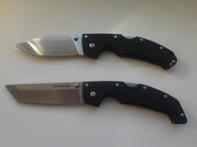

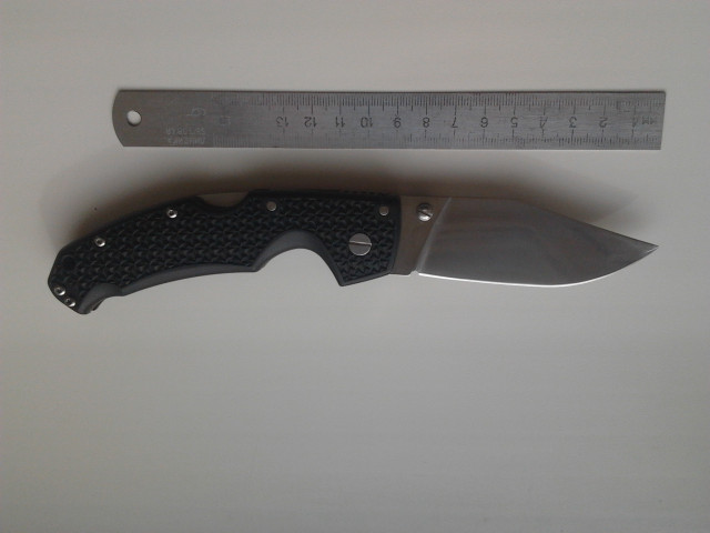

Funny thing - there is just a minor grinding job to make from 4in. Voyager an 3,5in. model. I don't know why Cold Steel ignores such a handy size in one of the best constructed (IMHO) knives.

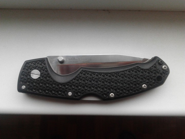

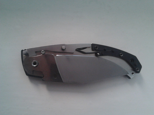

Pivot from cut-off part of the handle was installed in vacant clip hole (aluminum liners were drilled up to 4mm to accommodate pivot), to preserve the maximum rigidness of handle.
insta9ves

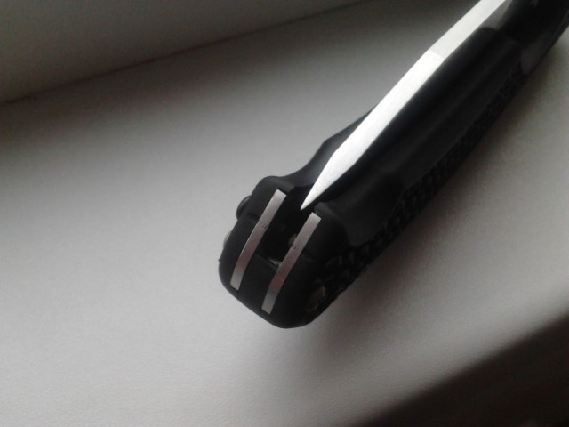

Such a blade shape on tanto was a necessity, if I didn't grind the spine - tip of the blade would stick out from the handle when closed.
Now tip lays securely in handle (on both) and don't snag out even when I imitate unintentional hooking by clothes when knife reach out from pocket.
