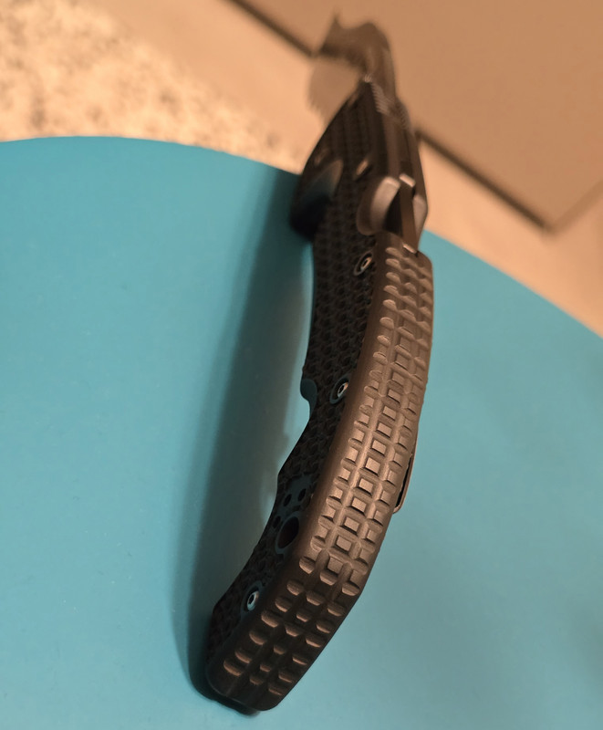

I put a Snaggle Tooth on my Counterpoint XL and it works well. I can't open it one handed otherwise, even with large hands. Its a great product!

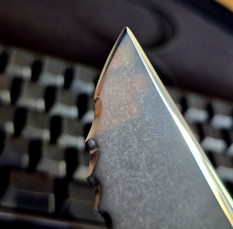

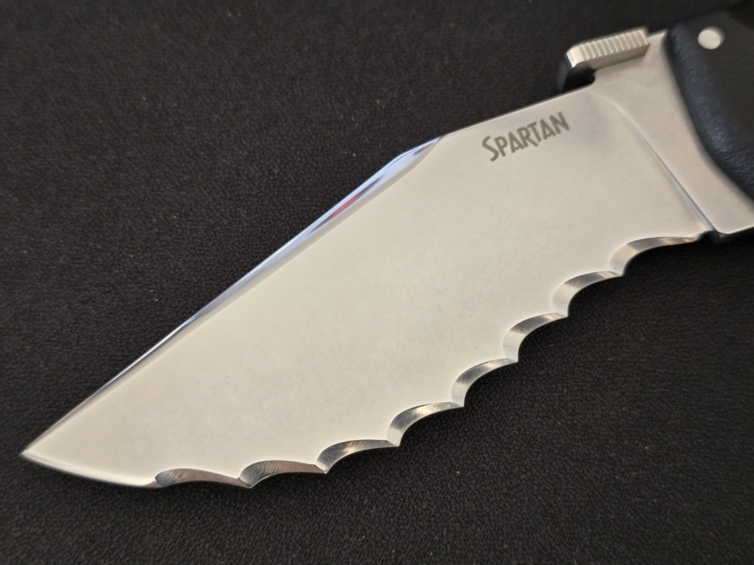

Plain edge Spartan with Veff Serrations installed.
I thinned out the swedge a fair bit, leaving the last inch or so (the bit enclosed in the handle) sharpened to a proper convex edge, specular to the last bit of the main edge.
Then finally I mirror polished the whole thing. It's now possible to do back cuts like on a traditional Bowie, and penetration is vastly improved without too big of a compromise in tip toughness, I think.
This knife was donated by the user Centermass and it's very dear to me - I'll never thank him enough for it. It rides in my car next to my seat every day because I think it's a hair too heavy for edc on most days, but nonetheless especially after the mods it's a really complete package and as a bonus cuts and looks awesome doing so. I know that if push came to shove I cold really trust my life with it.
I'll try to post a complete review on it soon because it really deserves one.

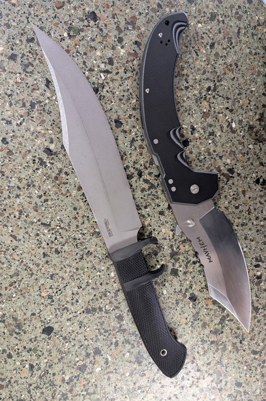

Here's two of my modded Cold Steels I have close at hand. The Mayhem just sports a Snaggletooth, which is a really nice addition on a knife I really only carry if I want something that can handle unlikely SD capabilities.
The Marauder is a fully serrated version that I have cut off the rear guard. To be honest, I don't like the subhilt for a chopper, and my snap cut technique balances just a bit differently in my hand due to my decades of khukuri use. Instead, I have found that I prefer a lightweight self defense style blade like this one (thus the fully serrated edge) to be gripped in more of a sabre style hold and controlled with my thumb so that it cuts and can be used for angled thrusts. It also lends itself to a tip down icepick hold if drawn so that the little finger rests in the subhilt area. The lack of a rear guard allows the knife to come up fully flat against my forearm without anything banging into it.
