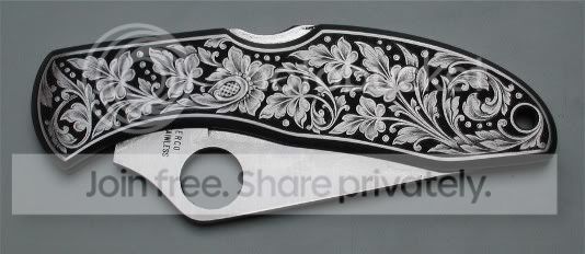

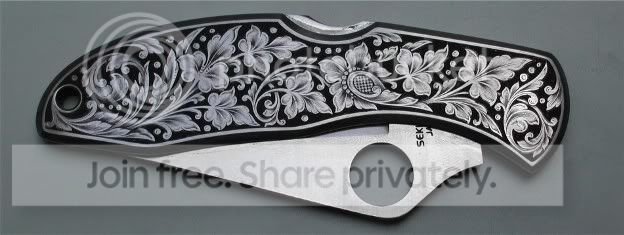

This is one I did for The Deacon. Removed clip, blanked the holes with Stainless pins and engraved bothe sides.

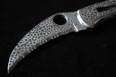

The old Harpy that was too mangled to save, and Jestyr here gave me the idea with his design. This one was done years ago:

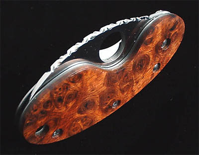

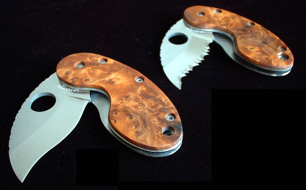

Then of course the Crickets. Gosh I love those things:

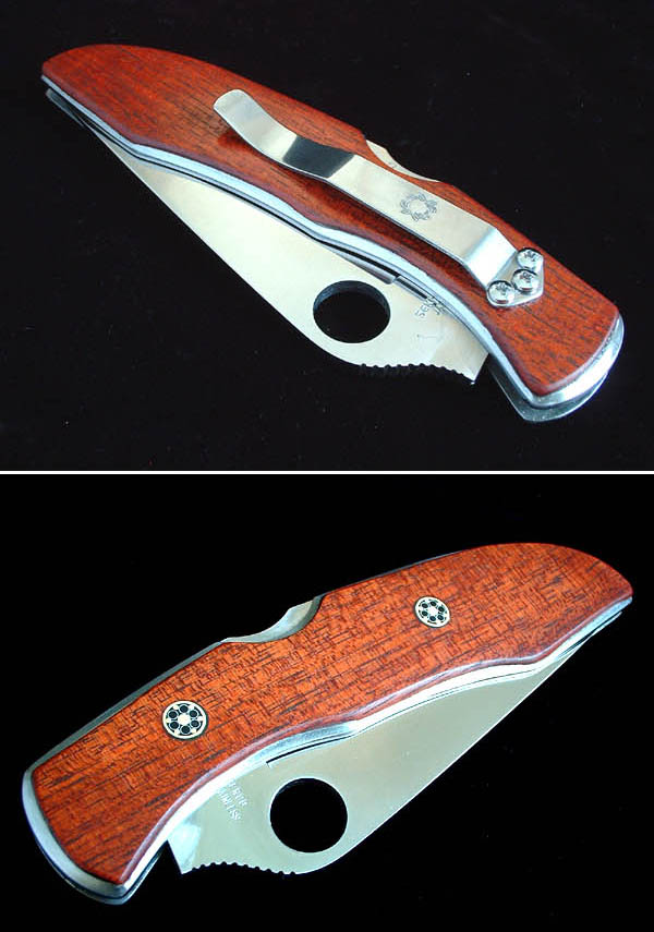

Nice Endura II with bloodwood scales and handmade mosaic pins:

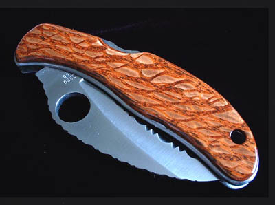

Another Harpy with lacewood:

Vess or Jestyr, what dremel bit did you utilize for your "lightning engraving"?
thanks for any reply
I used a diamond coated needle-shaped bit in a regular handheld dremel tool. It's even easier if you have a flex-shaft attachment, but I did mine without it, having it just allows for much more control. The diamond coated bits cut much easier on the blade, which is why I used it, and don't tend to "run" around the surface. The whole Harpy took less than 40 minutes with no planning whatsoever.
Vess, that Endura is amazing! Are the scales inlayed or onlayed over an existing SS handle, or are they entirely new handle scales?
Great work on all of them, but that Endura just does something for me... it's so simple and elegant.
Just scales on the original handle, though I think I drilled little depressions on the front side of the handle for the mosaic pins to sink into. Can't be sure though, it's been a while.
And yes, the serrated blade with filework on top looks decidedly carnivorous. It was really disturbing on the Harpy: teeth along the blade, and smaller teeth along the spine.
I got one of Vess' customized Crickets. The Aboyna Burl scale on it is quite attractive, and the polishing that he did on the blade over the filework really sets that off as well.

Did you do the jimping on the back of the Endura's blade? If so, how did you do it?
