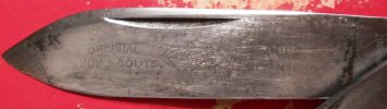

Remarkable mend! I can't see it even in the closeup.
Thank you! I appreciate that.
Holy cow!!!! That's amazing. I'd never even know it was repaired. What did you end up using for the repair?
Thank you!
I got some JB weld epoxy at the hardware store and some powder on amazon called ez tint in brown and black. I mixed the powders going a little heavy on the black figuring it wouldn’t stand out as much being too dark rather than too light. Mixed it an filled the handle crack with painters tape to hold it after it set and cured while I was at work I carved away the excess around the pin and sort of whittled the rest with a small pen blade to look as much like the jigging as I could manage.

Really well done. You can totally hang your hat on that one. Thanks for letting us know how you did it. I'm betting I'll be using that technique in the future.

jddistin- I like that repair- I do the same when working with Wood- not that I do a lot of that- but with Old Houses- I use a lot of two pack epoxy resin plus the Wood Powder from sanding = perfect.
