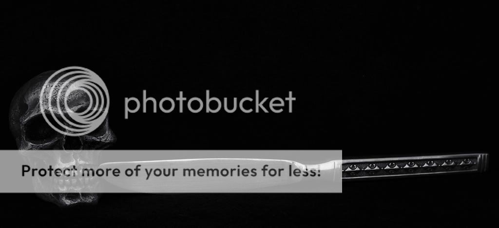

Lets see your sharpest knives.
Full convex zero edge:eek: Yeah, it's a butter knife:p And its not sharp:D
