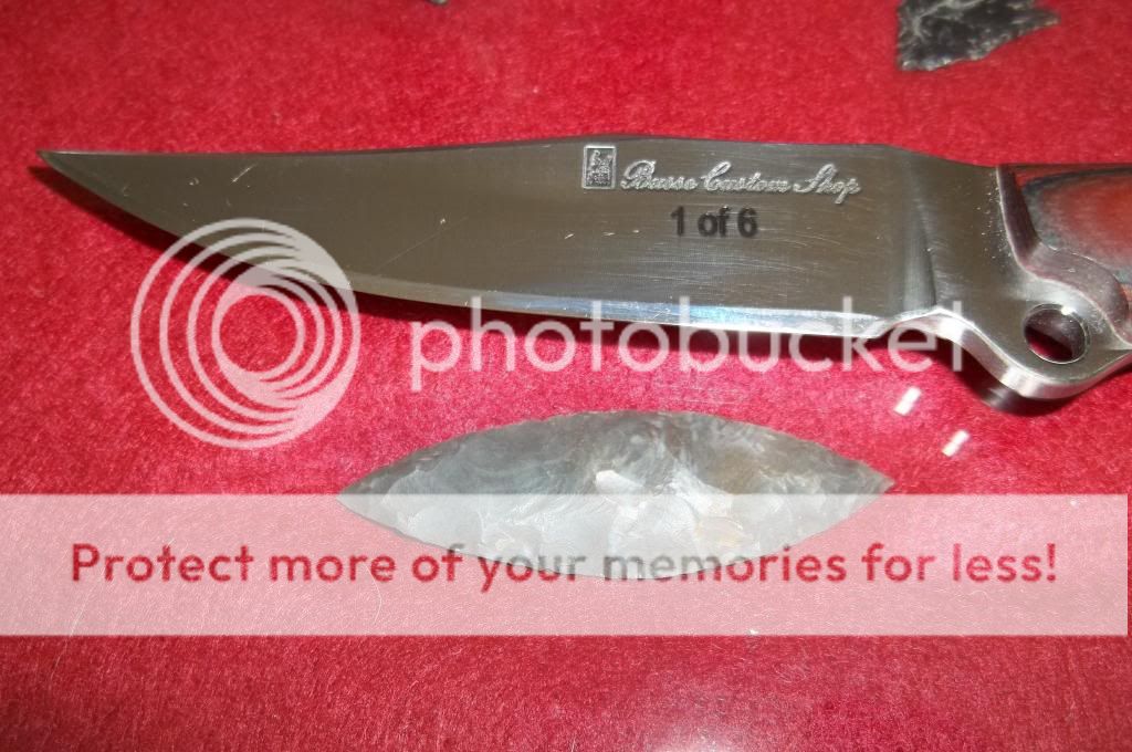

... same or similar shown before, but this is mine, thanks Jeremy.

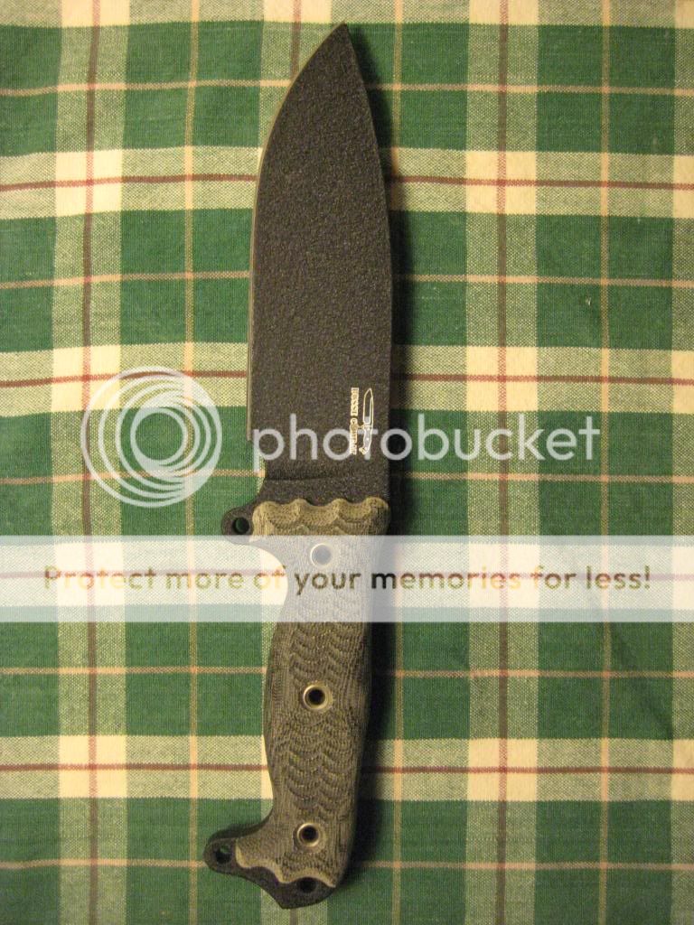

and a straight from the factory toothy steep, obtuse beveled Ash1CG. It would not push cut paper, and would only scrape a bit of arm hair off with pressure. Bit even as thick as that sucker was, and with the coating and all, it cut the meat with the least resistance and effort. Like the blade edge being toothy seemed to break the surface tension or something of the wet meat.
The one that made it the longest with out sharpening and still having the easiest time slicing was the ASH1CG with that toothy edge (even after the knuckle head I let use it kept making careless contact with the concrete table we were using-- he kept slicing through the meat and through the butcher paper to the concrete, and I would wince every time I heard and felt "Thunk" through the table).
The GW and the Modded SS with convex edges I had to strop once or twice to get them back to tip top slicing. (maybe this was because I did a lot of fat removal with both....????? I found, on dressing out a deer and skinning it that the fat seemed to dull and edge pretty fast, in comparison to actual meat slicing???)
The Ash1 went the whole 4 hours without any touch ups. It had multiple nicks and dings in the edge from the rough concrete, but was still making clean slices.
It should be noted that all the other knives we were using had to be sharpened 10+ times (I shuddered every time the other guy sharpened his knives with a pull through carbide v sharpener making nice metal shaving piles off his knife edges).
Cheese, Meat, and other soft food items slice easier for me with a toothier edge than with a full polish. Not that my convex edges won't slice up some nice meat for dinner, but on that 4 hour elk job, I did notice that the toothy factory edge held up the longest. It did not make as nice of fuzz sticks, or chop as well as convex edges.

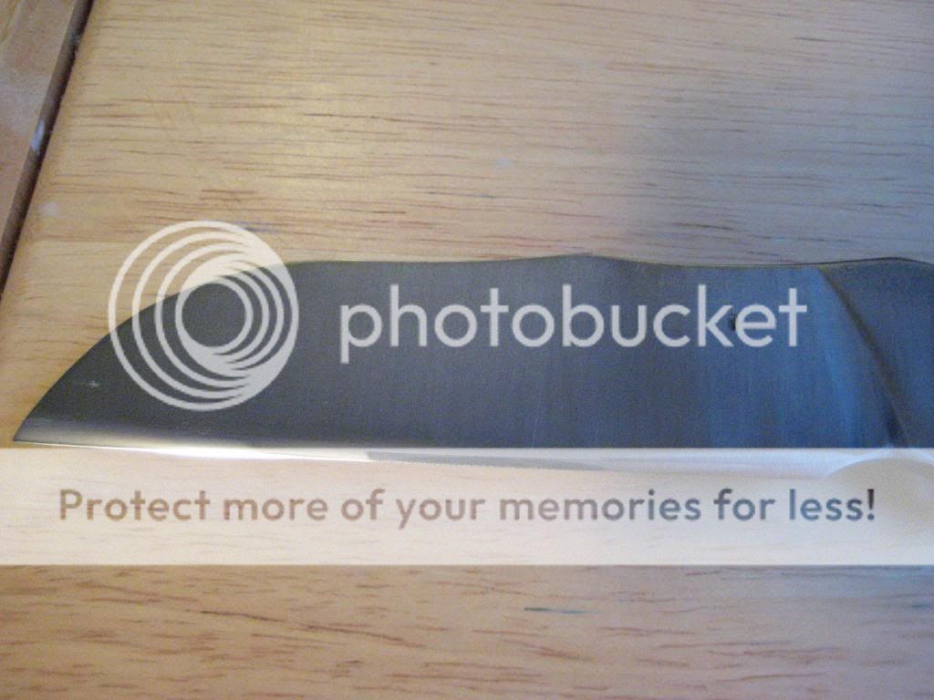

Not a Busse. It is my ghetto home made knife (my first ever completed knife, made it with files, and sand paper. No power tools. I even drilled the handles and tang holes with an old hand crank drill). My power drill crapped out. I did the heat treat in old synthetic racing oil from my dirt bike.
Sharpened it on a belt sander (first attempt). Went from a 120 grit (albeit a bit worn) straight to the loaded strop. The edge has become polished from stropping.
top knife.
It is also a thinner convex than any of my infi, and a thinner flat grind, along with the taller blade profile.
Steel is 5160, so edge retention is not as long as with INFI. But......
it slices meat no problem. To the bone with just a tiny bump.
