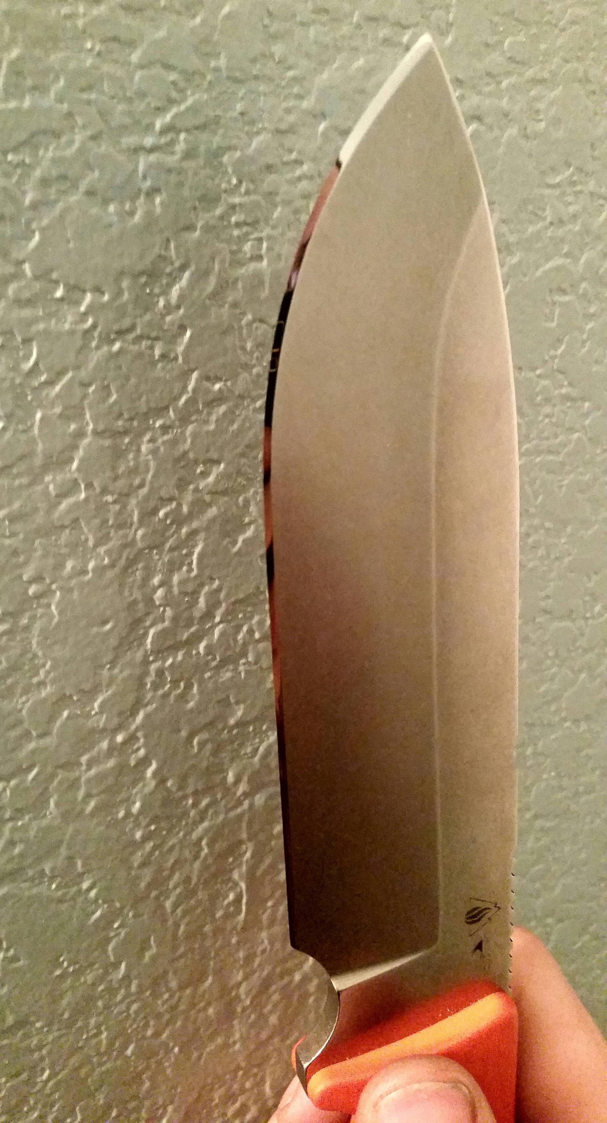

Love sharpening gso's.

sorta creeps me out when you stare at me from your knife blade. When I move side to side, your eye follows me...
LOL...just don't get too mesmerized and drop the blade, you'll need stitches or worse lose part of a digit!!
That 5.1 with the orange g-10 is my knife that you sharpened I believe. Got to use it for a lot of kitchen duty while up north last weekend and it slices really nice compared to my other similar sized knives.
Yup that one is yours, had a3.5, 4.1, and 10 come in last week. That 20cv shined up real nice.

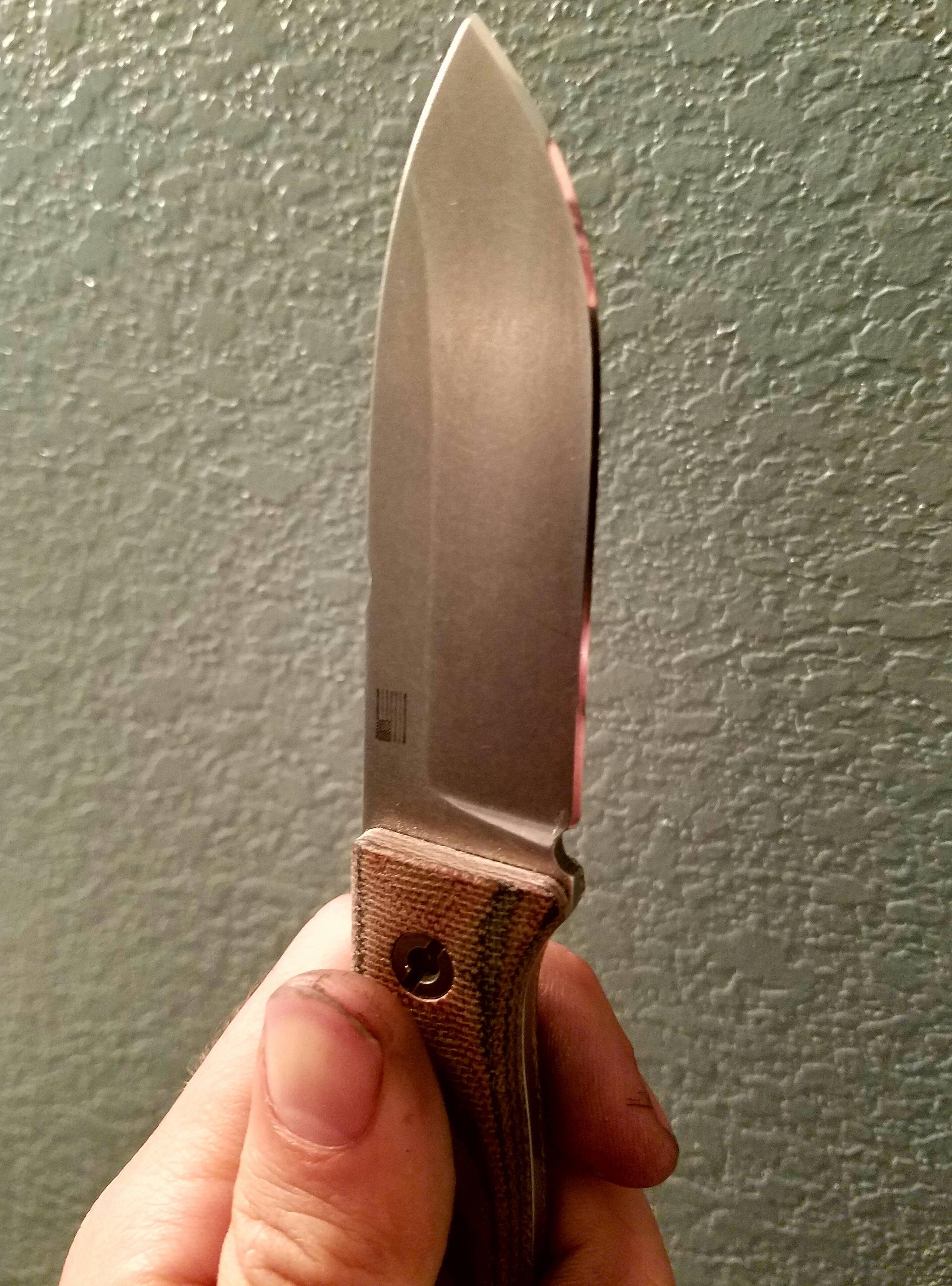

Newer spec gso's (old spec, but Newer production like with wide lanyard hole) are better slicers than that of the old. They're much thinner behind the edge.

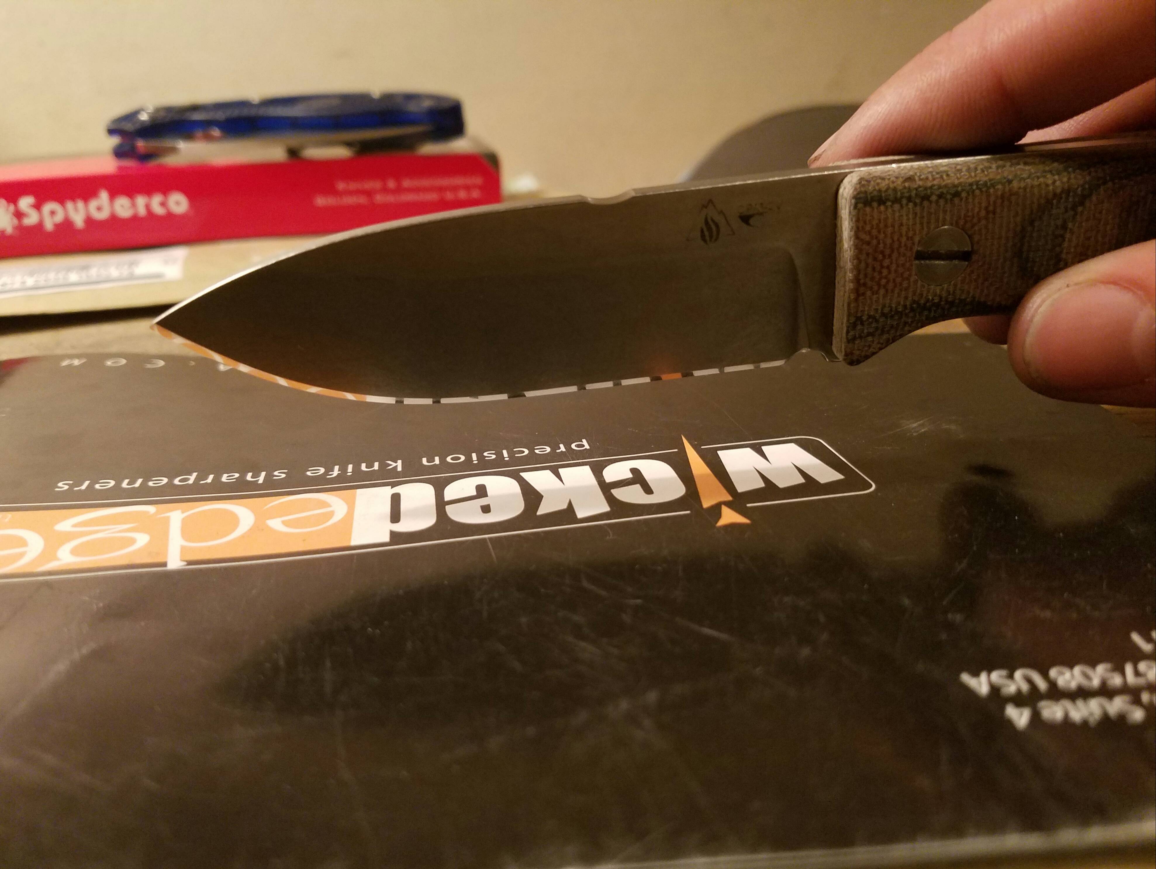

What are your thoughts on sharpening the 20CV vs the 3V Bobby? I've done lots of 3V, but I can only remember one M390, and it wasn't on my radar then to pay attention to it.
Yea it was easier to reprofile and polish by a small margin.

Reprofiling 20cv just goes by quicker than 3v slightly, and takes a polish easier.

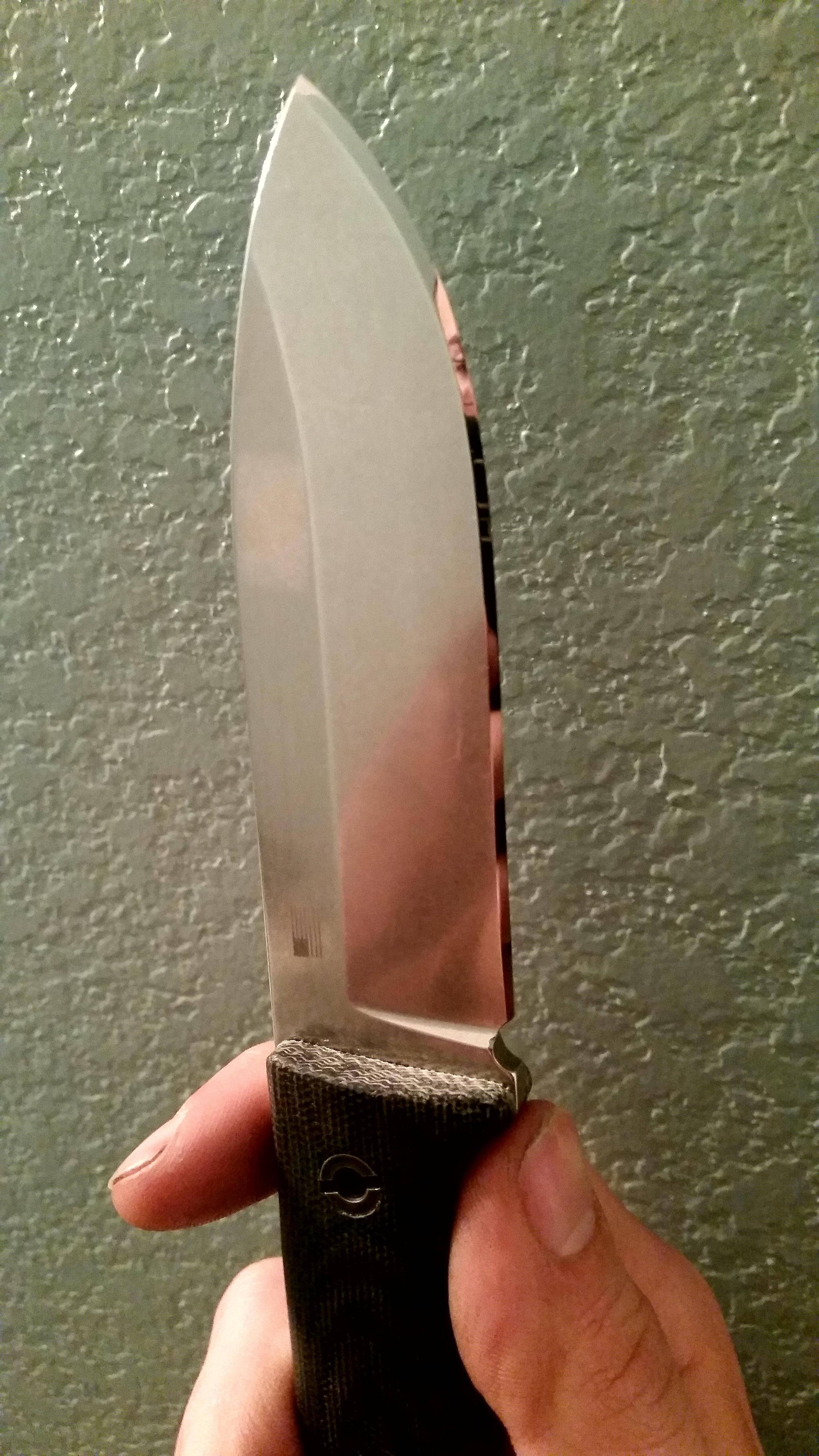

I don't know about the ease of sharpening them either, but I can tell you that right out of the box the F-2nd GSO 5.1 in 20CV was the sharpest as compared to any 3V and the CruForgeV was the least sharp. This is just an observation based on letting the blade cut photocopy and thing phone book paper. However, simple stropping of the 3Vs and the CFV steel using BRKT white compound on the Flexxx Strop paddle brought them all to almost par in terms of paper cutting test.

I can't really tell a difference in sharpeness at the levels i took em. I just know my time spent reprofiling was about 5-10 minutes faster than 3v, then to get it to a high Polish was easier than 3v.

I will say that the new Cru Forge V is a JOY to sharpen on a strop. It's similar to 01 and really polishes nicely. I can't wait to a CFV 5.1.
